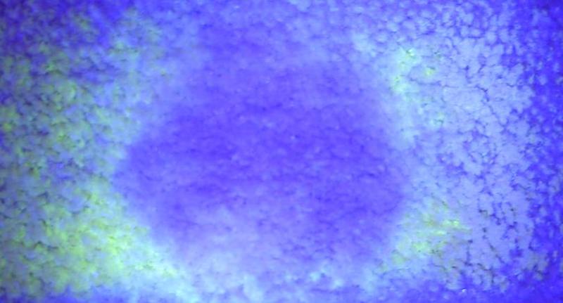

Mike;
It is possible to remove the UV component with better spot removal procedures:
This is a mustard spot with a strong green UV marking that was removed with our DC Powder Brightener AND a 9 Watt UV LED light.
The Dynachem Odor Attack had slightly better results on pet urine stains.
Larry
