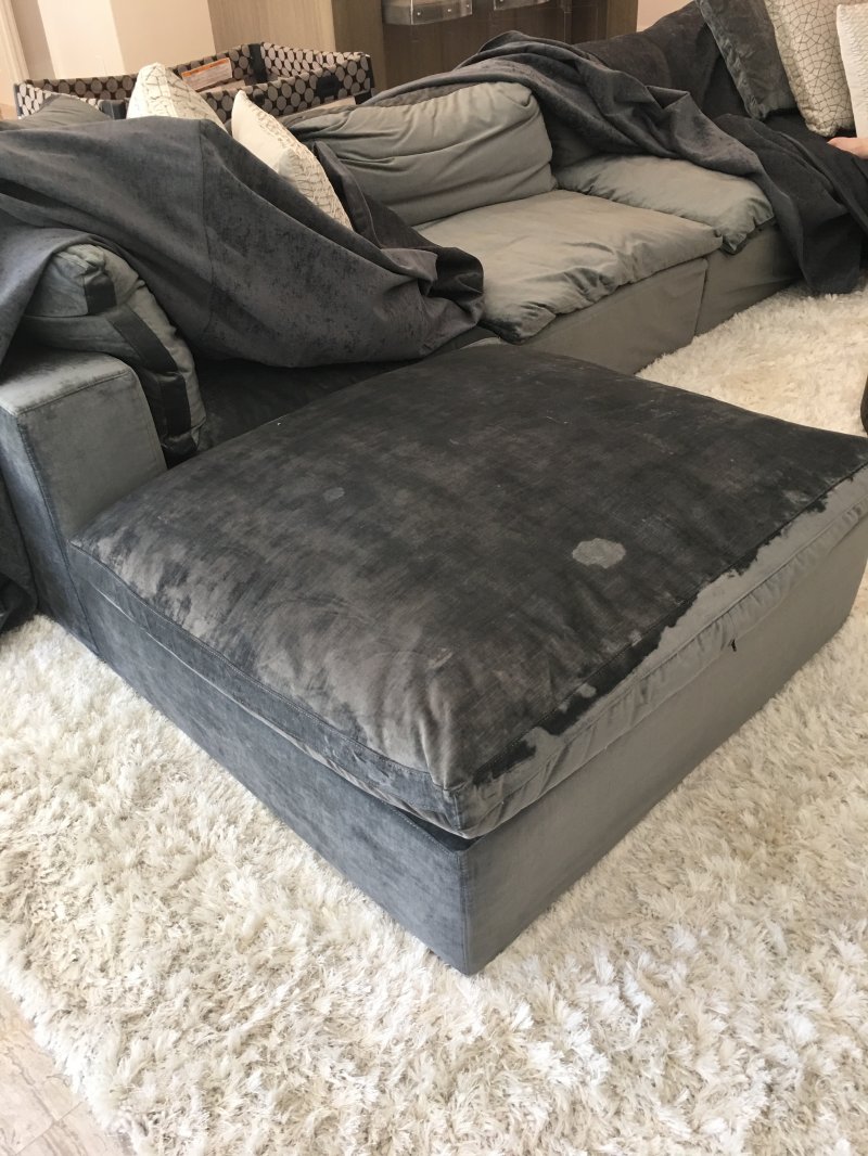

This lady called today, used another company and spent something along the lines of 1,000$ to have them clean and then use MicroSeal to protect their couch. I guess their designer recommended this company as they only do high end. The owner of the cleaning company said these spots on her couch are just water spots. She can't get rid of them, the guy then told her they would fade away. I'm not sure the products used to clean by this company are. She wants us to attempt to remove them. If these were there when the MicroSeal was applied, is it possible to remove them?
She said the couch was brand new basically, but when he cleaned and applied the MicroSeal these water spot looking things appeared all over.
Look terrible. Hard to say but could be where they spilled product. The technician assumed it would dry evenly and leave no spot. However too much product couldn't without leaving a residue spot.
Solvent should break it down. Spot it on the dry side (VDS) first and see if their is improvement.

It maybe from the MicroSeal product you mean? She had Stanley Steemer out there yesterday and they told her it needed to be dry cleaned only... but they also told her, her shag synthetic rug could only be dry cleaned to. So who knows wtf. She lives in a very high end zip code so maybe they were afraid. I already told her we could do a test spot, but it may have already been damaged.
Yes, from the protection product.
Stanley is playing it safe. Anything but Standard care Herculon needs "Dry Cleaning". Its a safe but however it doesn't clean well.
Doubtful it would do any good at correcting this.

Is it just the spots in the pink circles that are a concern? I'm sure it's just the light, but the pic makes it look like there is major texture distortion at the black arrows. Is there something wrong with the area with the black arrows?

We are definitely cleaning that rug for her, which she said was also MicroSeal'd by this high end cleaner. Mike suggested using the velvet brush on this with some distilled water first. It is pretty awkward how they didn't brush all the fibers the same way. Even with microfiber easy to clean couches we brush all the fibers the same way to dry even.
This high end cleaner told her that she should only clean spots/spills with Vinegar and Water. I'm wondering if that is from her attempting to clean with it.

Marty is right. The foul deed of the other cleaner will fall on your shoulders once you touch it.
Can you tell me if it's a natural fiber?
If you look at the piece from the opposite angle, does the dark area look light and the light area look dark?
Give me your number if you'd like me to call
I would let her know it is damaged but you think you can improve it. Take the Ottoman back to your office or garage and work on it there. No pressure for time and you'll get to see the results after it dries.
Sapphire tool and some grooming should make easy work of it. Should. :winky:
Reactions: Shorty
12,682
Yes do it off site by all means.

Ya I was thinking the protector was applied and the guy doing it touched the spot causing a reverse nap or pooling efffct.
He should of groomed it all one direction. Oh well!
The question is do you need to clean the protector out to fix it?

I told Will this:
  • Have her sign a disclaimer
  • Fill a steamer with distilled water
  • and place the effected piece upside down, use two chairs, work from underneath to avoid drips.

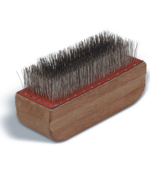

  • use a brass velvet brush to groom the steamed areas in the correct "lay"
  • Remind her that she signed a disclaimer.
  • thank Pemberton for teaching me.

I was surprised to see the crap groom job Mr Mircroseal did.
I met him at the last Vegas show.
Keep the steam condensate cleared periodically to avoid spitting. Don't get too close to the fabric.
Track marks from a jiffy steamer head are nearly impossible to remove. I've taken a cushion cover to the dry cleaners to use the steam press and get live steam to even out tracks. But I would do everything in your power not to have to do that.
