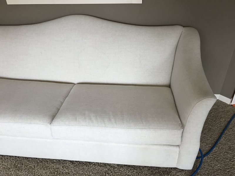

Am I okay to go ahead and get this wet? Its mostly poly. I usually jump on upholstery with my Drimaster but this one concerned me a little.
Can you see the "rings" on the back of the sofa? There's a little on the bottom right too. It's a very faint yellowing. The owner doesn't know what it is. It almost looks like browning from water.
I don't normally encap upholstery but I was thinking about it here.
Anyway, I passed on the cleaning while they had the carpet done. They want me to try in the morning.
Am I worried for nothing? Any tips? Thanks!

My guess is a cotton blend, leaning in favor of the cotton.
The soil on the arms and edges will need a good scrubbing with a fine fabric shampoo and rinsing with your DM3 and an acid rinse.
Mist some distilled water on those rings and use the DM3 to rinse out. Then proceed to shampoo and rinse
Promise nothing and do it out side in the sun if possible.

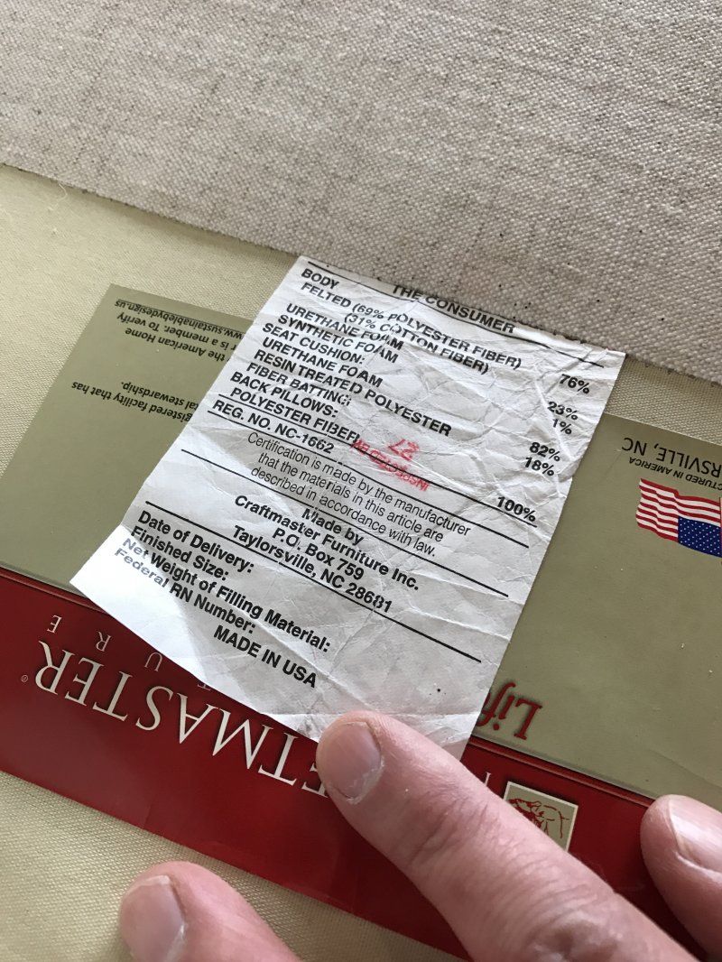

Clip a little do a burn test, tags are mostly useless.
I would hit it with a mild pre spray and rinse it with last step.

Take the cushions home and take your time. You may not make great money on this one, but the confidence you get will bring on more upholstery jobs. Misting distilled water over it shouldn't cause any problems and might make the rings disappear. This sometimes takes more than one application. If you do notice pink, jim pemberton can help. I wouldn't go any further if you notice pink inside the cushion or the ticking ph is below 5. Otherwise, mist distilled water over it, apply the foam whipped up from a fine fabric shampoo with a horsehair brush or mitt, rinse with the drimaster and a neutral or acidic rinse, then put a fan on it. If it's not as clean you'd like once dry, do it again.
Maybe the pink came from the red ink on the tag. ???
Being a gambling man by nature, I think I'd gofur it. :winky:
Every time I ruined something it was because I thought I was the master.
I thought wrong! Be patient, see what your test dries like. I agree starting the cushions could be the best move. I'd clean the back let it dry. If that dries fine do one side of the cushion. Proceed slowly, don't rush it.

I'm just going to jump on it with the DM3. I'll get it as dry as I can and use a fan as I go.
The back is fixed, without removable cushions.
I'm going to warn her before starting.

DO NOT WET CLEAN THIS WITHOUT PRE-TESTING THE BACK OF A CUSHION!
We bought one of these recently and have it sitting in our meeting room as a reminder to pre-test. The linen "look" is likely printed on and the print is water soluable. The discolorations are from spills or customer cleaning that have already dissolved the print. Touch it with water, you own it.
Look inside a cushion and see if it looks the same as the outside of the cover. If not, OMS is all you can do. (This stuff fades like crazy too.)

I was going to say to Russ that when you were there doing the carpets would have been a good time to take one of the seat cushions and do a wet test on the zipper side...then go clean the carpets. Should be dry when you finished and probably the test would have told the story. Of course unzip and look inside as well. Your first instinct when you saw the water marks would have been mine as well. Would tell them sorry but no.
