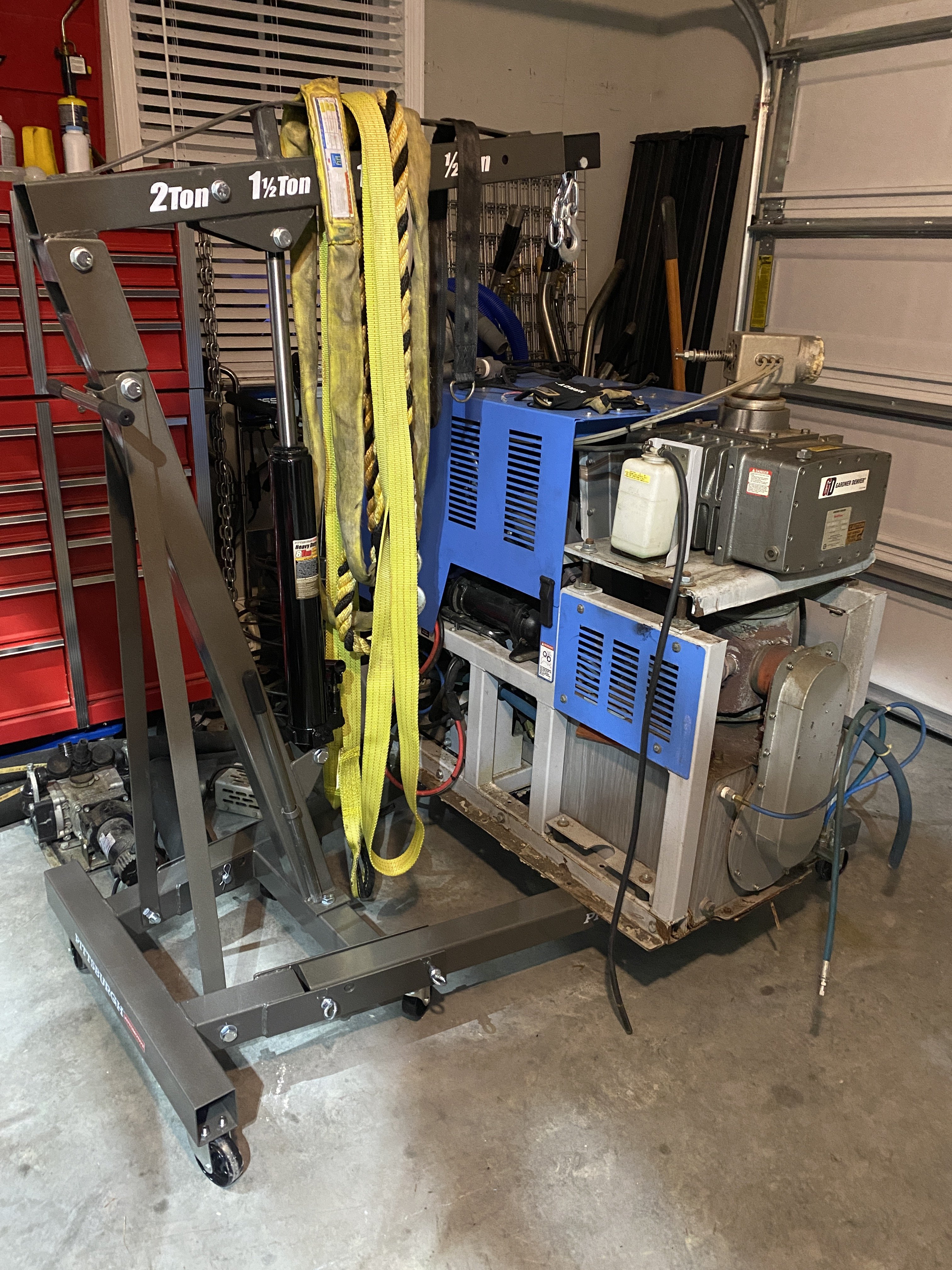

The main thing that scares me about this is the weight is uneven when you lift it
that's a matter of positioning lifting straps appropriately
I bought a load leveler with my cherry picker. But I also picked up some straps. Like Larry said I think if I position it correctly it should be ok.

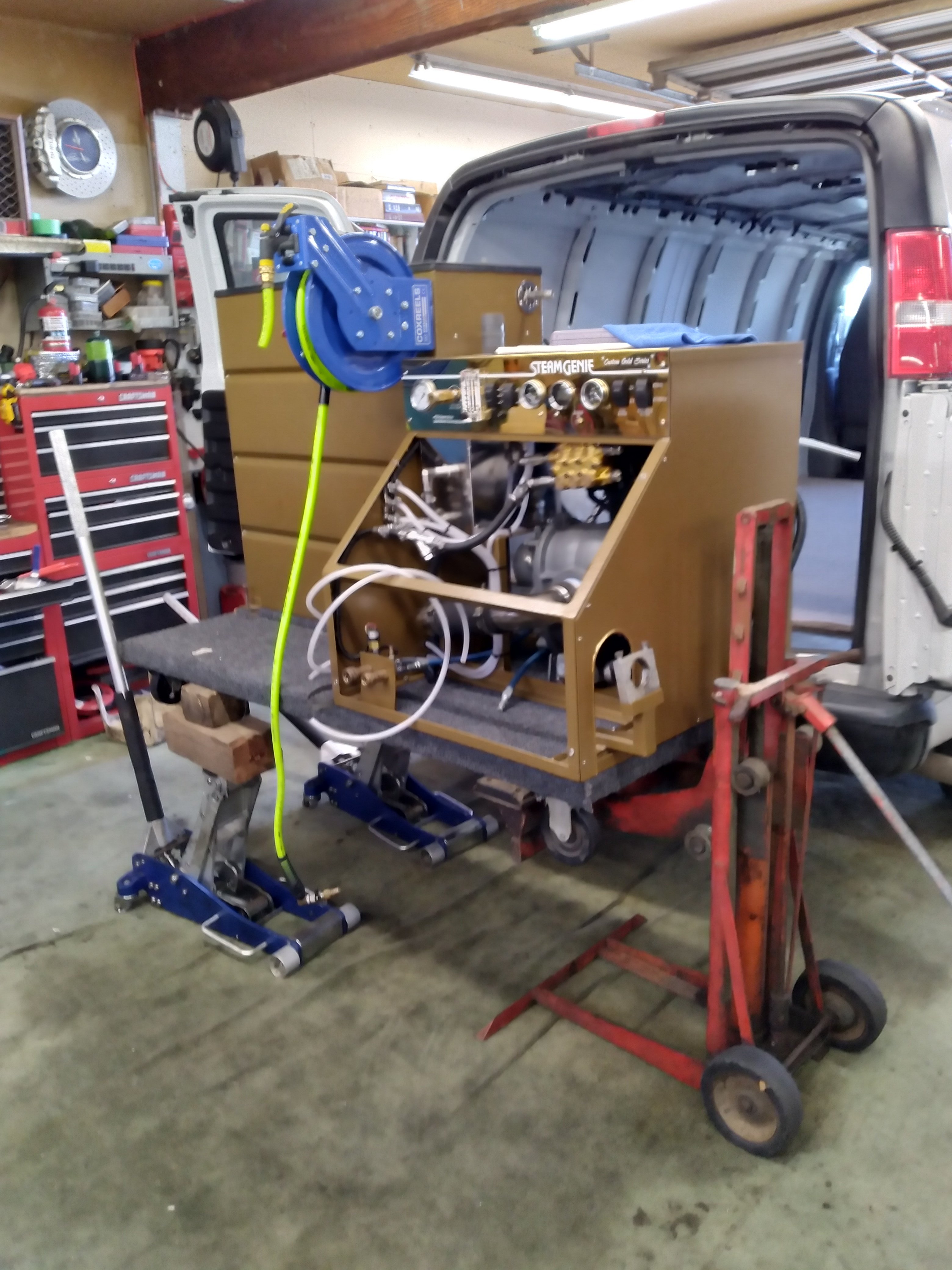

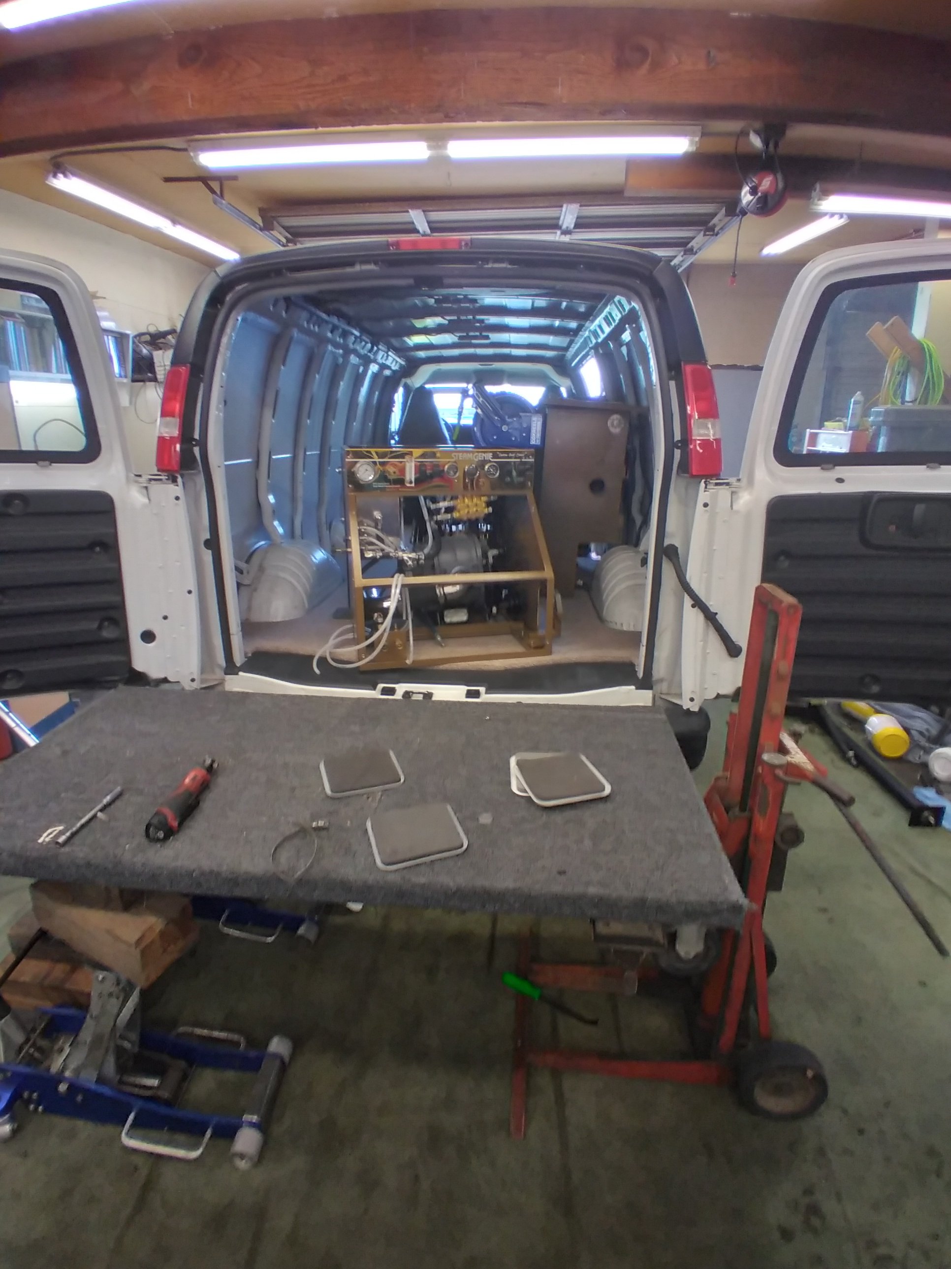

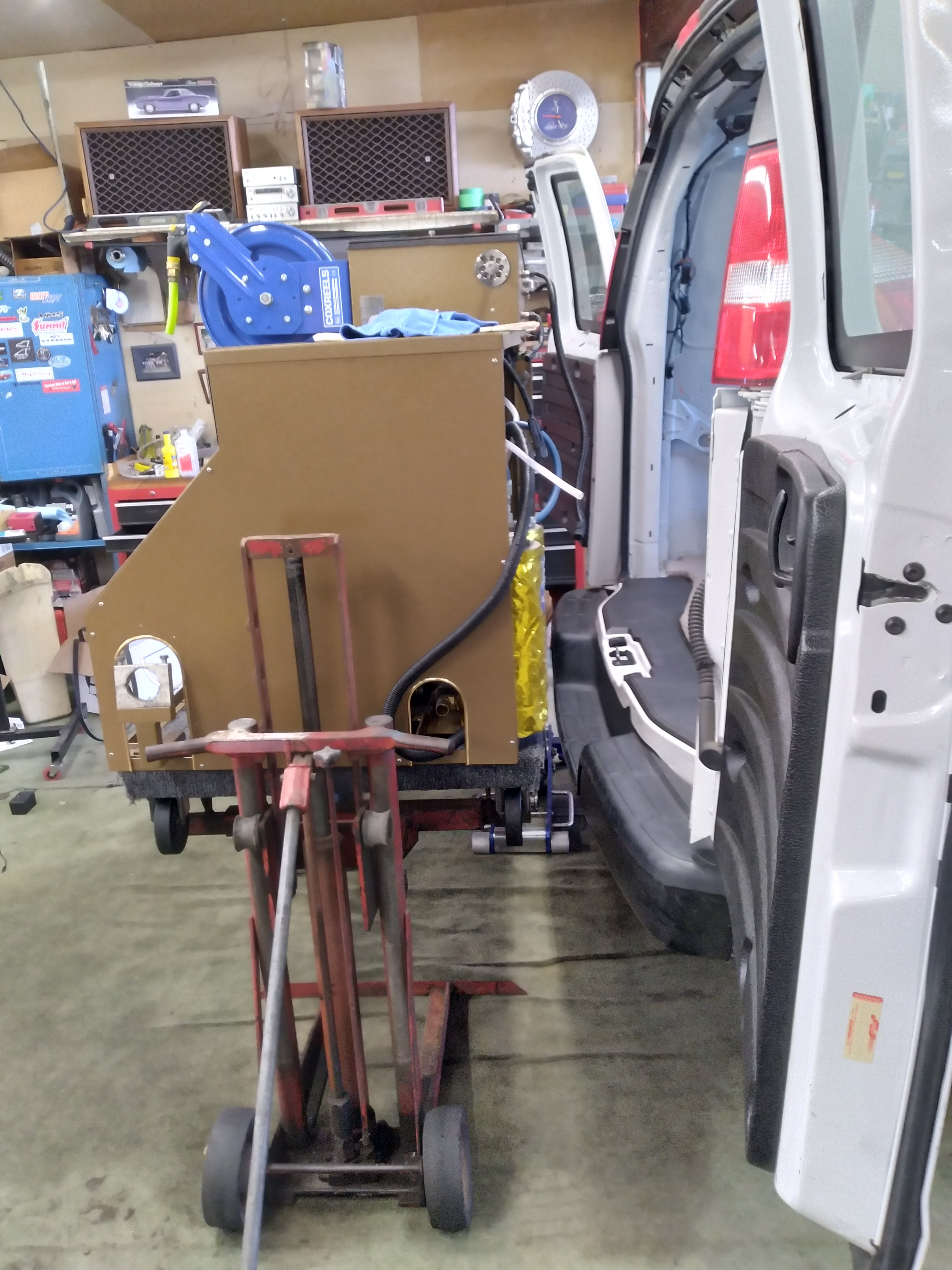

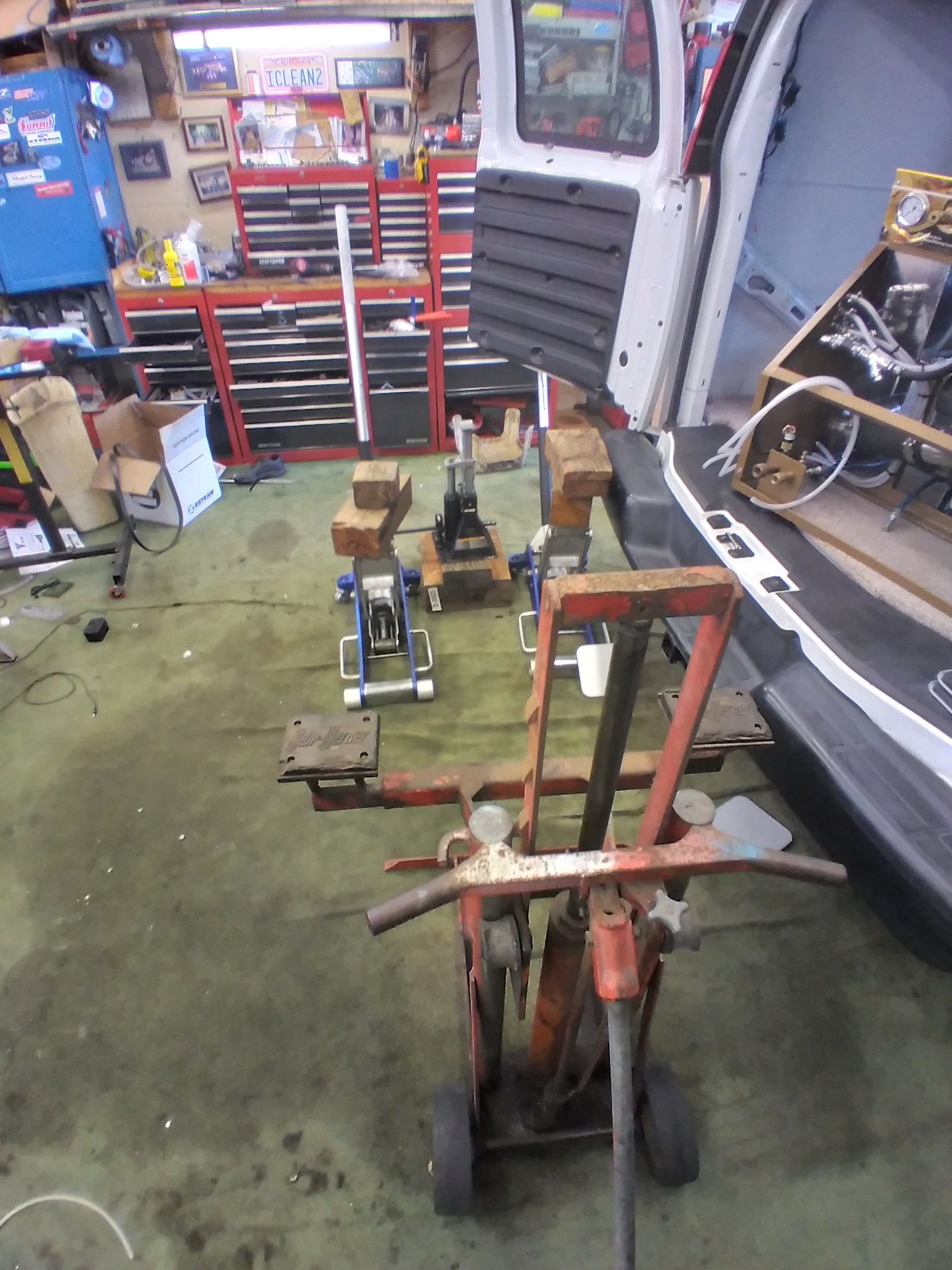

Lift it onto a stack of heavy duty blue skids with a sheet of plywood on top. Move the truckmount on skids with a pallet jack to the van. Slide the mount into the van with small diameter metal pipes acting as roller bearings. Think everything through before you act and it’ll work great.
