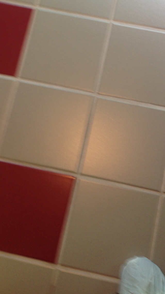

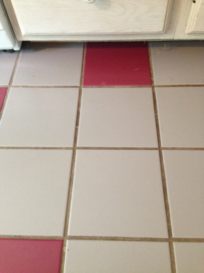

Installed in 92 first professional cleaning - lady had the reciept in hand !!

I used this amazing product called 2790 made by Shore Best sold by Dave at cleanprosupply.com
117,239
impressive!
the top set would be even more so if shot from the same angle though...

I took that after shot up close to avoid shadowing - the shadowing made it look weird until you got on top of it .. I set up an air mover in the doorway which made the middle of the kitchen completely dry .. that section looked too mint not to snap !! All the wet grout looked patchy during the drying process as did the area that looks mint.

I asked her if she had it color sealed .. she said no, dug up the reciept and said they installed mauve grout. It looks white but you can see a tint of pink. They might have color sealed it with the mauve at the beginning. It would explain why it cleaned up so nice n easy.

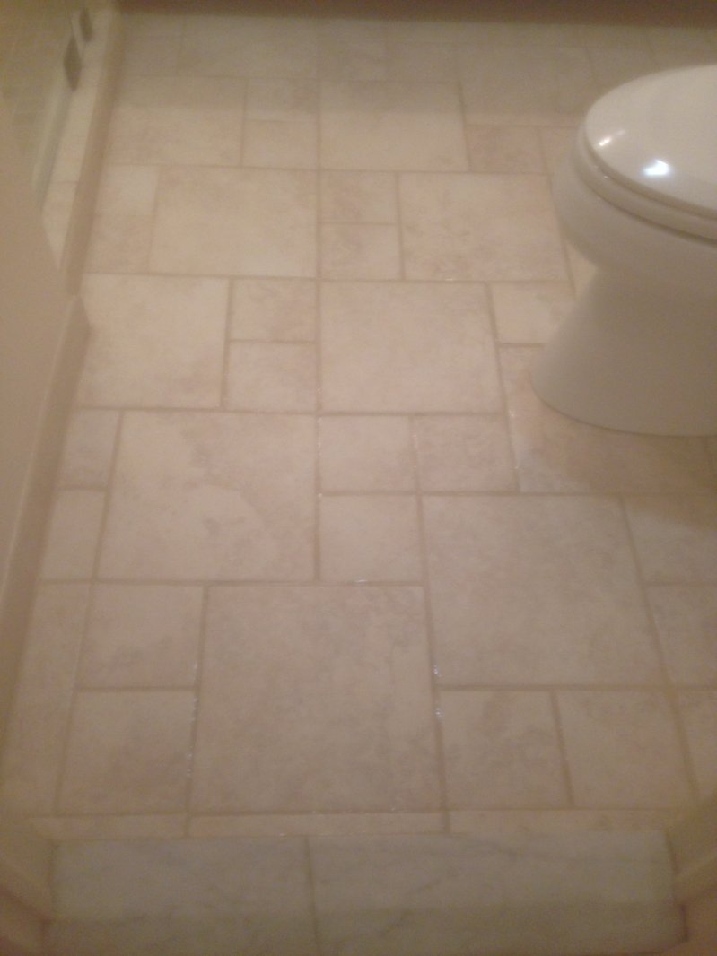

2790 is a very good cleaner but remember it's a potassium hydroxide base and 12-13 pH and will "Dull" a hone travertine floor.
Great for man made tile like porcelain or ceramic.....I wouldn't use it on any calcium carbonate base stone eg. Travertine,Marble or Limestone.....I have used it on greasy slate and it worked excellent. Just thought you should know since it sounds like you just started using it.

Did you scrub it and what mix ratio did you use?
I used a deck brush to dip and apply to the surface .. and also used a grout brush with normal agitation. 10oz to a gallon ratio but only used 5oz to half gallon of mix for 260 sf
