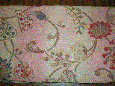

Why don't Larry send miracle product to Jim to try on photographed cushion and provide pictures. Including comparison to the base unit.

I think he just wants to see what it will do real world. I'll pay for the product and shipping if Jim is willing to correct his class sample piece.
I'd much rather know ahead of time if it is a true option over replacement.

I would be happy to conduct such experiments, or to send fabrics to Larry if he'd prefer to, since he has the best understanding of his products and their use
As Ron mentioned, in small, localized areas such correction might make sense. The challenge in large areas is the time involved, as well as the nature of jacquard weaves. The red that you see in the picture above has come through from the back. Where I've had the most challenge when I've corrected these is where you need to remove the red next to the raised yarns that create the pattern, and that contains other colors. In a tufted carpet or rug, is a bit easier to control with shims.
But in a woven fabric, the reducing agent migrates along the yarns that run both over and underneath the pattern, and invariably the reducing agent migrates into these areas and removes the other dyes as well.
With prints or needlepoint it works if you are very careful, and also on area rugs. With jacquard upholstery fabrics, even when I've used a hypodermic needle to apply small drops of reducer, I could not control the migration of the reducer through the yarns and into the adjacent colors.
That said, if there is something in Larry's formulations that can work around this issue, I'm all for learning about it and spreading the word to help others.

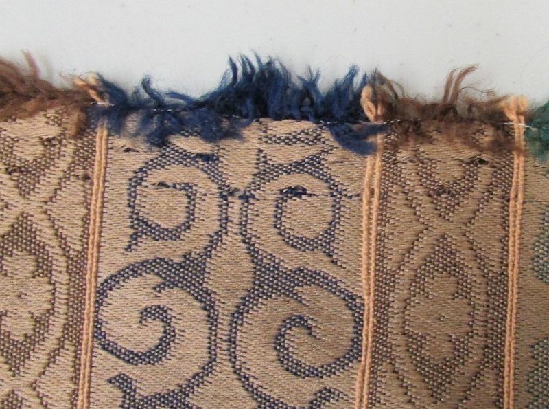

brocade.jpg Not the best picture, but an example of a fabric that bites in several ways; The underlying fiber bleeds, the tan/gold fiber is a float, and that float fiber is rayon.
If wet cleaned you end up with bands of brown, blue and green.
A float is a fiber that skips one or more cross fibers. In the fabric above, where you see color is where there is no float. In the gold areas the gold fiber skips three or four cross threads and hides the color of the cross fiber. Floating fibers are more prone to distortion and breakage, so cleaning should be done in the direction of the floating fiber. (left to right in this photo)
If the fabric has oily soils or wear, the rayon is likely to dissolve and leave only frayed ends of rayon and expose the underlying color in those areas, even if a screen is used.
Good thing this fabric is out of style.

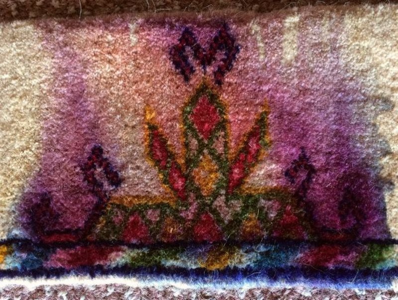

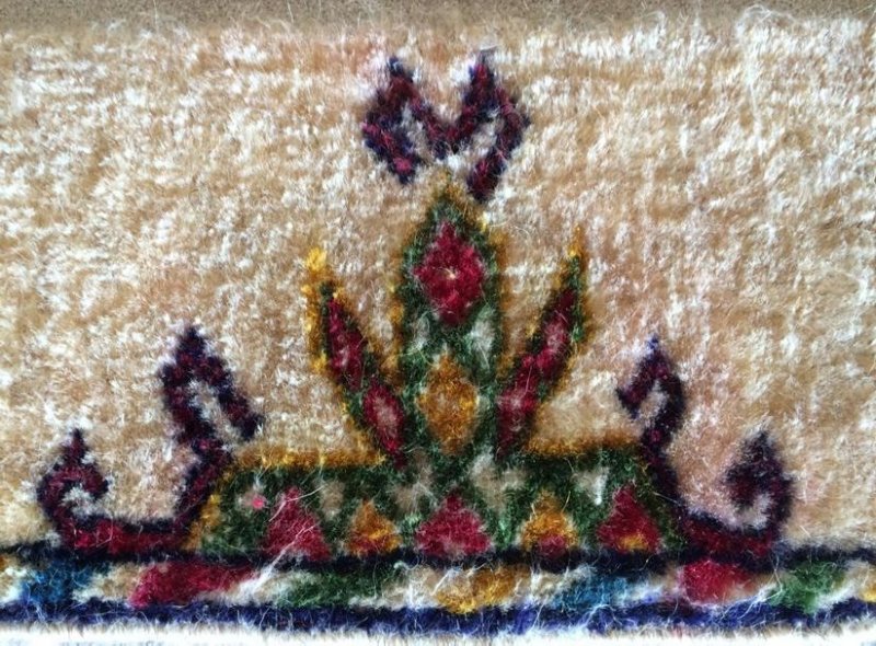

Streepene is a STREETS product. It's from the laundry & dry cleaning industry. My father worked in a laundry & drycleaners for 25 years. They used it whenever they had a color problem with a load.
I've seen LOTS of color changes with sodium hydrosulfite.
And browning on wool fibers. ReduceAll is not your father's reducing agent. I'll be glad to send some to Jim to play with on this fabric. Here's a wool bleeder I worked on (not finished): BleedingBefore.jpg BleedingAfter1.jpg
