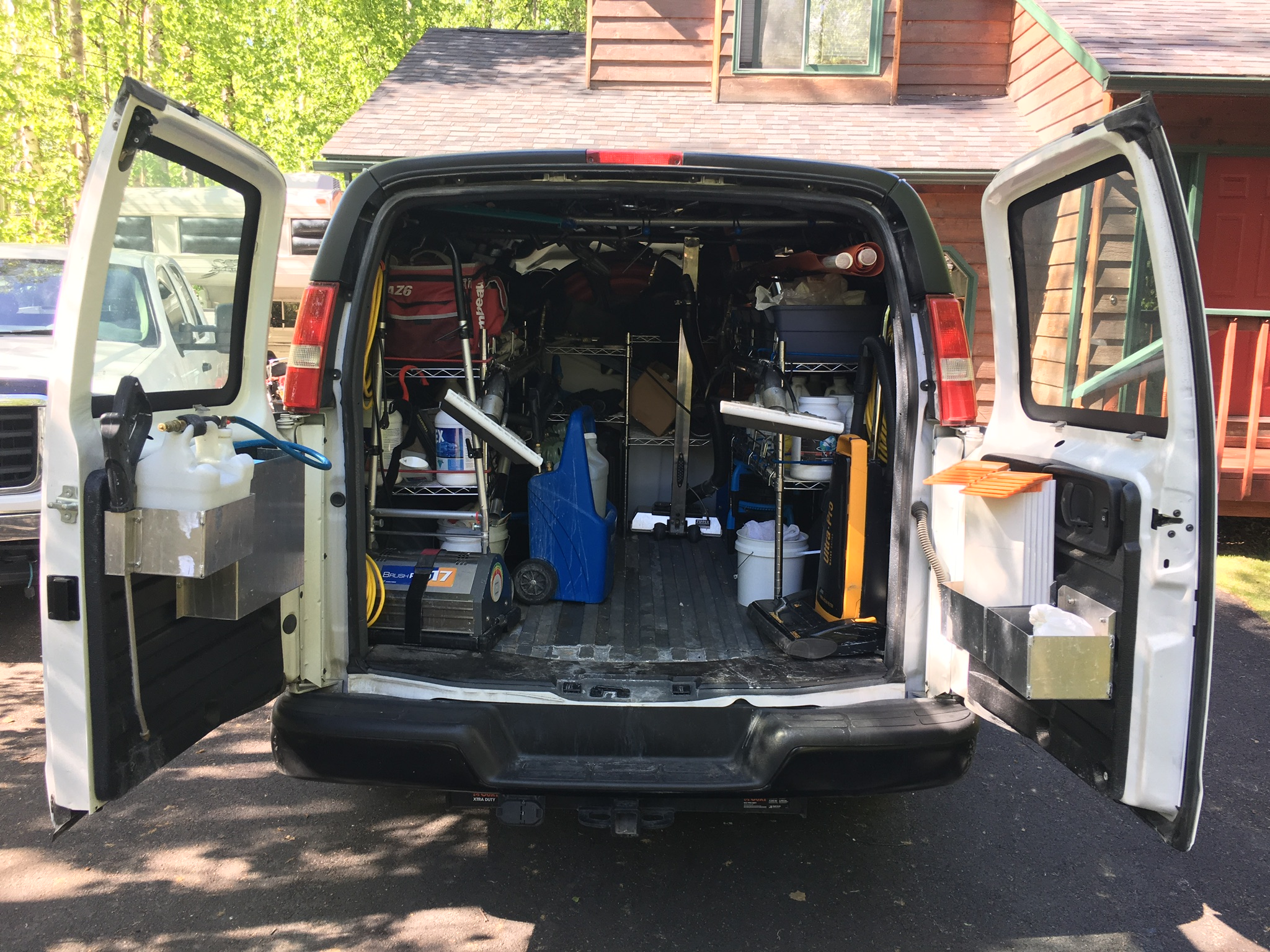

Those new Mid Mount tanks certainly open things up

I don't care for the boxes on the rear doors. Often, you are loading your van to the gills and those boxes would prevent you from closing the doors. Otherwise, it looks great. These days, carpet cleaners are carrying a lot more gear in the past. Vacuums, crb's, 175's, etc.

I have the exact butler. The mid-mount help. Without it I would not have bought a butler. With my extended I have about the same storage as a CDS or Pro-1200 in a regular van without the fresh water tank.
Agree with Ron about these boxes.
I do not like Butler's shelves (too much for carrying water damage equip and still wasted space.) Opted for two Adrienne Steel shelves that have adjustable shelving and better use of space.
P.S. Wide angle lenses tend to make spaces look....... well.............. a lot more spacious then they really are. When you sell your old home and look at the realtor's pictures of it, you'd think that place must have been a lot more spacious then I remember :winky:
I agree . . .
Those door hinges will also sag & wear prematurely from the extra weight in those shelves
I think vac power is also lost from the live vac reel.
I do like the tanks.
P.S. We've always used mid-mounted dual tanks on our TM.

The Butler wet suit neoprene insulation turned out to be a good investment here. Really keeps the van cool in Summer. Able to keep doors closed and use port holes. The boxes on the back are designed for pump sprayers and foam blocks. The door hinges can easily handle that small additional weight. Lol. I agree that 1 of those would be enough.

Not so concerned about the hinges.
However the boxes are attached to the black plastic cover of the back door, which is only clipped onto it.
If you only have tabs and foam blocks etc. that ok, even though an accidental yank or shove (ask Damon) can pull it out and the larger the box, the more leverage.

The newer the van, the thinner the metal in the doors. The inner metal of the back doors of our newest GMCs could be twisted into a pretzel with your hands, and the plastic is as brittle as Styrene.
We use the delete option to skip getting the inner plastic, then cover the door openings with Seaboard (HDPE plastic) sheet screwed to any metal we can find in the doors. We mount the door shelves to the Seaboard. Probably makes the whole door more solid.
If someone is having problems with a GM door hinge, it's probably due to the sheet metal tearing where the hinges are attached rather than the hinge failing.
