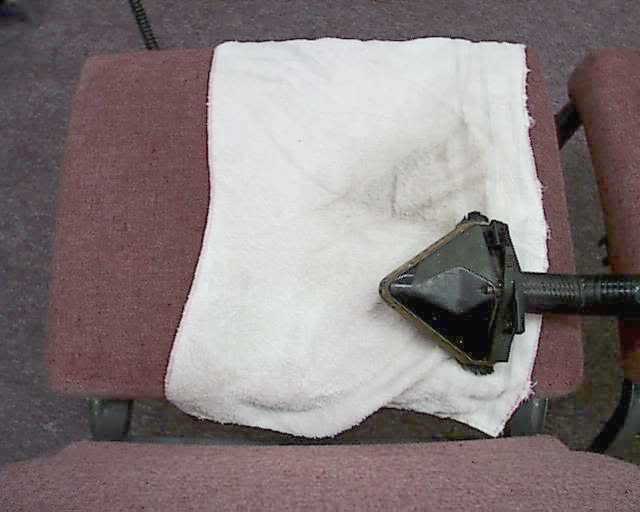

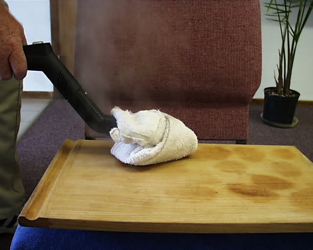

Ditto here: Took these shots with a geezer even older than Shorty or M - the old steamer man himself - Ed York who has been proclaiming the value of steam to any who would listen.
These results from using steam alone.
After making a few Nepalese cookies to enjoy with a cuppa, you can clean up the oil stains with a steamer too.
