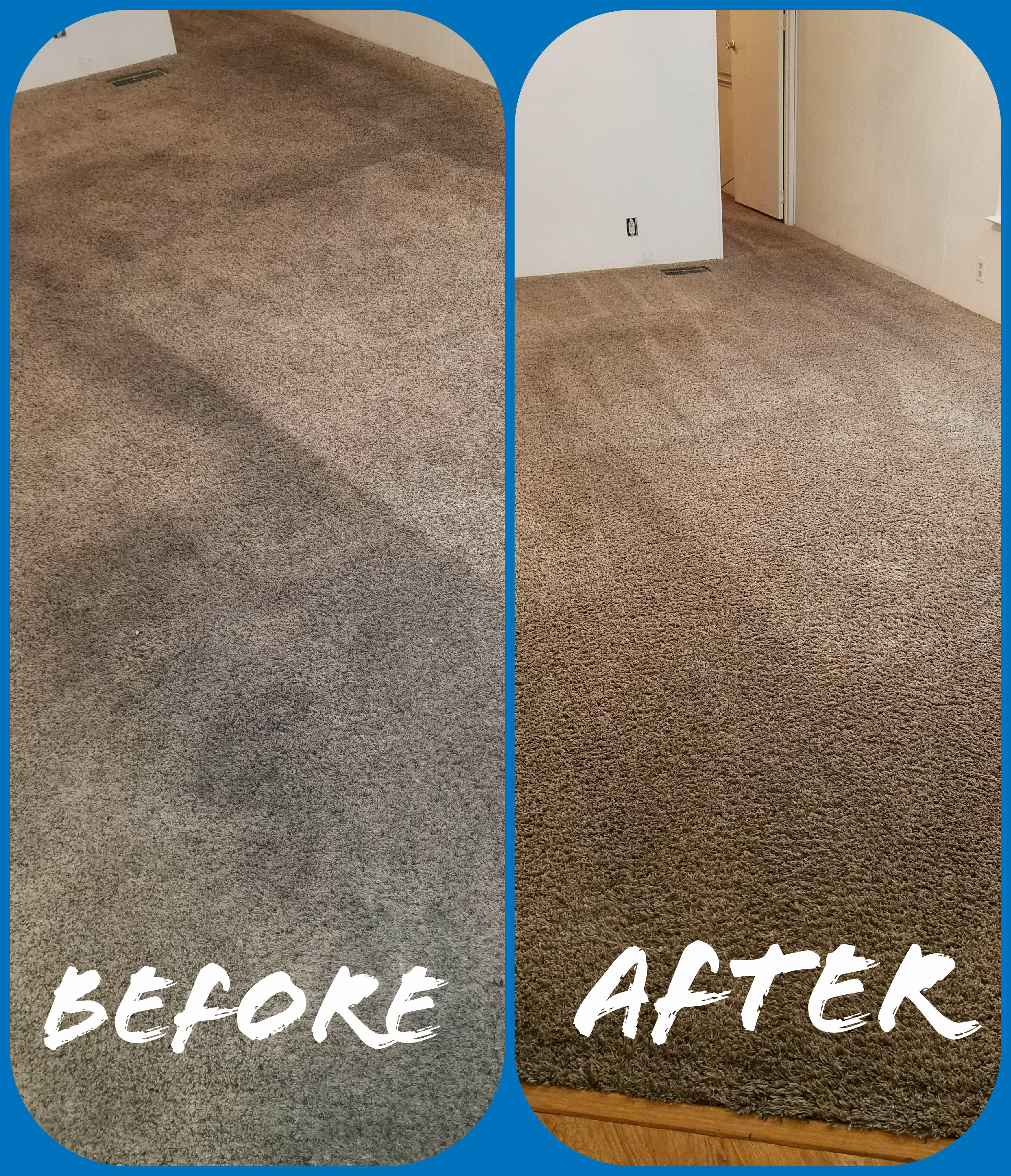

they look better with crb and encap but not as good as bonnet and encap in my experience, I decided to do just a traffic lane that wasn't responding with crb with a bonnet only to have the traffic lane look better than everywhere else.. dammit!
Not a big fan of CRB as a stand alone unless it's just lightly soiled. The bonnet worked better because you reduced the soil load in the carpet.

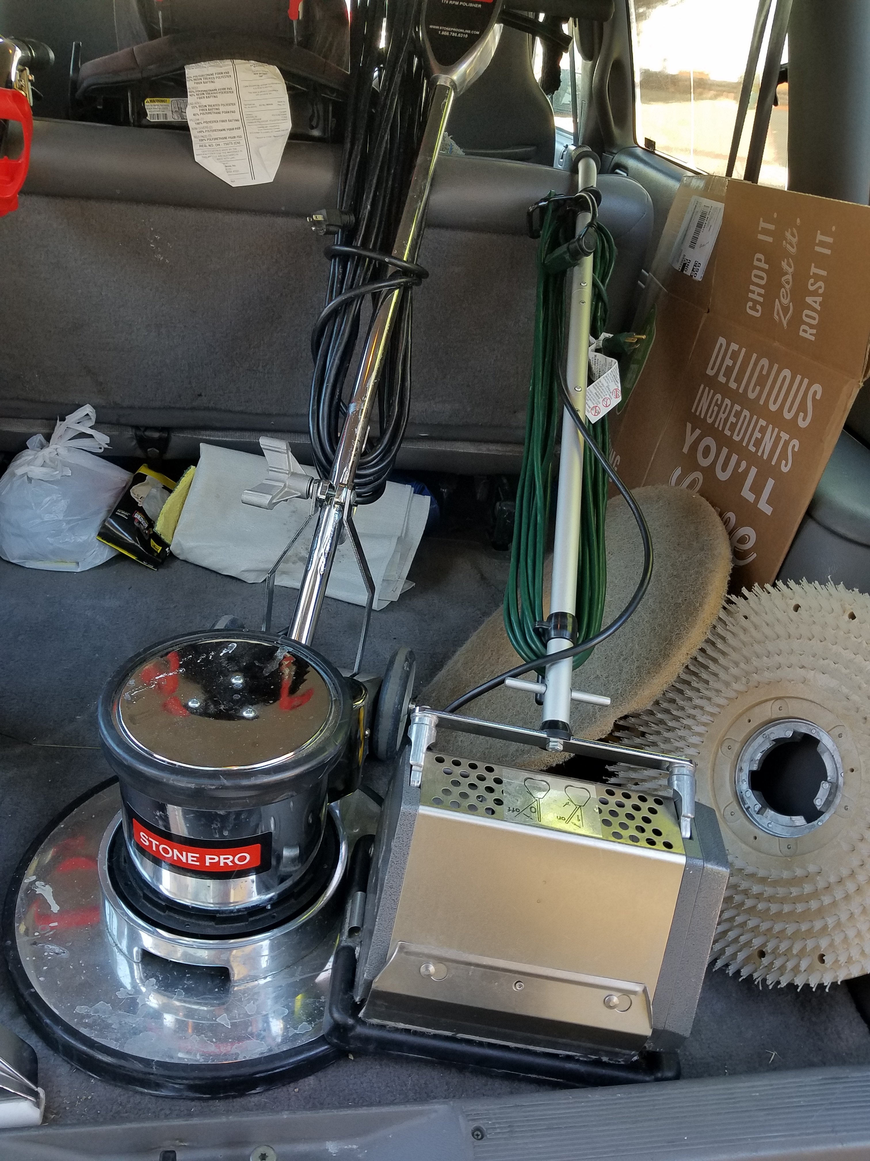

can you share a situation where CRB gives better "appearance maintenance" than a rotary?
If that was case, no one would be dragging out that Big Yellow roto-scrub monster called a Cimex , or a 90+ pound rotary .
we'd all carry in two Lil Peeder 10" CRBs and run one in each hand.......
seriously, Derick , for shearing soil off a fiber, nothing is better than a heavy wt roto scrub....nothing
if you haven't seen that in your own side by sides, maybe, just maybe ...

PB, CRB, then rotary and extract. Lets see how this turns out... carrying 100lbs rotary is nothing.

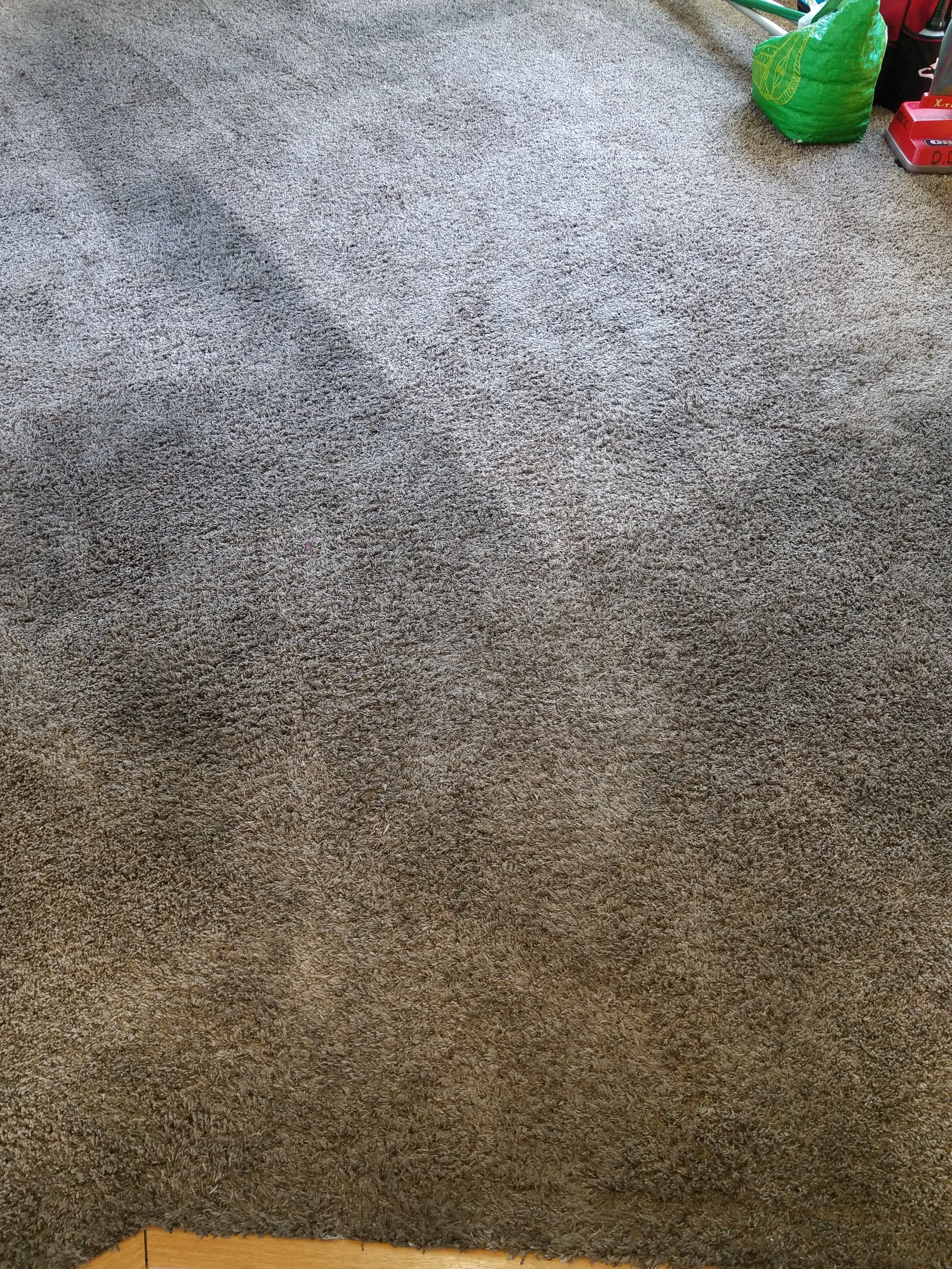

I wont. Lol. Its a crap carpet. Ive done worse and got it looking brand new. I never win with these kind of carpets. I went heavy on the PB and a nice long scrub with the 175.. meh..
