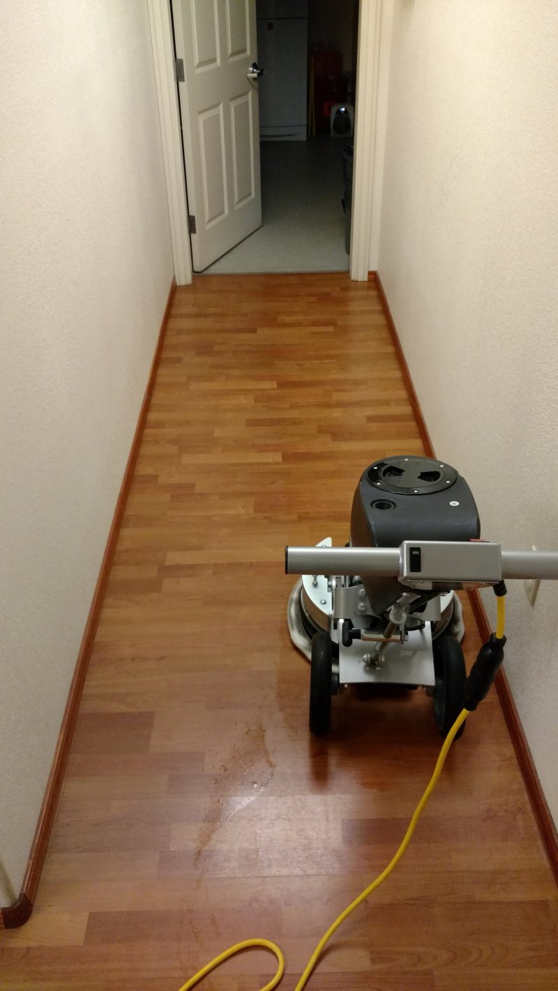

I have done several laminent floors with the orbot vibe. It works well. I used superzorb pads. Even with just water it cleaned well. I cleaned some with alot of texture and I had to go pretty slow to get all the grains clean. I used the weights.
