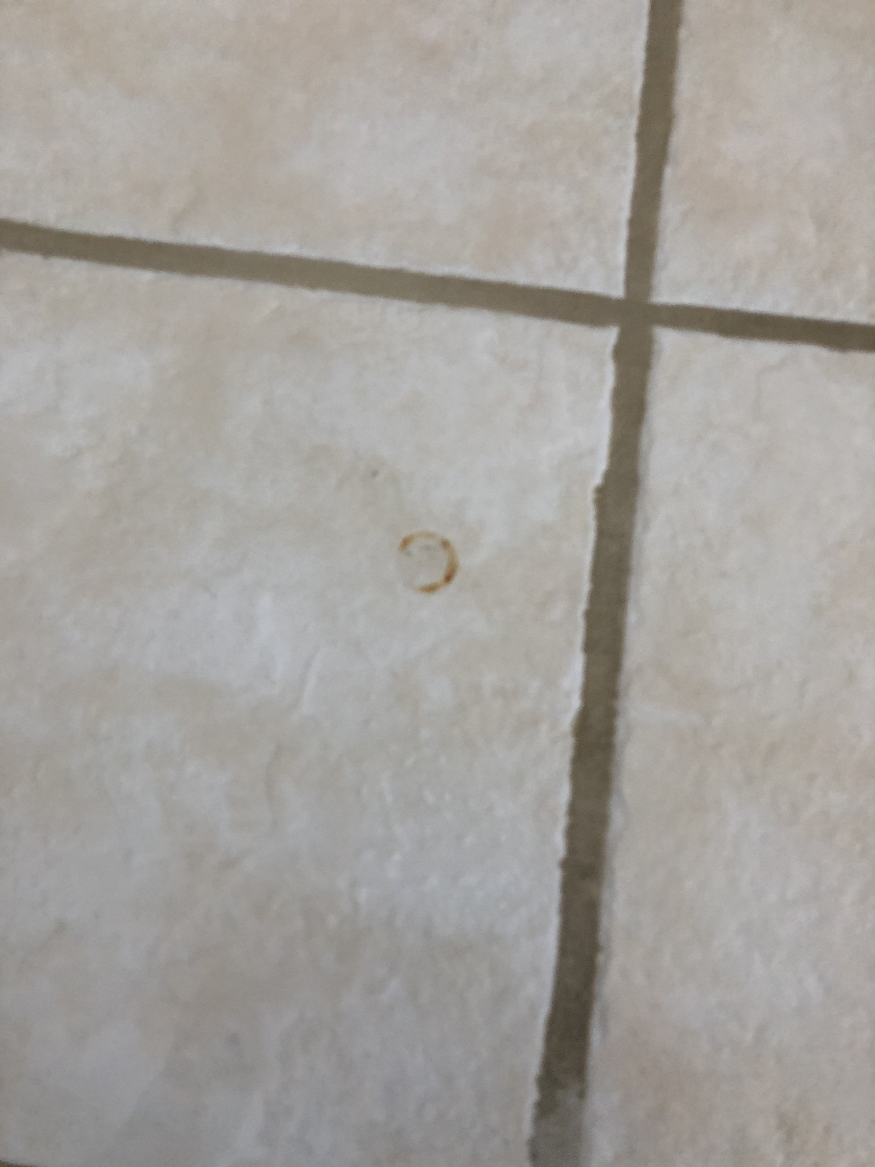

What is your method for removing rust without damaging tile?

Test Wink or a mellower rust remover in a corner, most porcelain should be fine
I'm on a barkeepers kick.
Been using it on glass and fiberglass too. Cleaned the grease off my hands that the orange stuff didn't touch.
The acylic acid is a good rust remover. Same thing as wood bleach I think.
I got a set of pads for my impact drill to do tubs with at a complex that has horrible water.. We use it on chrome to remove water spots and rust.

It was a 33 cent per square foot job. He didn't expect perfection, I will get some samples from home depot and rust them and practice on them, unless I get another chance to test your advice before that.
