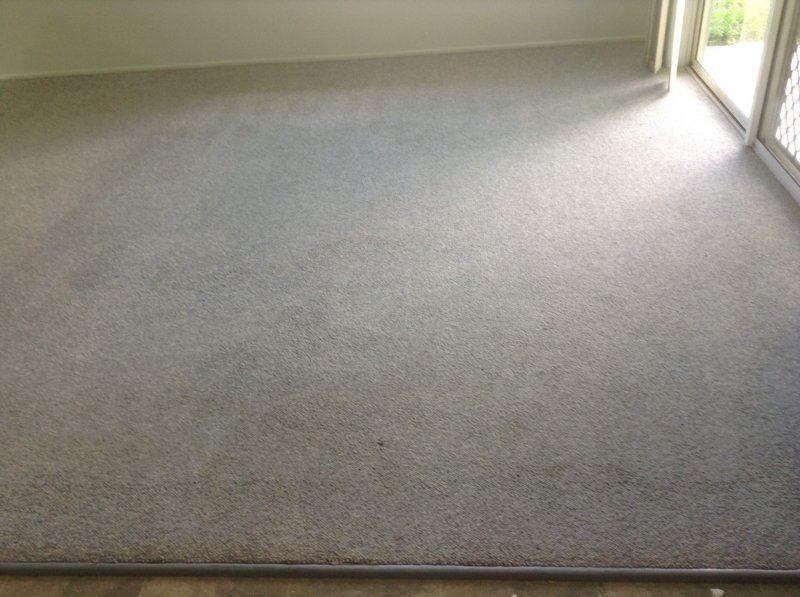

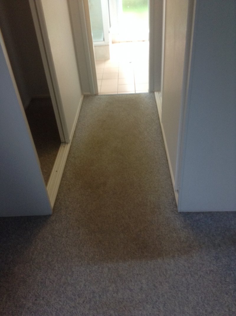

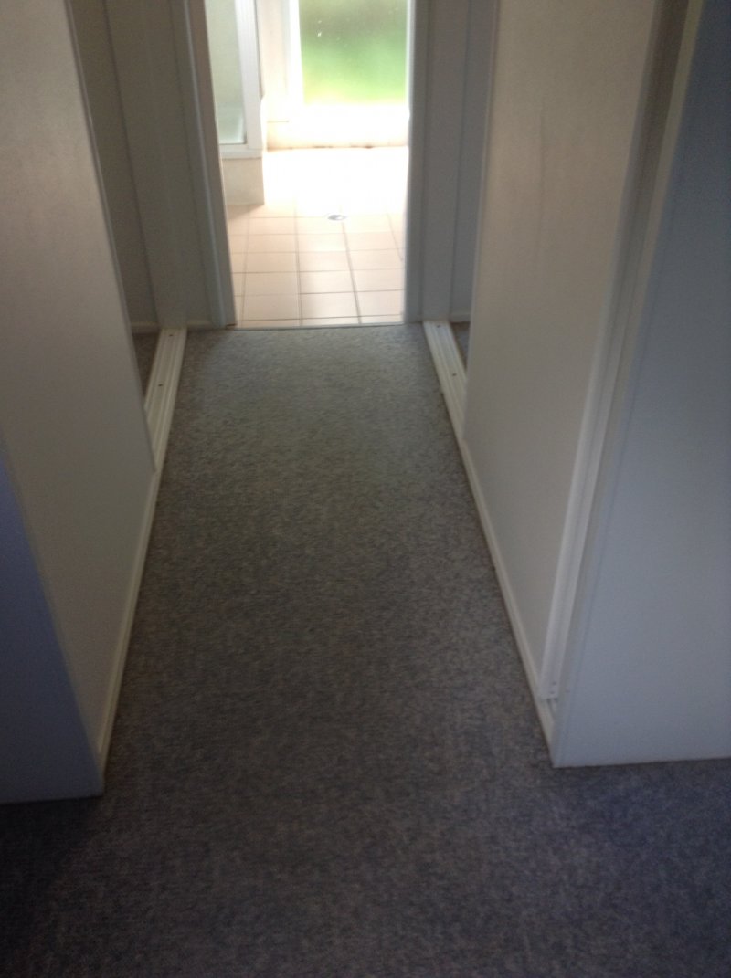

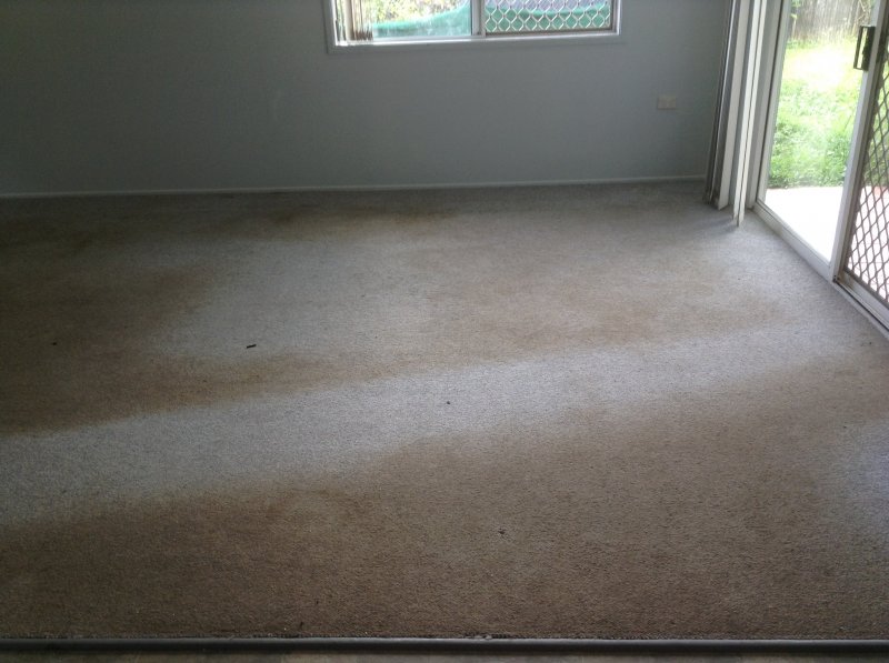

Sky, with practice, you'll get much quicker.
6 Leads??
The CFX has 2, one of which plugs into one of 2 leads on the Ranger.
The other goes to power.
The Ranger should then have one going to power.
This makes 2 leads going to the power supply.
You then also have one lead going from the 360i to power.
I do not have the Ranger, but I had the earlier model which is similar but with a lower pressure pump.
It only had the one lead.
I use only faucet pressure, so I have no reason to lug the Ranger around, just my CFX15 & 360i.
I have no problems setting up or breaking down regards time.
This combo give me pretty good results.
I'm not complaining, as it's a very versatile tool for everything I need, although it won't suit many.

Sky, the majority of my work is Commercial with a Cimex.
This was a feral house where several cc'ers; told the agent to replace as it would never respond.
Usually, I price myself out of this marketplace.
Most of my day work in residential is upholstery or leather now, so I can't honestly comment on "3 houses per day time" as it's been sometime since I serviced that market.
Back then, I was using a small truck-mount as my favourite option.
IF I was, I would be using a different extraction machine, & most probably, (as others have said), with a CRB, but unsure as to what, because I'm not really interested anymore in that marketplace.
This house was 4 bedrooms + lounge/dining & took less than 3 hours from arrival to go for AU$730.00
Most residential carpets I would use my Sprayborg, but this needed to be agitated & rotary extracted.
