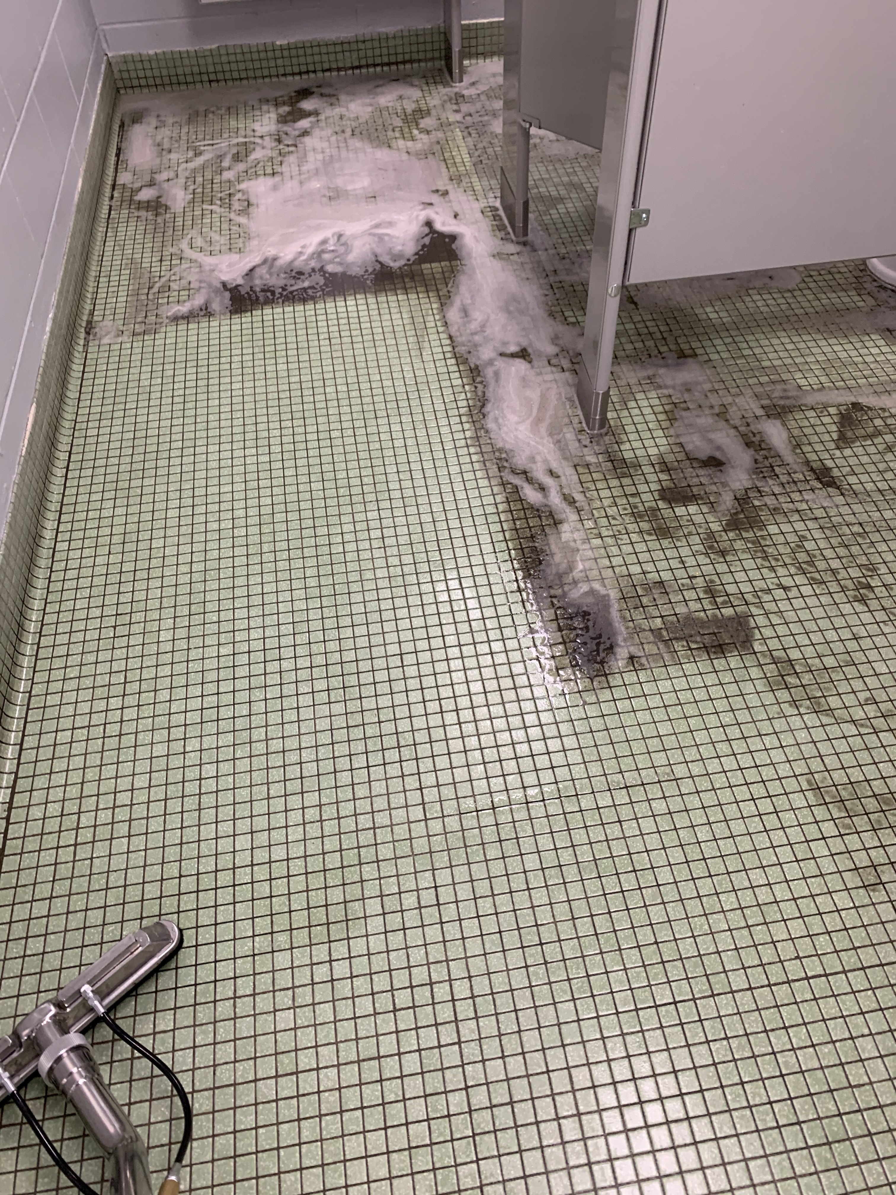

Hi Mark, I currently use Tsunami on tile & grout and love it and see no need to use anything else. My question is can Tsunami be used as a top scrub for a top scrub and recoat on VCT being it has some stripping capabilities? I use Betco Best Scrub now and it’s almost gone. Would like be able to use one product for both because the accounts that I have have both and I do them at the same time on a regular basis.
