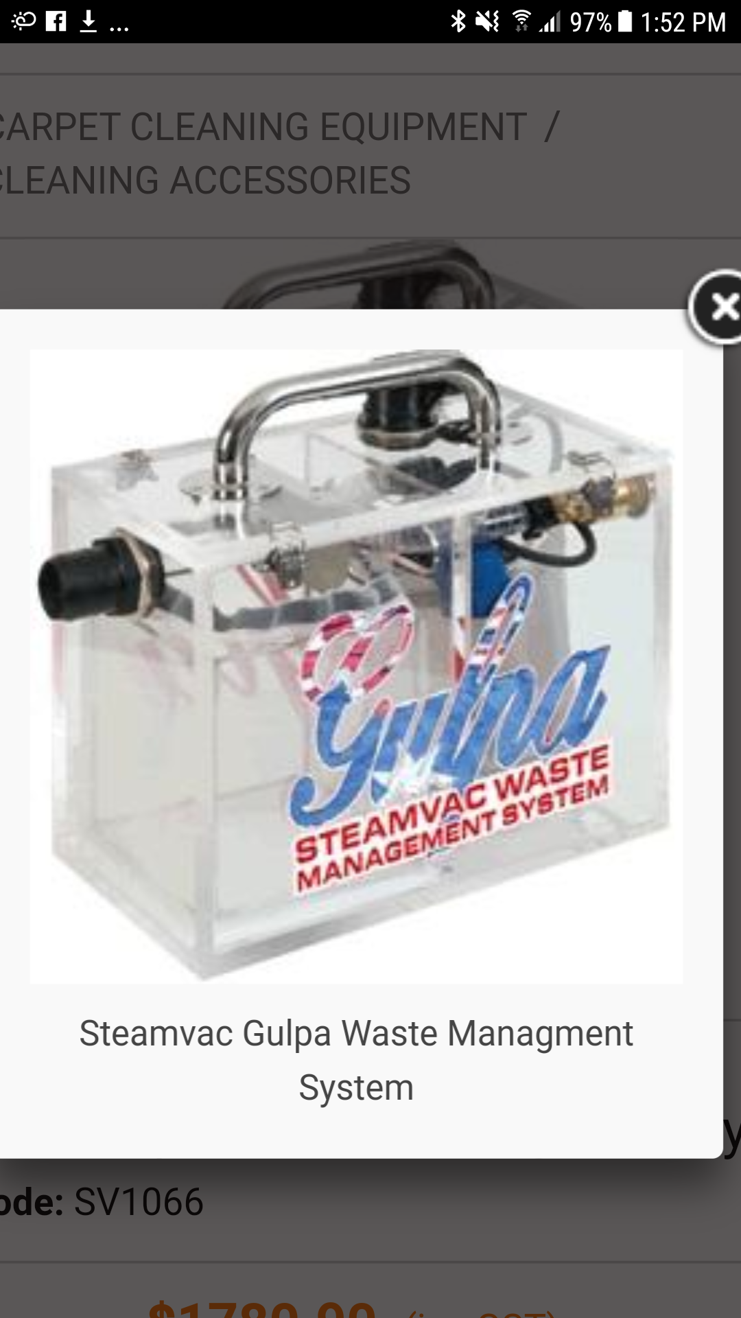

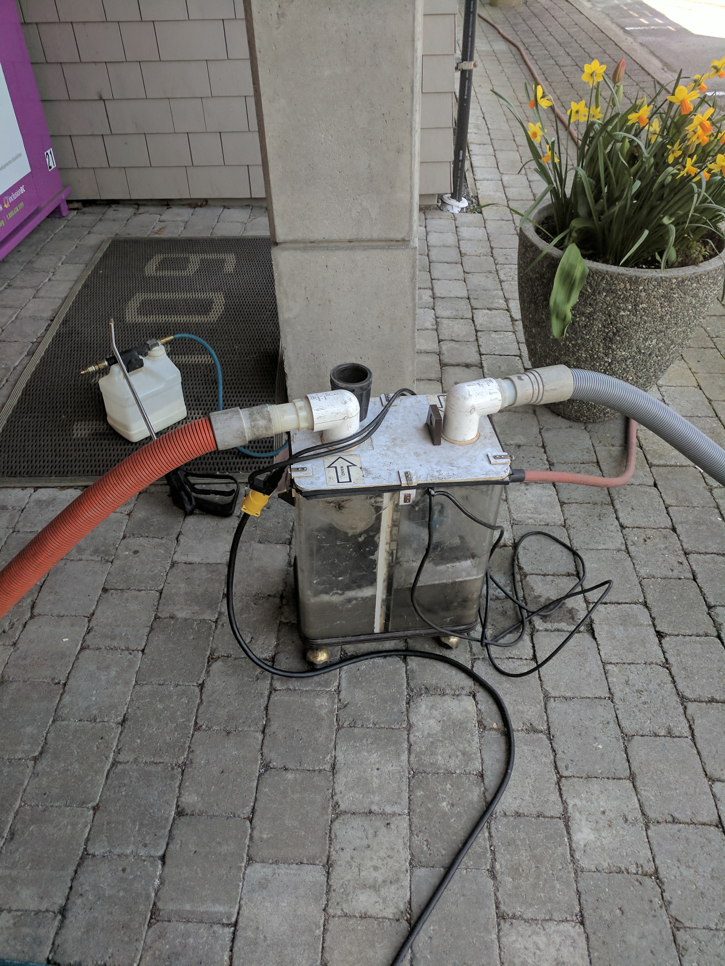

Just wondering what guys are using for pump outs, if using any at all. This is an old one I've had for 20 years. Simple and easy to use. Yes Ofer, I have more than one.

Comet here. Had one on my old Performer I sold years ago and have one on my Apex I use now.
Oh, and once I sell the Apex in a month or so, my new Titan 575 will have one too!
Fort Worth , Texas
Not only does it work it stops you from ever having to stop to dump and most of not all of the water doesn’t go to your water tank.
Other than the pain in the ass to carry/setup and clean out it works very well.
Legend brands has one as well it is just bigger and has the capability to boost vacuum. But same concepts.

Anything that you put in line will cause some loss in vacuum. There is a large filter screen running from top to bottom that keeps debris from clogging up the pump. Very simple and effective design. I only use it on large jobs that exceed my waste tank capacity. I can run all day without having to dump. I like the idea of having the built in pump outs but I hear a lot of guys have problems with them.

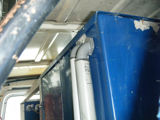

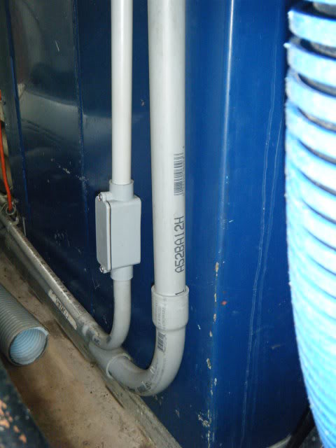

sounds great Bob ...
but wth turns it on and off?
I hillbillied (no offense to over sensitive hillbillies anywhere) a sewage sump pump in tank
used water tight electrical conduit fittings thru tank for power and discharge
obviously you need 110 vt AC
That's an extension cord to go with discharge hose (I used 3/4" com rubber hose)
and if smart, prob'ly a GFCI circuit too......
