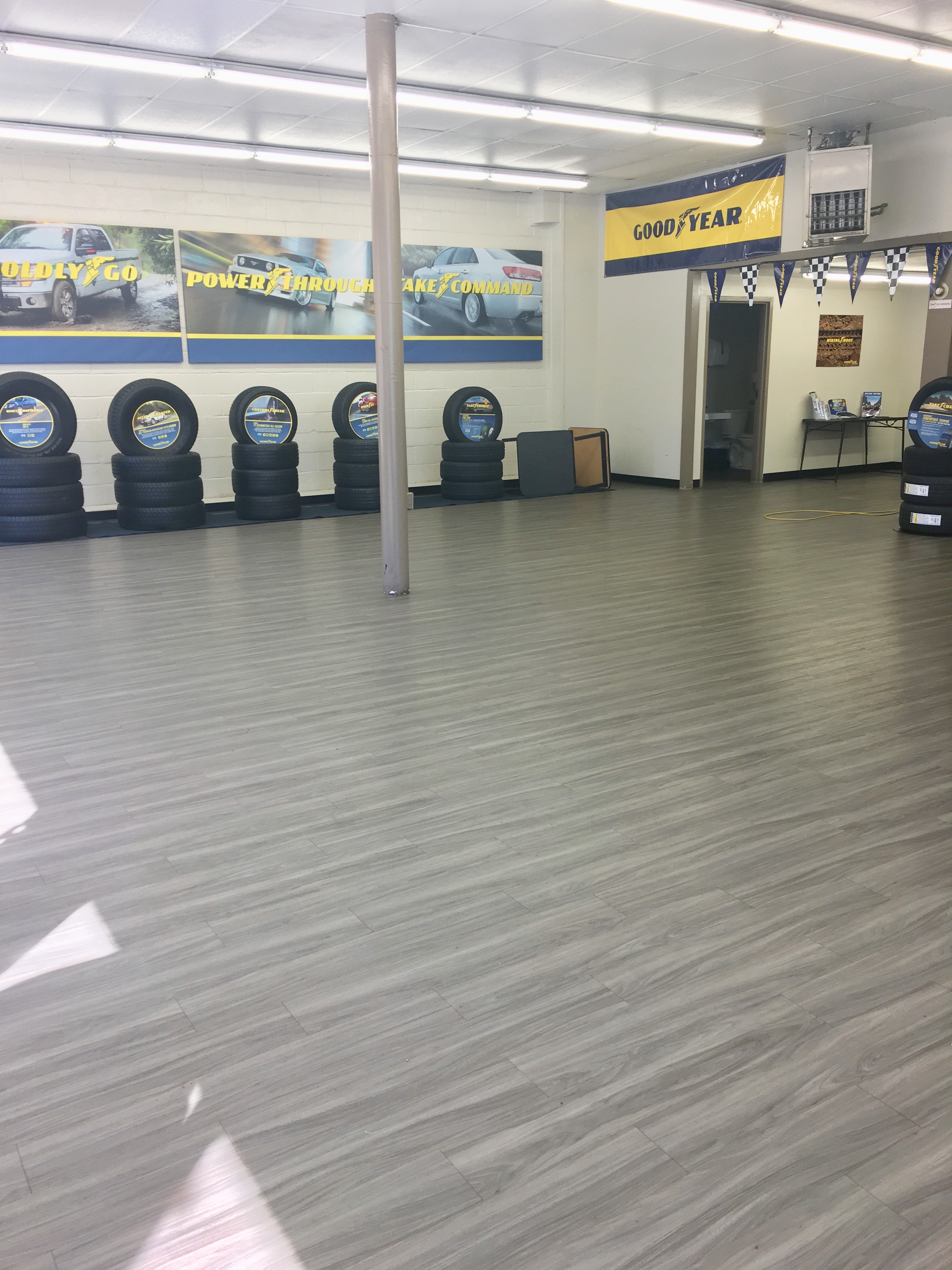

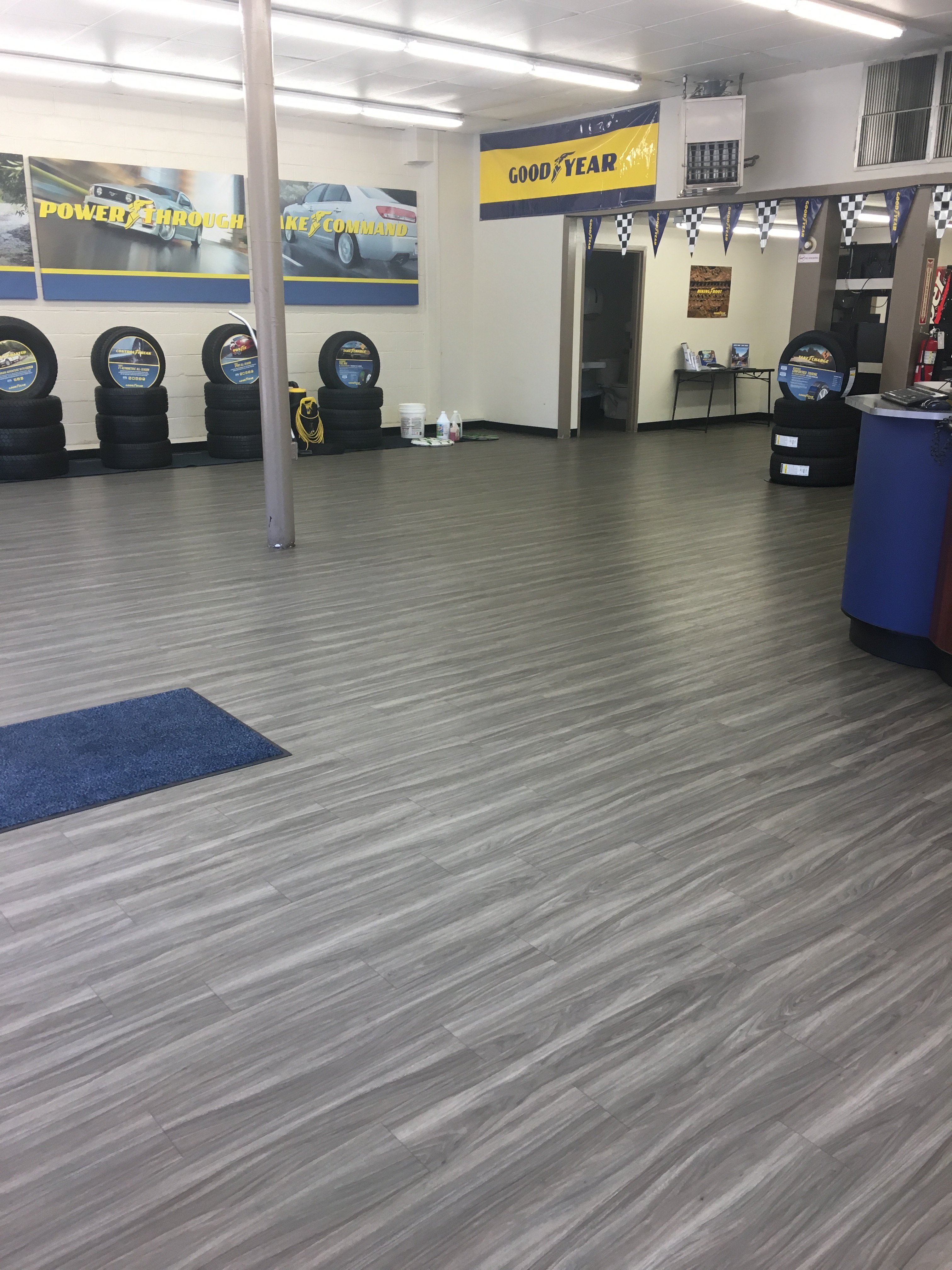

I used my OP machine on this LVP floor. With tuway-type bonnets and using ZEP glass cleaner sweetened with Saiger Cide, I trotted through about 2500 feet in two hours. Vacuum, bonnet clean, post mop with a spin mop, done. Profit was $650, so yeah, I’ll take that.

Look at the pictures and you’ll see that the wood grain pattern is MUCH clearer after the cleaning and there is better reflectivity.

Floor does look good
