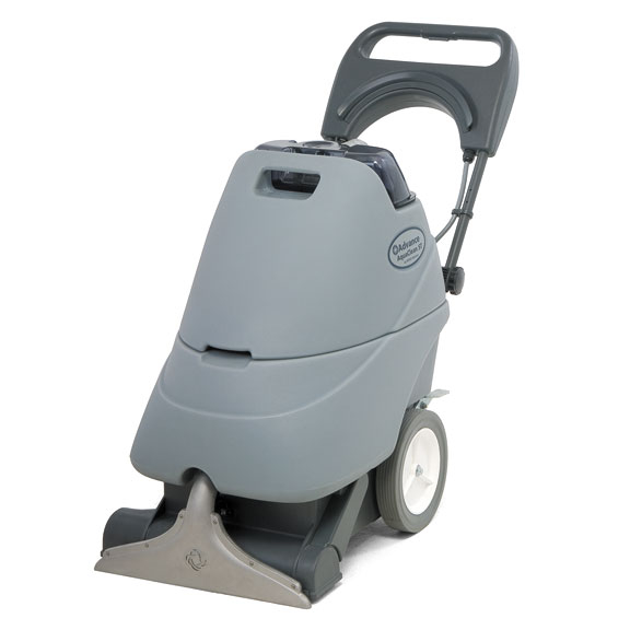

I agree, we flood the floor twice and mop till water comes out clear. Always easier with an automatic scrubber of some kind.
We use this this aquaclean with the optional hard surface kit , it is only 80 pounds and easy to get in and out of the truck. It also rinses the floor well and limits the number of times we have to mop.

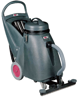

Greetings thanks for all the help. I have a wet vac and floor machine from viper that I will be using.

I also purchased a deformer so the wet vac won’t get full with foam.
