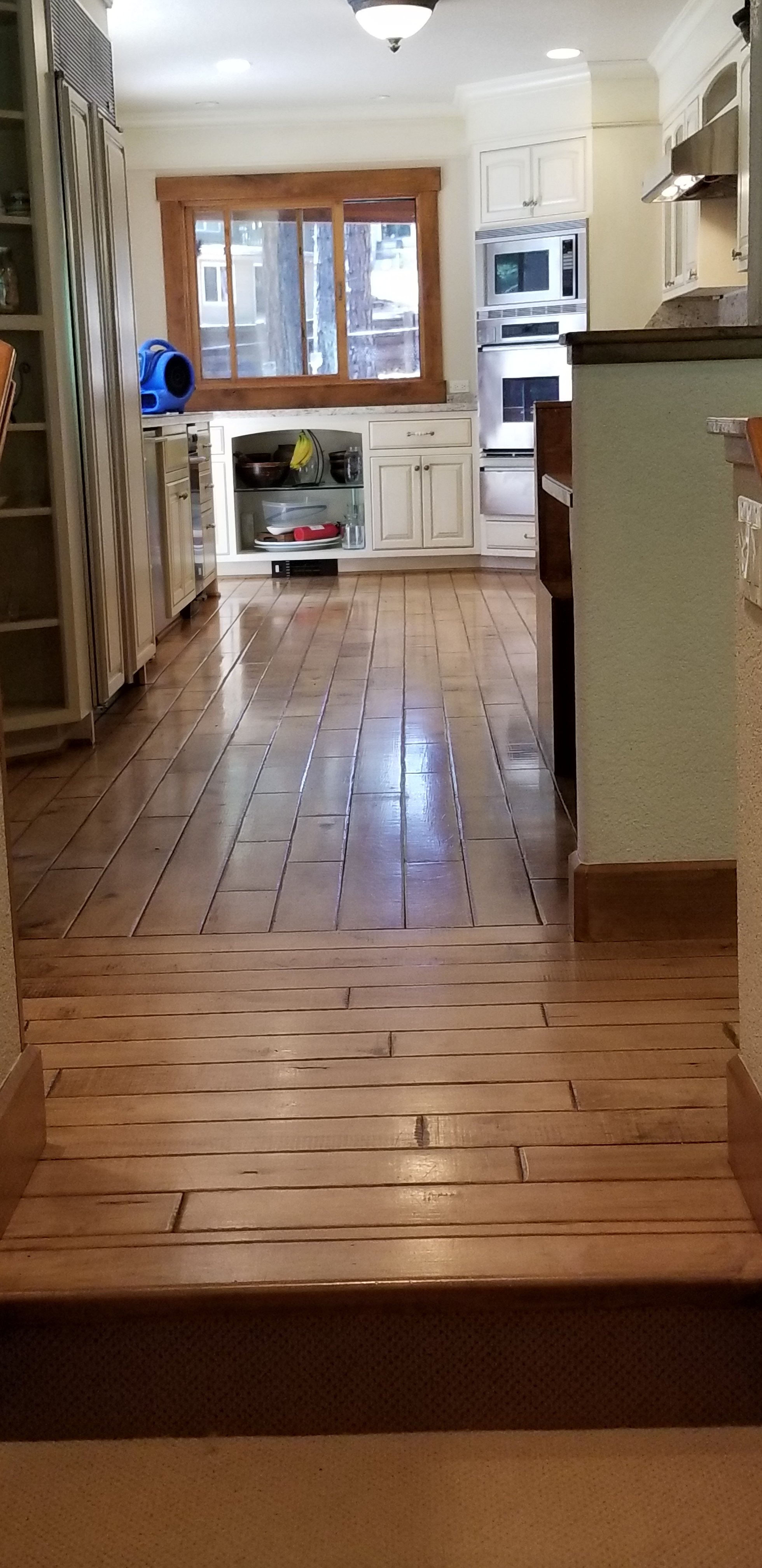

My new fave way to clean wood..
116,034
Sweep

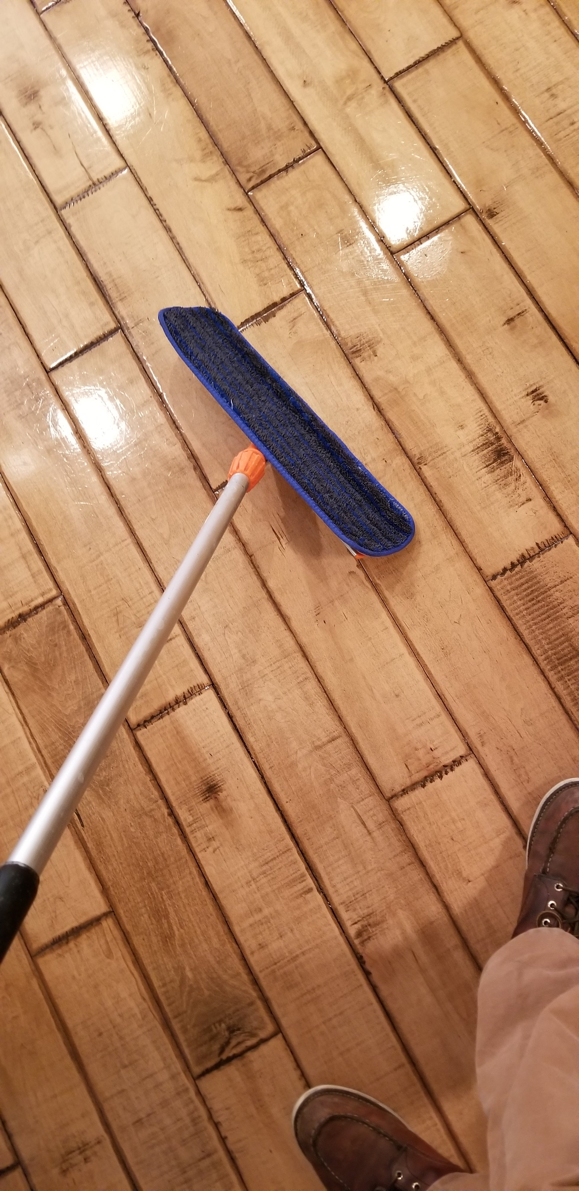

Spray neutral no rinse down

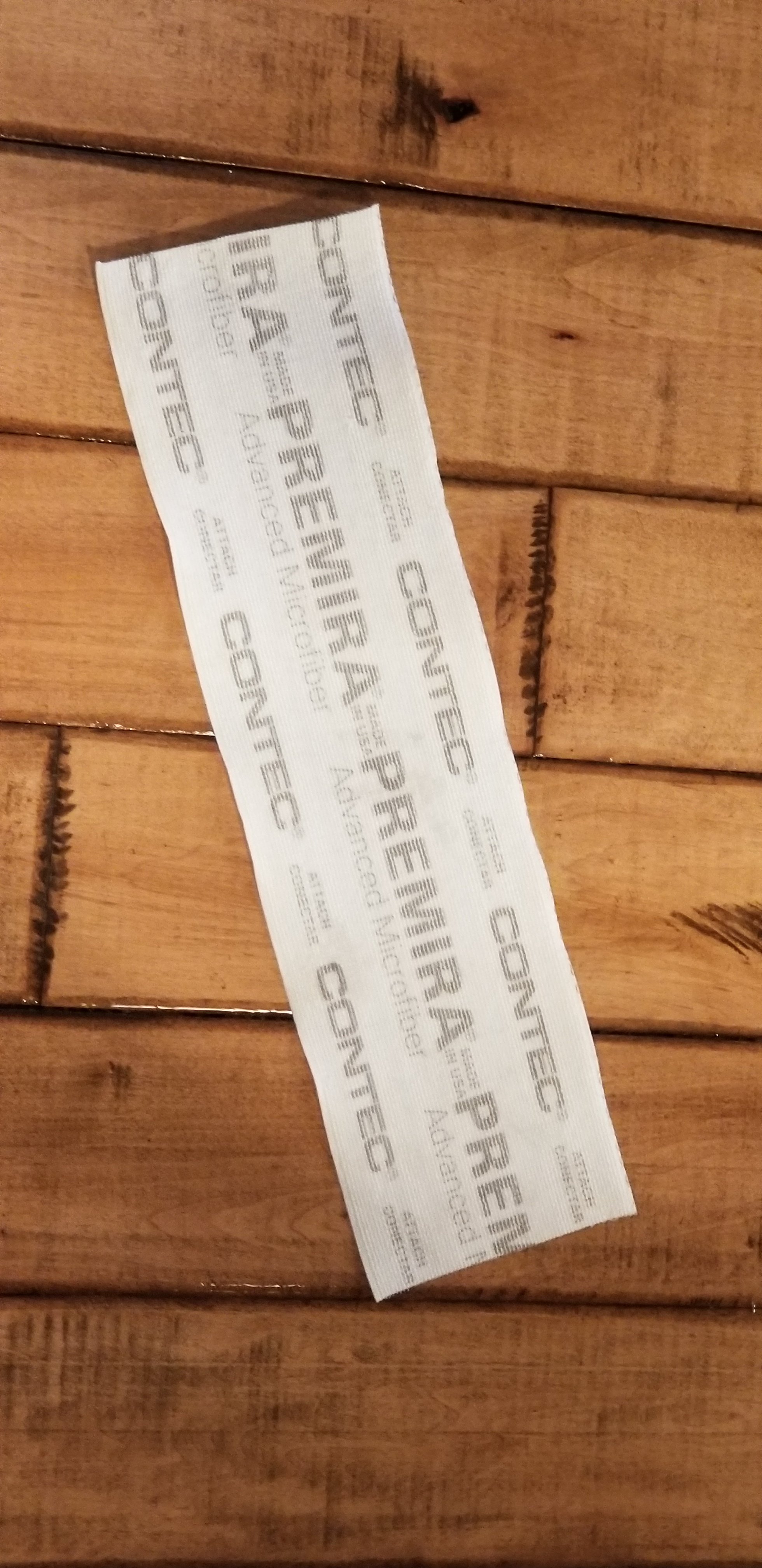

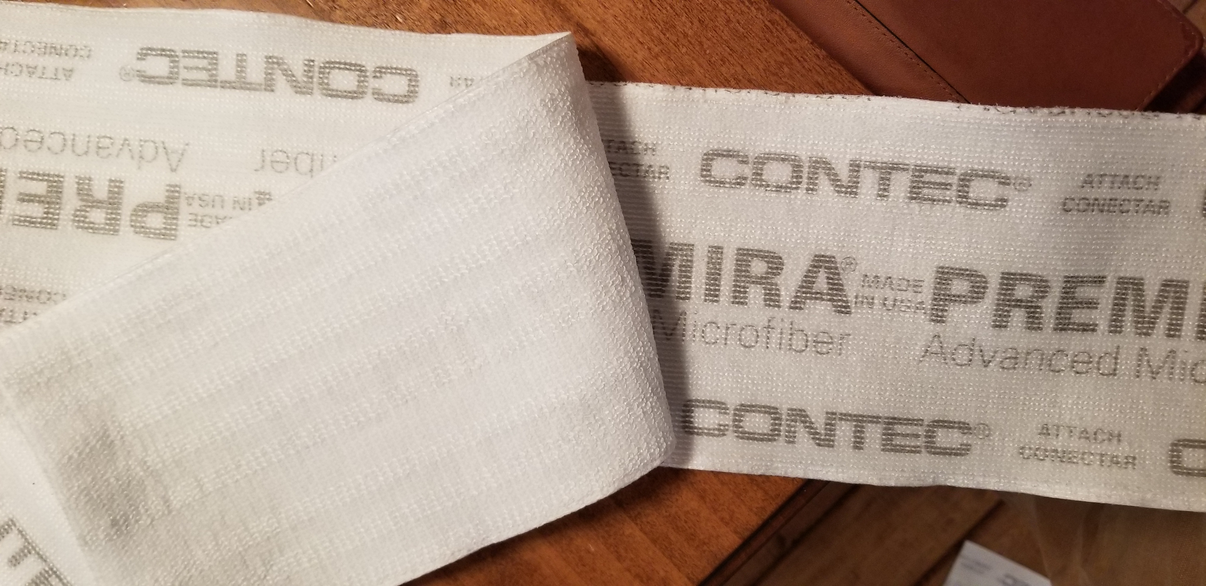

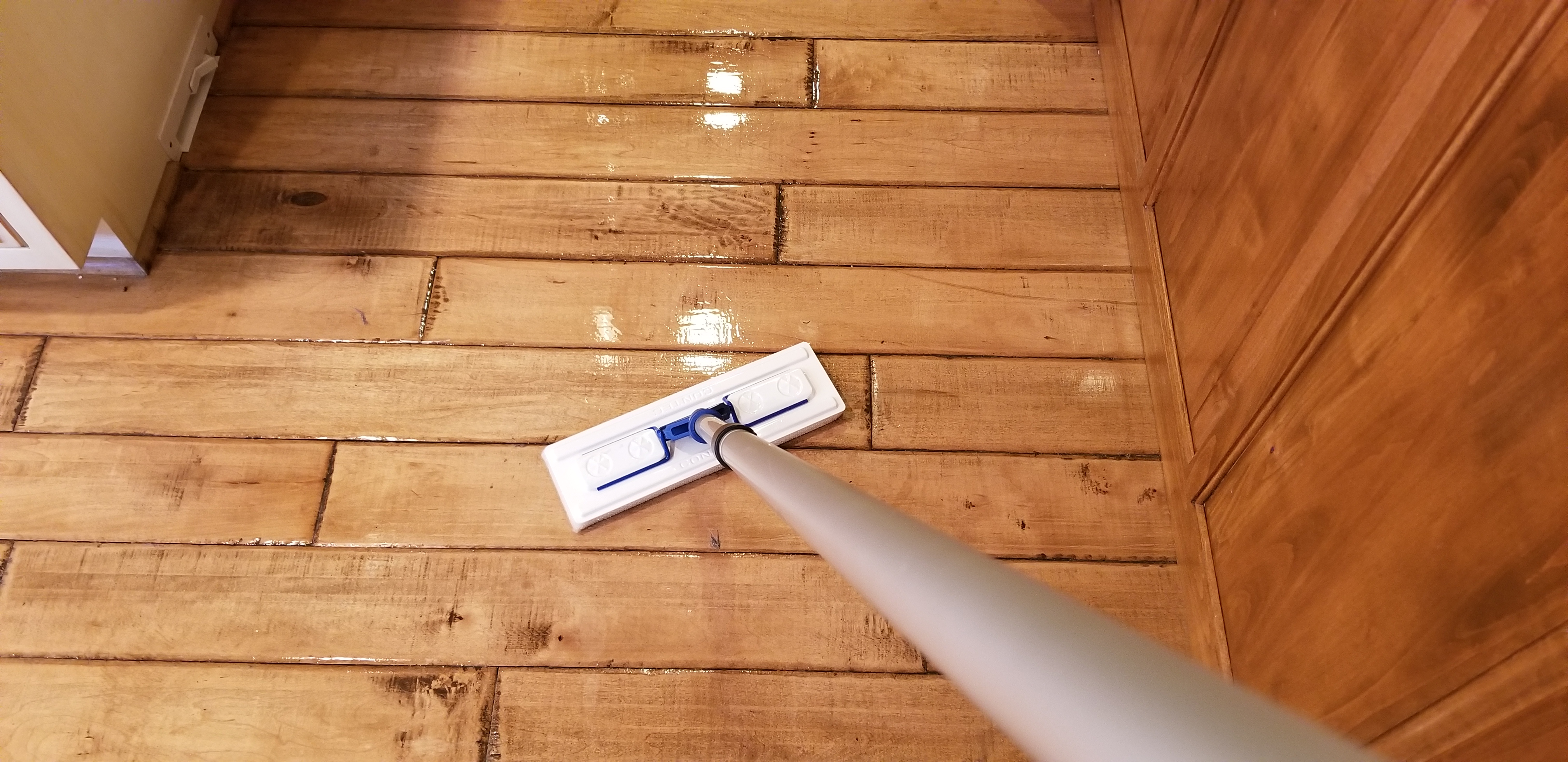

Scrub with Contec pad

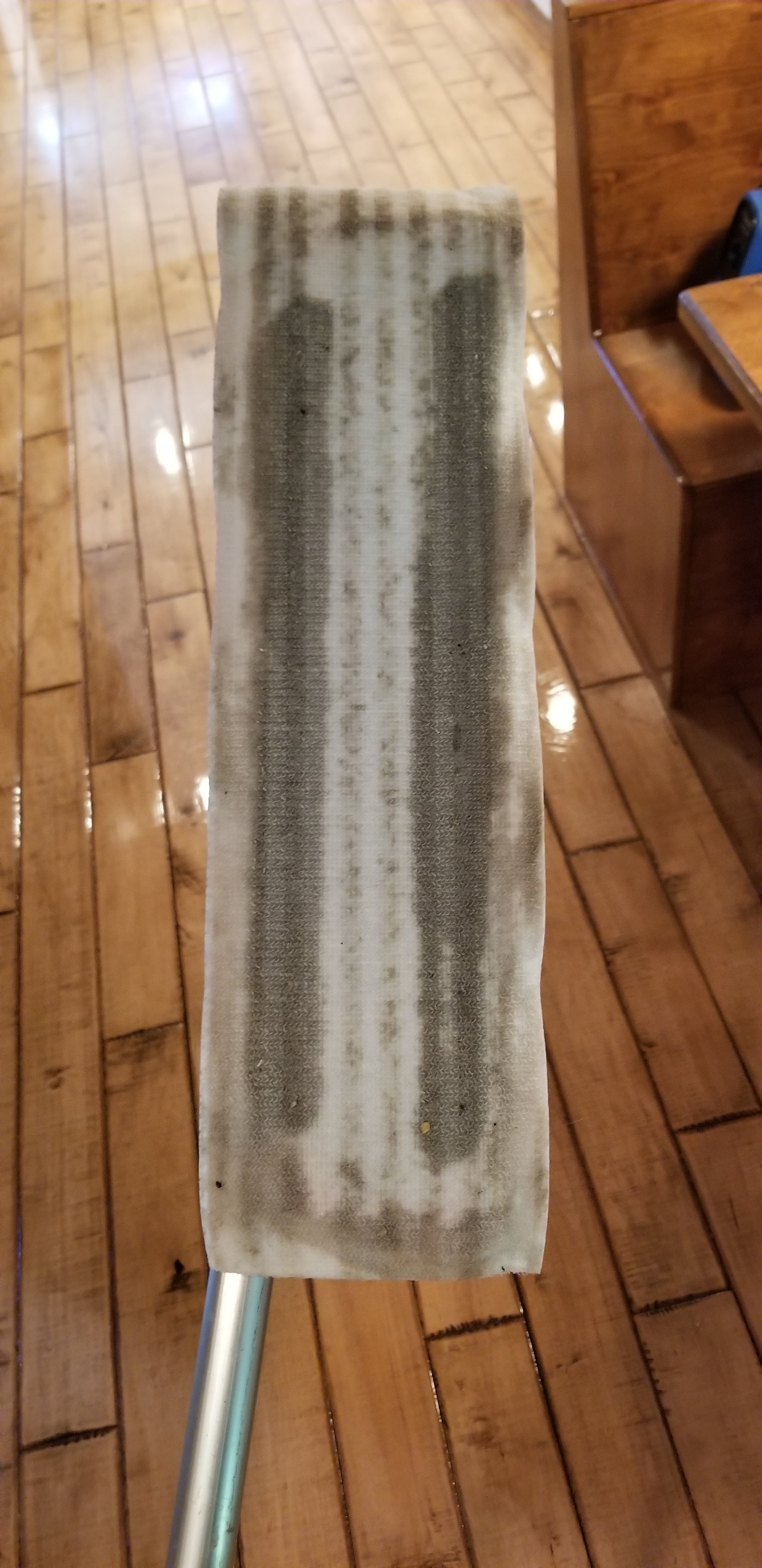

Mop with white Contec Micro
Follow up mop w/blue Micro

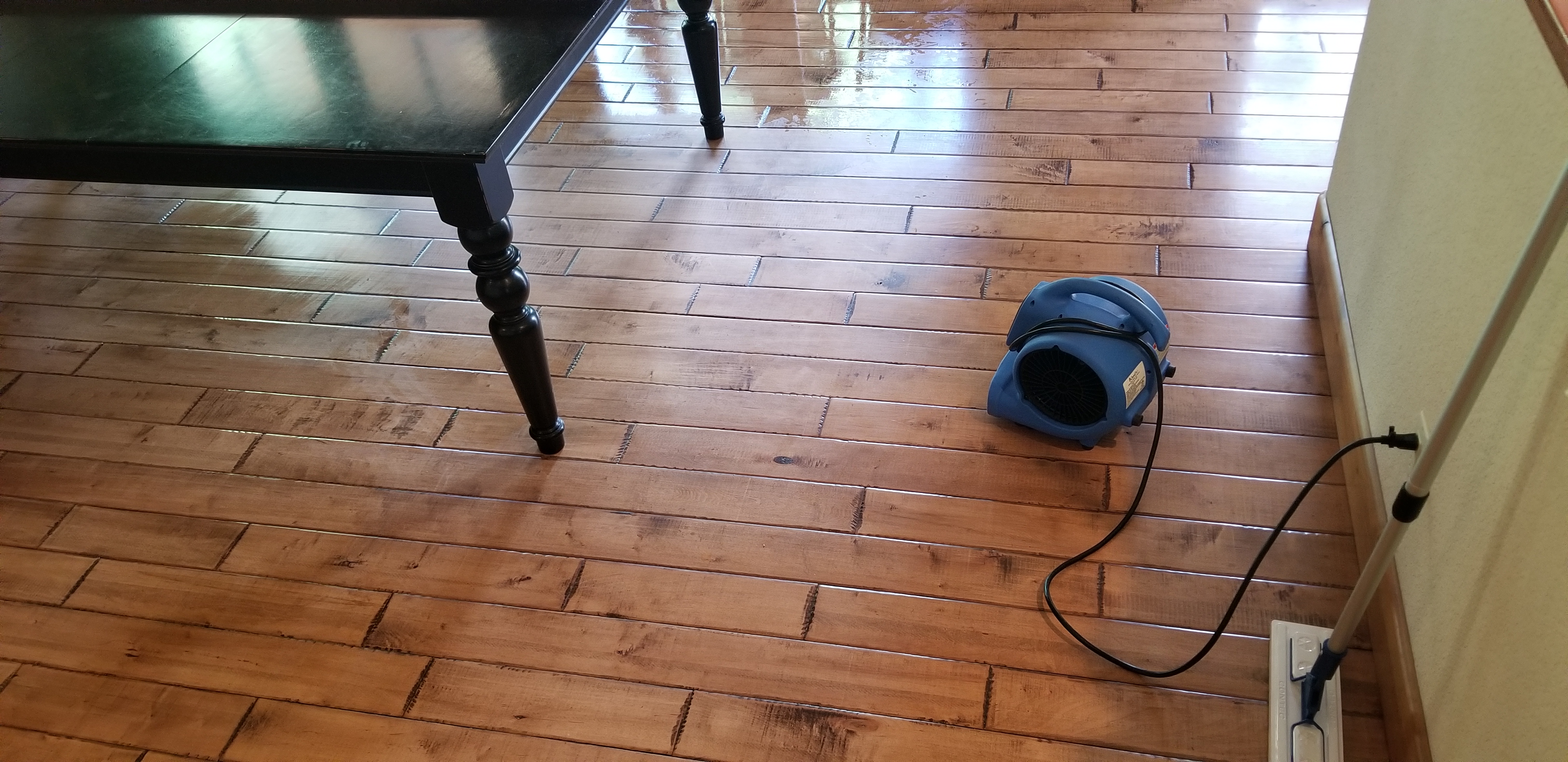

Fan dry
Beautiful!
Virtually no risk
Gets corners and edges
No heavy machines.

the results look good but to me it looks too much like what the home owner can do themselves (gotta put on a show)
I break out the 175 and spray buff away on lightly soiled wood with a white or red pad.
Or mop on a neutral and scrub with a red/green pad, flat mop again and run a brush on the 175 for heavier soiling. And yep edges with old floor pads cut to fit flat mop

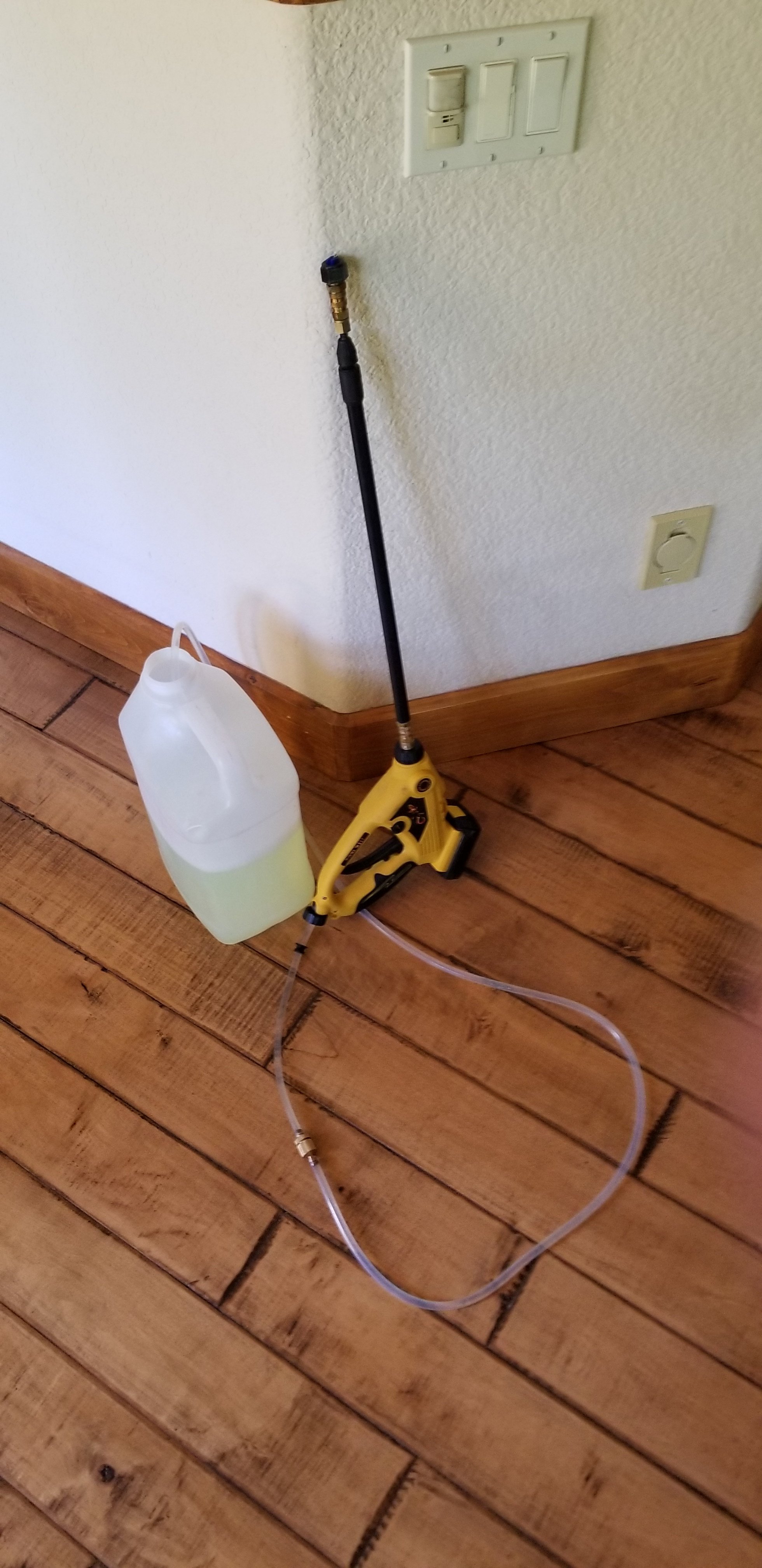

I usually use a HS wand but this floor has big ol gaps in between the slats

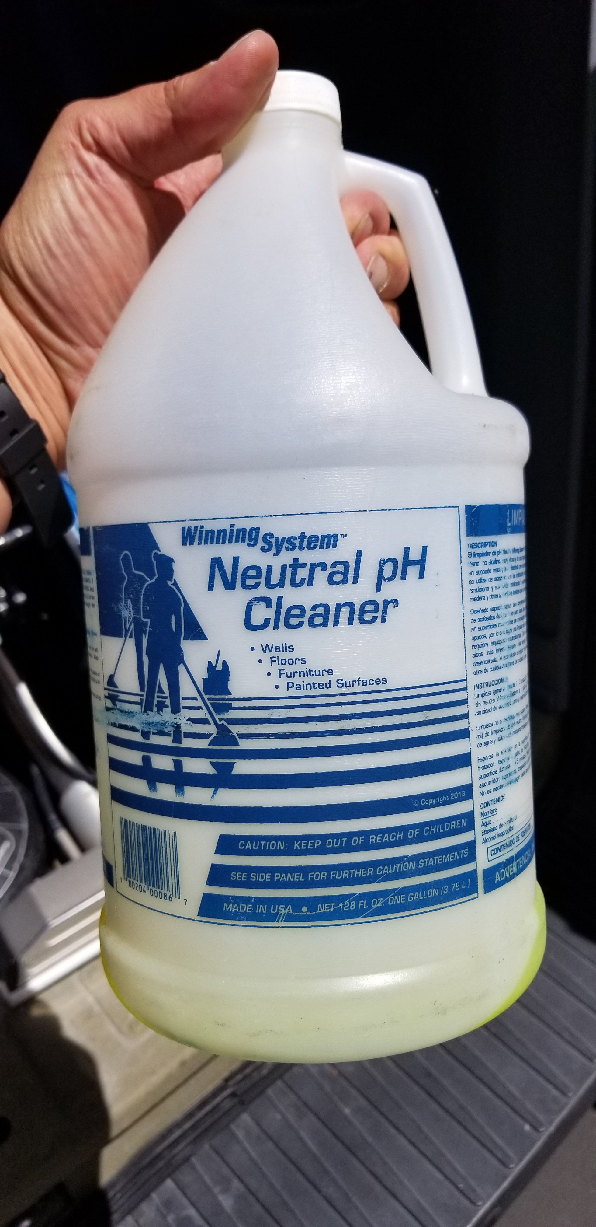

full disclosure I use this https://www.amazon.com/Bona-Professional-Hardwood-Concentrate-Formally/dp/B00CBYAAL2?th=1
and at the same time keep a RTU jug from home depot on board. When you mix from concentrate it's the same color as the RTU
from the store, just a whole lot cheaper $4/gal vs $20ish/gal. I like to hammer home with customers who don't know sh.. about
keeping their flooring clean. This way I can point to the jug, point to the store and they've got no excuses. About half of them
listen to me.

Why Bona?
it's no different than the neutral cleaner that your local janitorial sells and is waaaaaaaaay cheaper. $10 for 144 gallons of RTU
I got a cleaner for $30 a gallon dilute 2 oz to a gallon. Nyco brand. Trying an environment friendly bathroom cleaner too that's $36 for 6 quarts.
