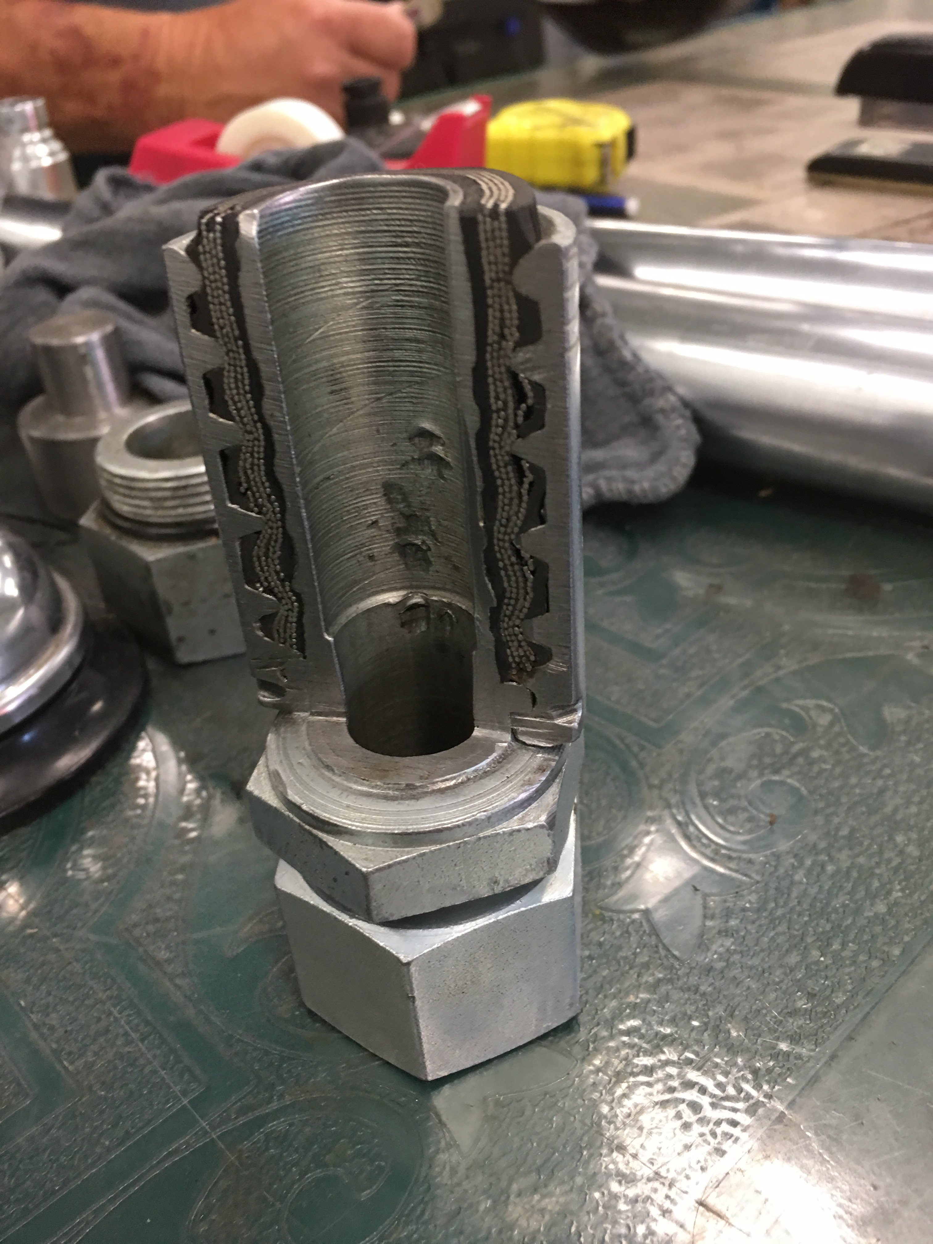

Yup, it happened to me today. My solution line started spraying me with 200 degree water and got hot blackness all over my face , shorts, and carpet. I quickly disconnected my 150’ lead line and went to my remaining 100’. Finished the job and went to the hydrologic shop to get my line repaired. I’ll be ordering new line tonight, but I need this line to keep working until the new stuff comes in.
I don’t think I’ll be ordering the Cobb/Bristor Bubble-Yum line.

Get all plastic hose like Parflex or Cobb's new stuff. No Black Death and no crimp failures yet. I'm confident this type of hose will never Black Death you.

The cobb stuff is the bubble yum line I was talking about. That stuff is garbage. No way. I know three people that have had issues with that stuff.

View attachment 82113 View attachment 82114
shitty kind of crimp too.............
