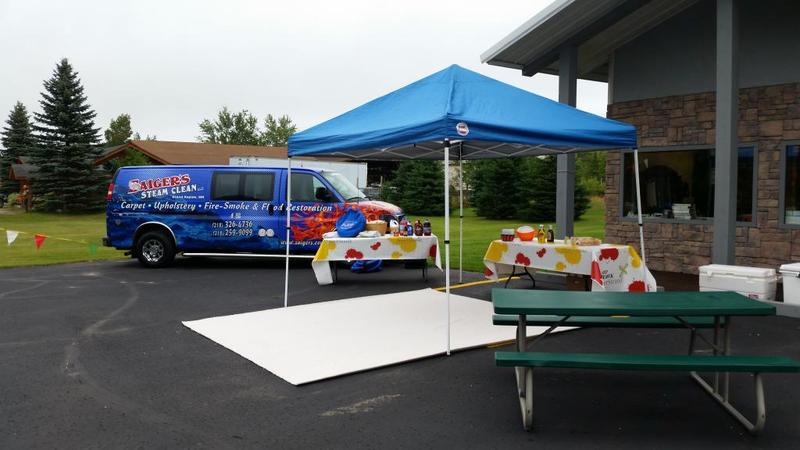

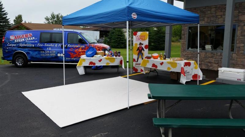

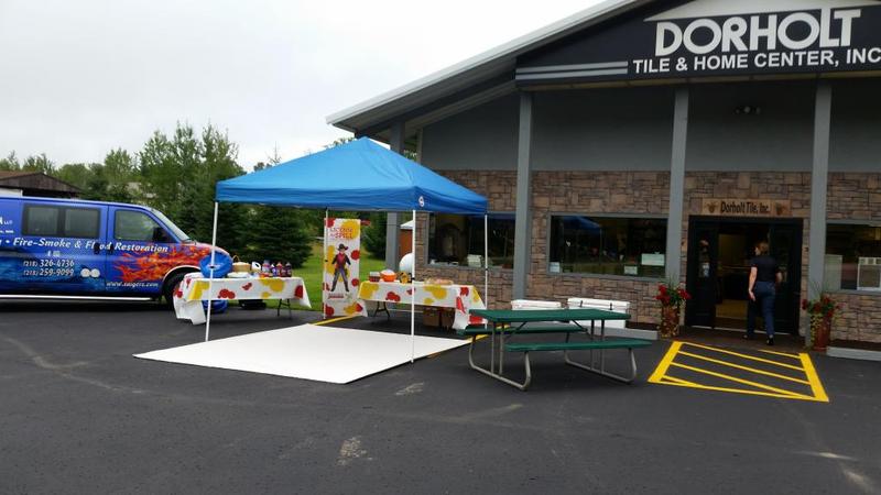

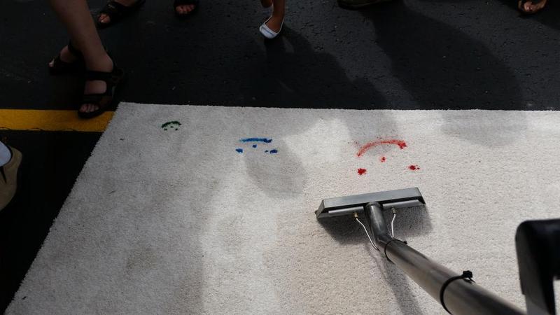

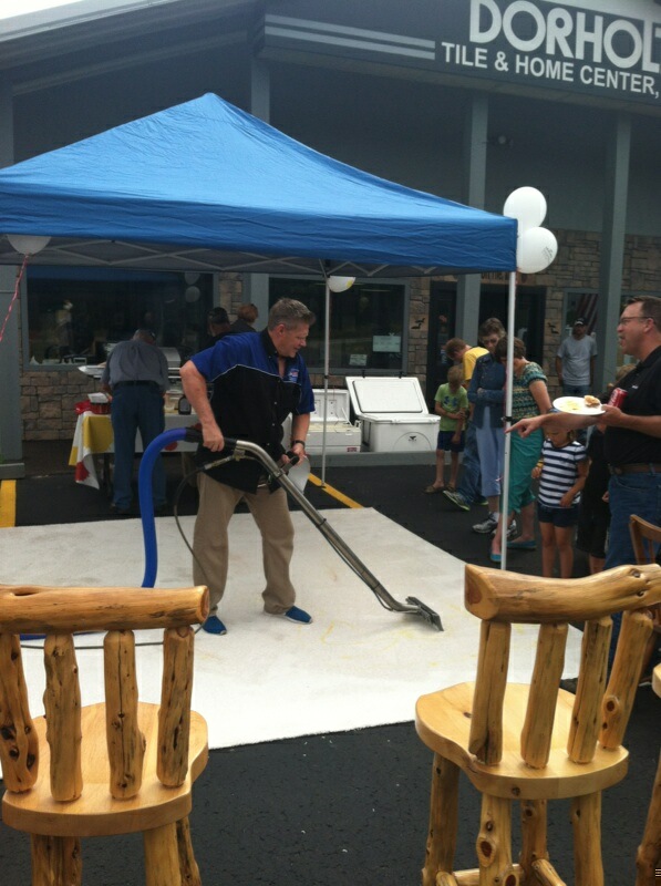

Just did a Mohawk's "License to Spill" Event with one of my local carpet stores.
Had an absolute blast, but boy am I a bit tired!

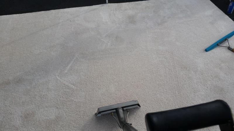

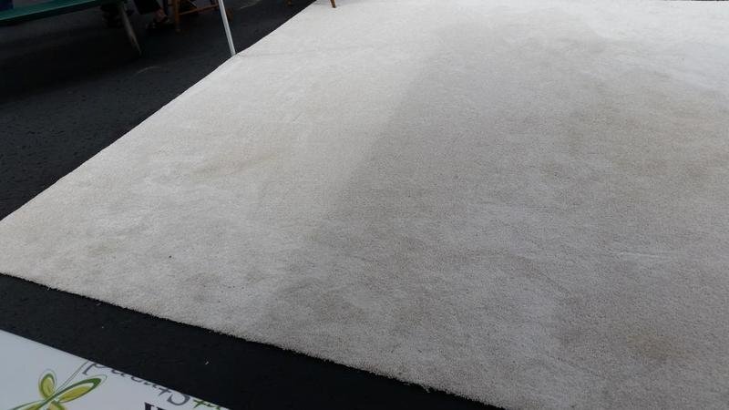

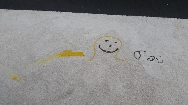

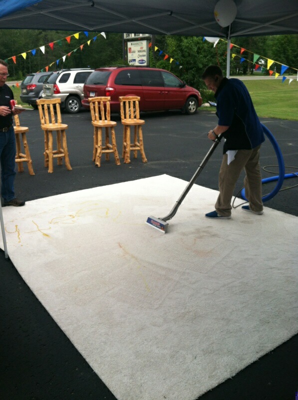

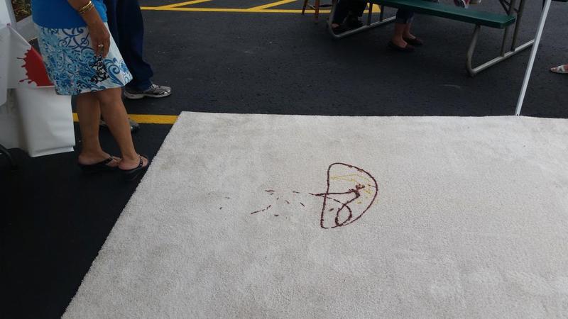

We unfortunately did not get pictures when we got super busy and this white smart strand rug was plastered with ground in Mustard, Ketchup, pure food coloring dye....if there would have been a kitchen sink there....It would have been on the carpet.
It was a great opportunity to show the clients the stain resistance to smart strand, impress people with cleaning knowledge, make connections with your locals, had great conversations with the Mohawk rep....all in all....a WIN-WIN!
It was great to be able to educate the people with how to safely remove stains, spills and problems they encounter at their homes with their NON Smart Strand Carpets.
We did some local Newspaper for a couple of weeks, did some radio spots, even some live radio spots, served free hot dogs and burgers (which the Mohawk Rep paid for). It was a minimal investment for the carpet store and myself.
I do have to say, I am tired though after that day of being up and down removing stains....and if you ever consider doing one of these, get ahold of me so I can share a few more QUICK stain removal techniques that can only be done to the smart strand. (I could be a bit sore from the large commercial carpet, Tile and Grout job I had right after this too :) )

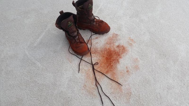

The red in the pics is Iron Ore which is very common around here. Stains a lot of things, but even if not a Smart Strand, we can get that out of other materials.
I booked about 5 jobs the day of the show and yesterday (Saturday) 5 more jobs came in from the event.

Stuck to basic prespray and chems as were to clean in a home. Was using a Alkaline based through the system at the time due to some of the crazy type stains they were constantly throwing at it such as the Iron ore (Normally would have used a neutral cleaner).
I will be honest, when it got crazy busy, I thought I was toast!
It was hard for people to understand that things don't just "POP" right out and I was up and down a lot for spotting.
The honest to goodness magic bullet for the smart strand in this case was just as the Rep said and handed me....diluted bleach and water :eekk:
Not a safe thing to attempt in a home and I would be buying new carpet!
You can do that to a smart strand....BUT...I had to keep running it home to everyone and I mean EVERYONE that you CANNOT....CANNOT use bleach on any other carpet!!!!
I was using all the spot removal tools in the bag and as I told everyone (Including the rep) that we would not use a bleach water even if the
CLIENTS INSISTED it was a smart strand.
I did not fail....but it was a tough challenge.
Permanent Magic Marker (especially Black) did take a bit longer to remove all the properties. Bleach water would not take that and the Rep was very impressed as he watched how we patiently took our time to safely remove that stain and others so not to damage the fibers with heavy agitation.
The thing that was making it tough was they were not just spilling the items on the carpet....they were GRINDING and SMASHING it in!
We seriously showed people how to remove most of the items with dry rags, then a bit of soapy water and basic items they would have at their disposal (Hydrogen Peroxide and time, ect....)

The mustard was tough....
For this "SHOW"....and keep in mind this was a bit of a "Dog and Pony Show" the actually quickest thing to take the mustard out and many other food stains was a bleach water.....
And as I said, you have to ram home that this was only possible on a Smartstrand type carpet.
I was removing stains the traditional way and I explained to many and the rep, we would never use a Bleach Water solution (and he agreed and also said that continuous use could damage it), but the people were also here to see the "Let's get it out fast" Show.
I have had good luck cleaning and removing stains in traditional styles, but I was impressed with how fast a bleach and water solution removed stains so quickly and safely.
The carpet is going to be used again in the future by us....and we were not kind to it at all during this show!

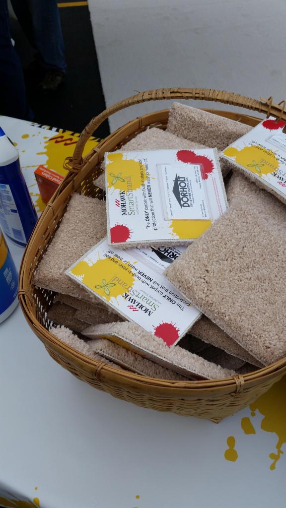

I have not had the chance to experiment with Smart Strand and protectant applications, but it was wild to see what kinds of staining type spills would just roll off the fiber and how some would suddenly penetrate due to different surfactancy properties.
I was surprised at some of the items.
I would really encourage if you had time to get some samples and see for yourself what types of spills just beaded up....and what penetrated fast....
Also, experiment with trying to stain it...
The fiber make up is what makes it stain resistance.....nothing to do with any protectant application...
It is an interesting fiber....and yes, I know it is a poly and not a nylon, but we all have to learn it's properties and try to learn to clean it.

Your wife can't be more than 30. How does an old codger like you get hooked up with a young thing like that?:biggrin:
Well, Actually Willy....the gal in those pics is one of the carpet store owners....LOL!
But my wife does look a bit young too :)
My wife is on the far Right and these are her 3 daughters.
Figured I better point her out so someone doesn't think I was "really robbing the cradle" :)
