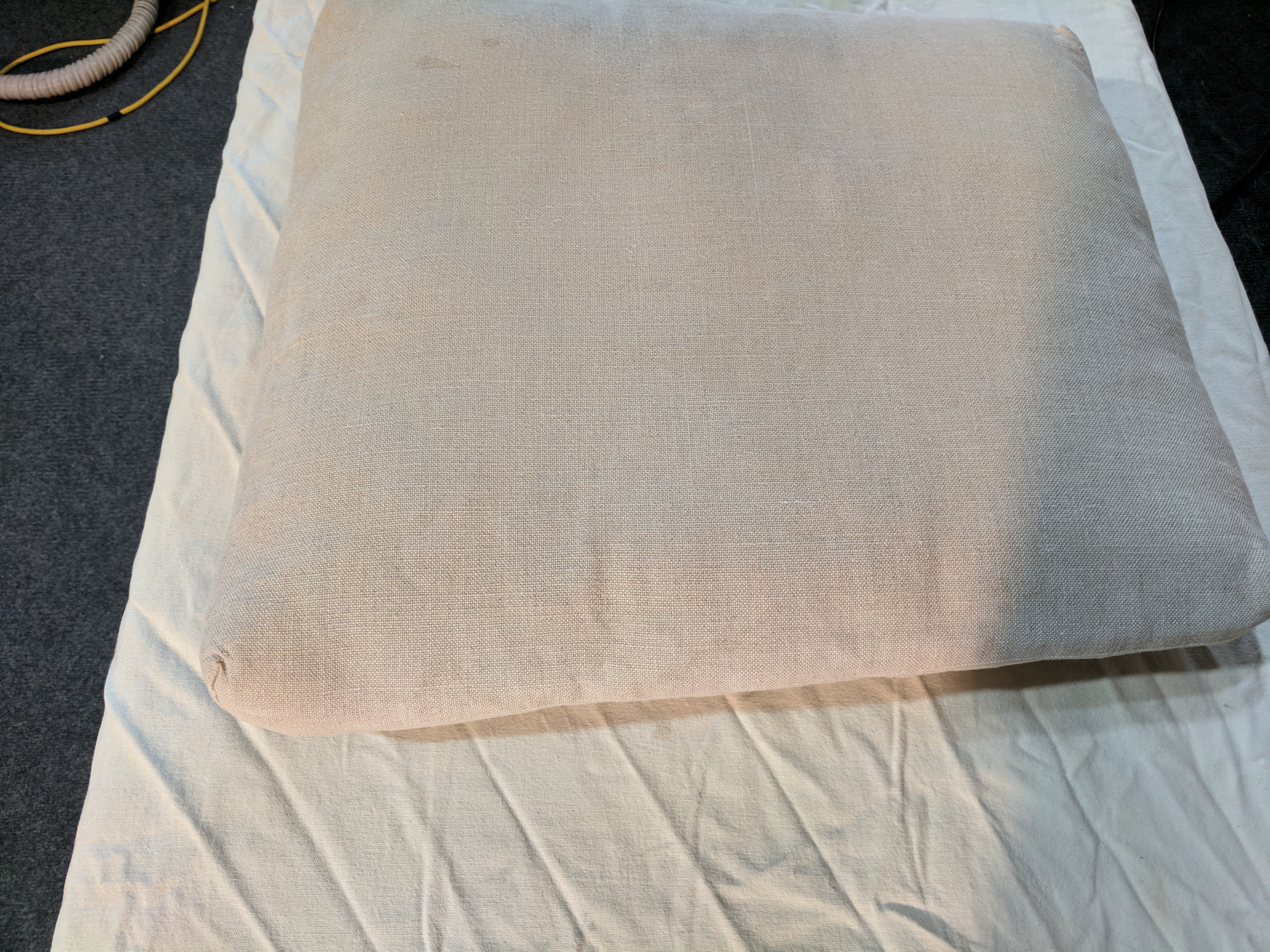

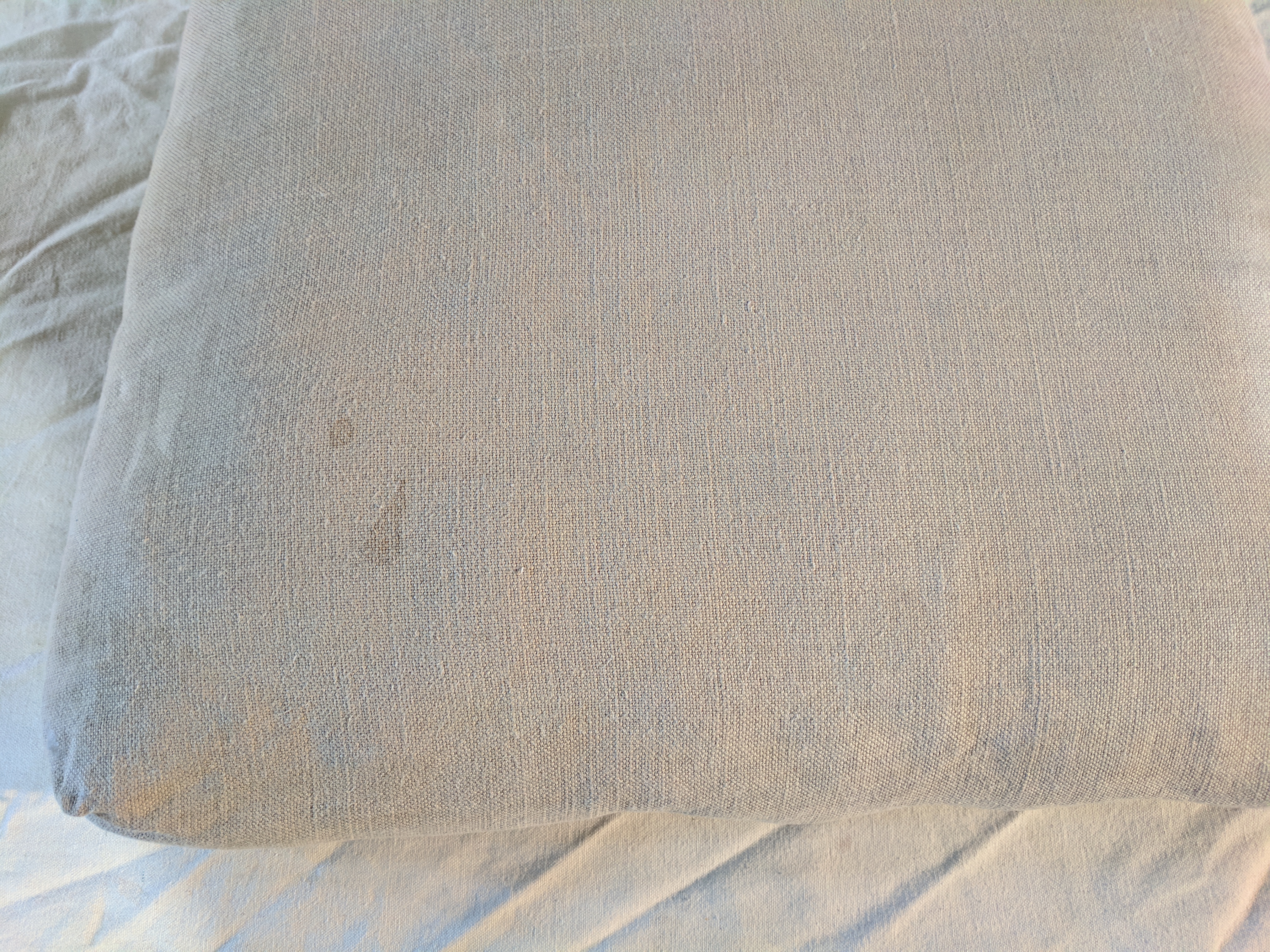

I recleaned this linen cushion in the shop today. Has 2 small stains from a spill that's not coming out without the use of oxidizers or reducers. I will leave those for further experiments. There was a little water marking on the bottom half from me letting it sit on a damp table. Not really visible in the pics. I misted with a little distilled water (thanks to Jim Pemberton) and that took it out. Presprayed with Prochems fine fabric prespray, scrubbed it in and rinsed with Prochems axiom extraction. Dried it with a fan. No visible damage from cleaning. Treated it with Maxim advanced upholstery protector (water based) will let it dry overnight before testing. Most important thing in cleaning fine fabrics, in my opinion, is not overwetting but underdrying. You have to get it wet to clean thoroughly. Do numerous dry passes and bring fans. Towel dry with absorbent towels. Pay attention to the corners, edges and piping. These are harder to get dry. I really don't like doing delicate upholstery but there is good money in it. Last week I did a linen dining room chair for $150. Today I did another one for the same family, same price. Persuaded them it would be a good idea to have some protector applied. Scheduled them for next week, right after I treat a linen sofa.

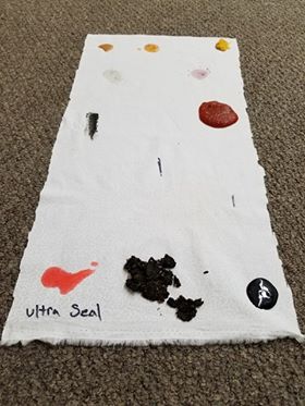

High end cleaner on Facebook is testing several water & solvent-based protectors against 12 staining materials.
This was his response to me on our Ultraseal solvent protector on the cotton fabric sample.
"Cotton results...(awesome as most upholstery is cotton and your product is killing it)"
Cotton.jpg This was after an hour of dwell time.
He will clean after a week to get the final results.

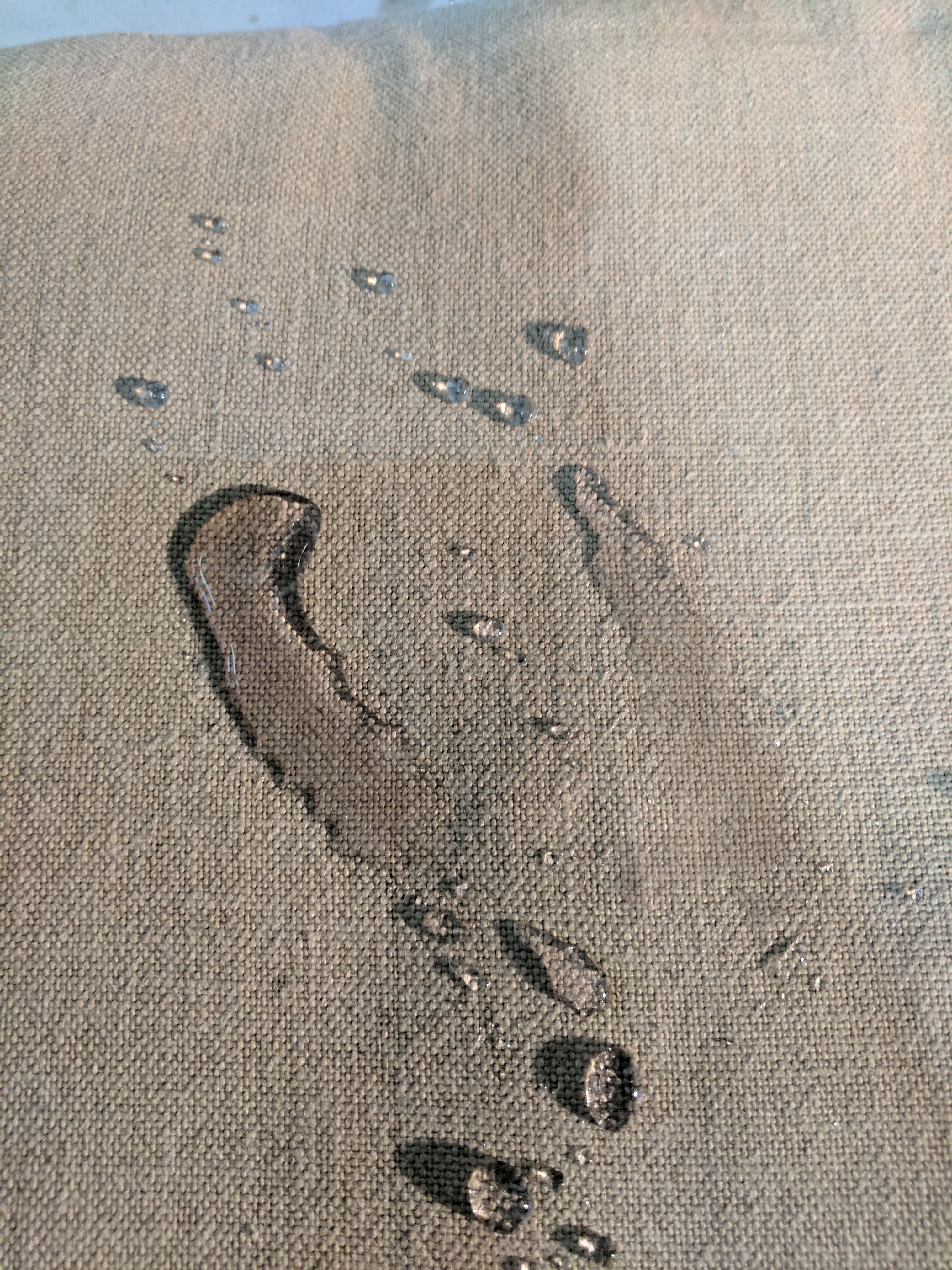

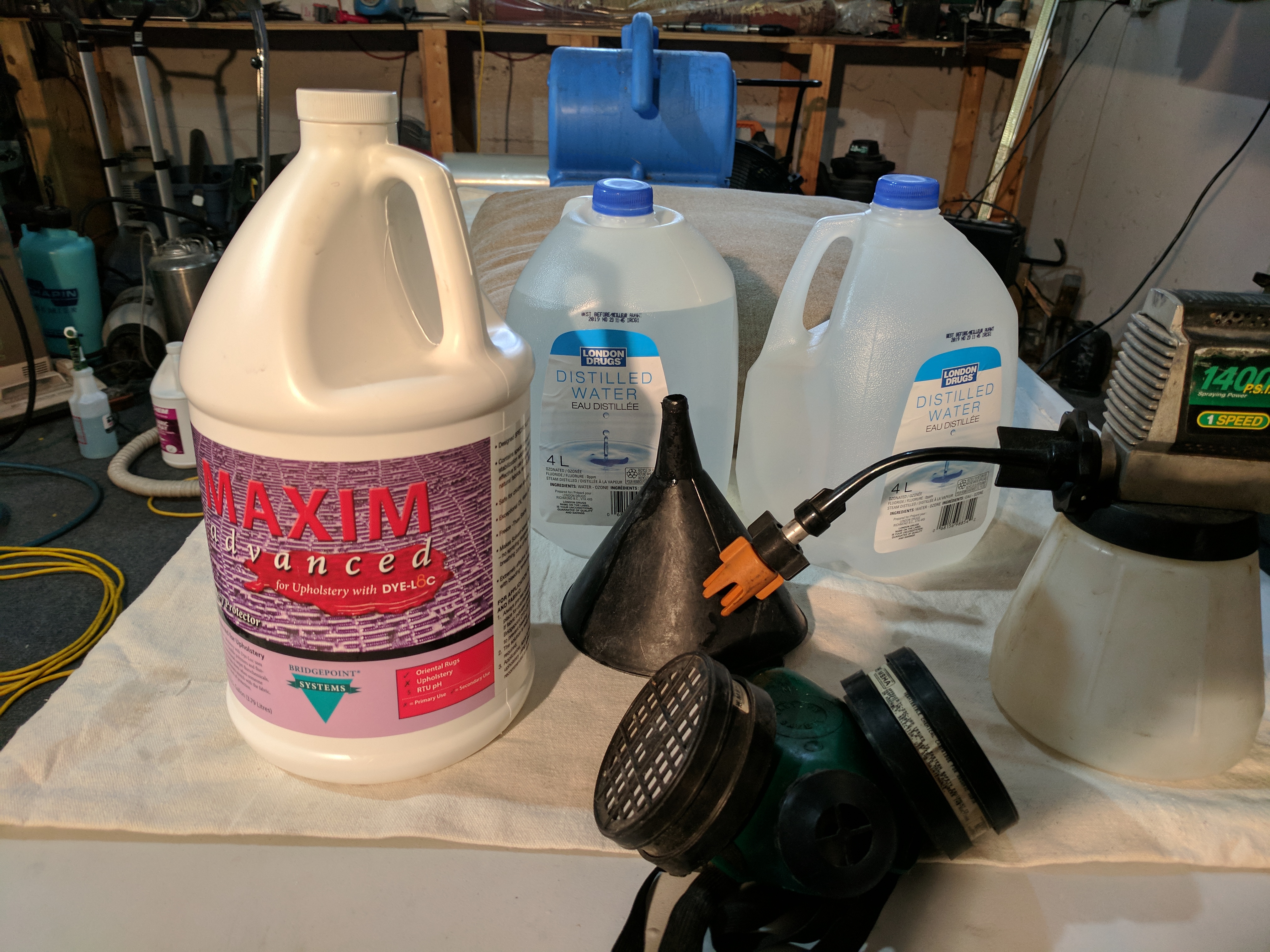

And here is the proof that the product works. You will see a small purple dot in the middle. Obviously not enough protector applied. I cleaned it and it cleaned right out. The test solution was grape koolaid. If my name was Mark, I'd make a video. Maxim guys, you know where to send the cheque.

looks like you browned out the center. :shifty:
Linen darkens when wet.
I remember when I cleaned my first linen chair; it turned so dark and I cheerfully assured the panicking lady that it would dry just fine while I sweated bullets till the dryers saved the day.
I haven't cleaned for a paycheck for over 40 years, but those moments still come back like nightmares

Definitely browned it!! He's from BC ain't he?
Ron, that only proves that it causes liquids to bead. The proof is what happens when a liquid breaks that surface tension, how much dye protection it provides, how well it helps remove oily substances (prevent bonding) and how long it lasts.
