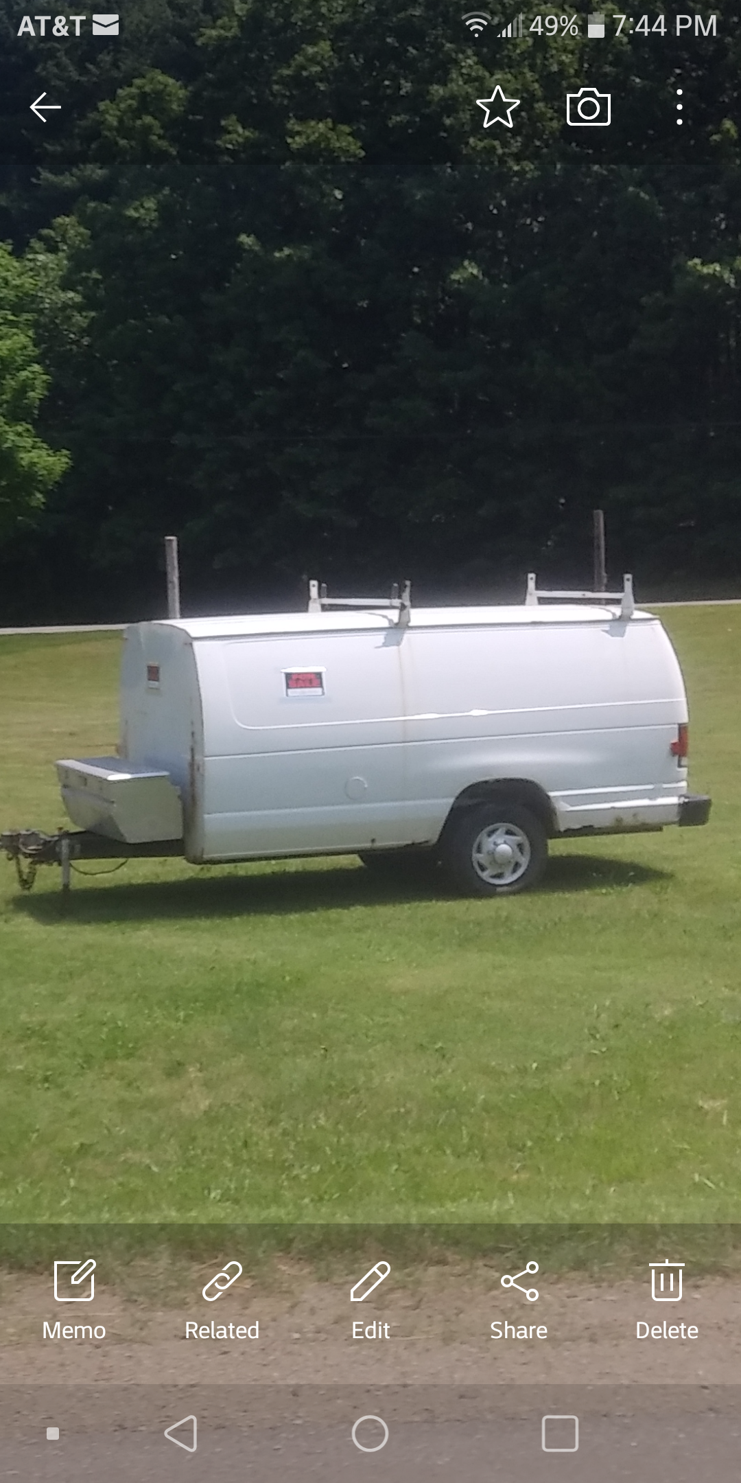

Matt Wood's tips for the un-prepared trailer dufus.
14,136
Georgia
I think there's too much weight loaded in the back of the trailer with the combination of going too fast
Reactions: Dolly Llama
Matt got it
(not so much speed, as loaded wrong)
not enough weight in the front of the trailer.
rule of thumb is 10% of gross wt should be tongue wt on the ball
meaning if trailer and load is 5000 pounds, should be minimum 500 pounds on the ball hitch
