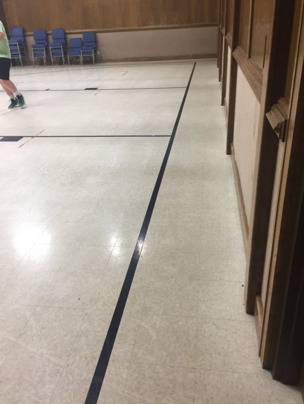

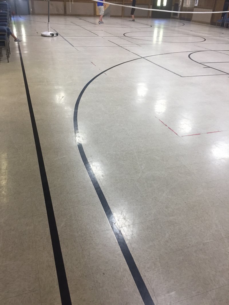

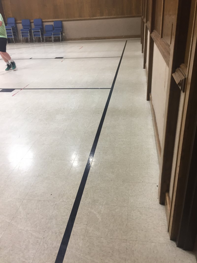

IMG_2558.JPG IMG_2559.JPG I clean for a church and they love me and asked if I could do anything for their gym. It's not in great shape.
I've done a small office of vct and it ended up looking really nice when I was done.
I used a 175 and black pads then I cleaned it real well with my truckmount. I hated getting all the stripper and old finish in my truckmount but the mop and bucket just wasn't working well and taking forever.
What do you guys use to clean up all the stripper and old finish? I have an old portable I could use.
Anyways I wouldn't normally do this but it's in such bad shape I think I could at least make it look better than it is. And it could end up being a good learning experience and maybe start offering it as a service.
Anyways, as usual any help would be appreciated. Thanks

You started off right with the 175 and black pad in the office.
I prefer a cheapie wet vac from cleanfreak.com to collect the slurry. Don't gunk up your expensive tm.
A floor that size will need a big squeegee and a helper.
Maybe an autoscrubber could retrieve slurry?? It might be worth renting one.
Don't be shy with the stripper and rinse WELL before applying finish.
After the floor looks really good...put 1 more coat of finish on.
A floor like that would make for a very long day for a helper and I.

Rent an autoscrubber. Doing that with a 175 and vac would be miserable. It is possible, but a huge waste of time. Rent a 26-30in autoscrubber. Put stripper down with mop and bucket in manageable areas. Let it dwell. Don't get in too much of a hurry. Give it time to work. Then scrub it once with black pads and squeegee up, not collecting. Then the second go around scrub and vacuum it with the autoscrubber. You will learn the tricks from there. Use a flat microfiber mop to apply the wax.
