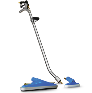

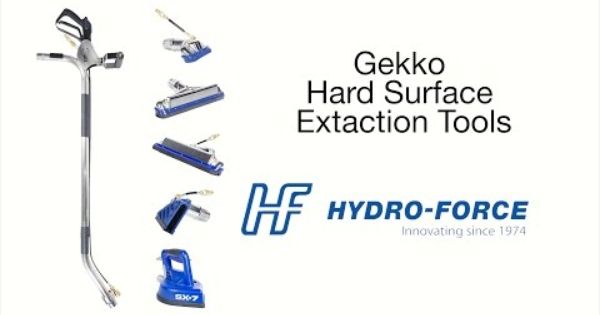

TurboForce Gecko
Sloppy swivel, odd tube angles, poor water recovery due to internal manifold, personally not a fan on pressure washing gun triggers
PMF tool
Poor recovery due to internal manifold, streaks soft surfaces, I prefer the 12" head over all the other's 14". High priced due to American made. S bend available as well as a 2" tube.
Interlink/Hydraforce Gekoe
Lots of head options. Sloppy swivel, 14" head is too big to be swiveling. Like taking a blind dog for a walk. Grip makes it hard to use for anyone but very tall operators. Nice brush assemble, keep water better contained than others
Westpack
14" head is hard to control, brush ring lets out too much water, sloppy swivel. External manifold allow for slightly better recovery, cheapest of the bunch though.
Dream wand.
Head shaped like a PMF stair tool, triangulated with a thin screamer air flow chamber, Tom swivel, External jet manifold within a heat and splash guard shield, tight and short brush ring. Probably would not need to be a 2" tube.
In the mean time a Bonzer type glide on a 12" Tom wand would probably be the cats meow.

TurboForce Gecko
PMF tool
Westpack
Dream wand.

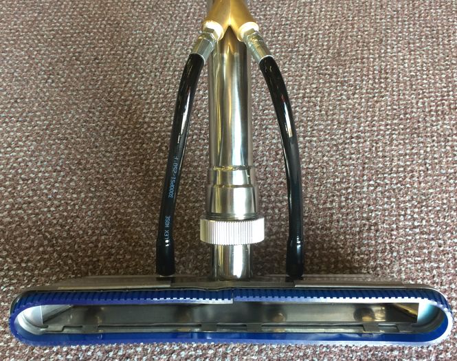

The new Westpak 14" hard-surface is different from the older one Mikey showed above:
WestPak Easy-touch valve. I think it performs pretty well.
http://www.cobbcarpet.com/zen/index.php?main_page=product_info&cPath=76&products_id=5509
