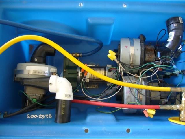

What do you think of these
The new Cat pump is very good. It has a lot of features like the piston connecting rods. They create a very smoothe operation, with out vibration like the solid single piece piston arrangement like the old Hypro.
As far as a Machine to use as you describe, the Speedster 1005 for $1999.00, I think is the way to go. Sold thru local distributors it's by far the most distributor supported extractor out there. Dual 3 stage vacs (144"/ 230 cfm) 500 psi Cat Pump, 50' detachable power cords and 2" vac inlet. 12" wheels and 5" ball bearing casters for ease of mobility.

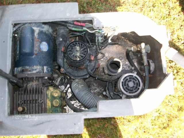

My burned up golden oldy Ninja - awesome vac and a great pump.This was the second one in the shell and the base had to be reinforced with a thicker gauge sheet of metal. 140 pounds, I'm glad I'm stronger than the average bear.
With another set of 2 two stage vacs ported on the opposite side of the lid. Both sets were in series, but the way the lid was ported, it ran the 2 sets as a parallel system.
General one one cord with low amp 2 stage and a higher performance 2 stage on the other cord. Same vac set up in the booster box, but that ran on one cord.

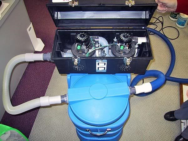

Borrowed this pic from Ted at Kleenkwip where I swapped an old PB Ultimate for the vac booster.

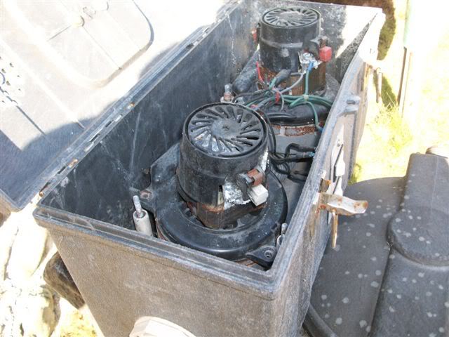

My toasted booster. I lost over 18 k on that fire. Van loaded to the brim with equipment. I got $3000 from insurance.
Upside- Plenty of flow and massive vacuum at my normal 35 feet and it could have easily run 100 with enough power. Performance second to none. The pump lasted through 6 sets of vac motors.
Downside. - Heavy, had to replace the rear wheels and axles a lot, had to be refilled once to do a 1 bedroom. 3 cords, but I had that figured out.
