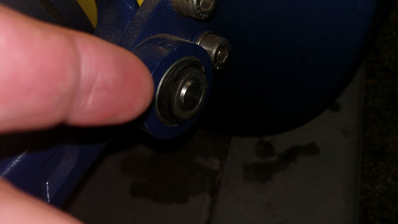

What's the dilution rate on DS1?
And how do I keep this sleeve from continuously falling out?

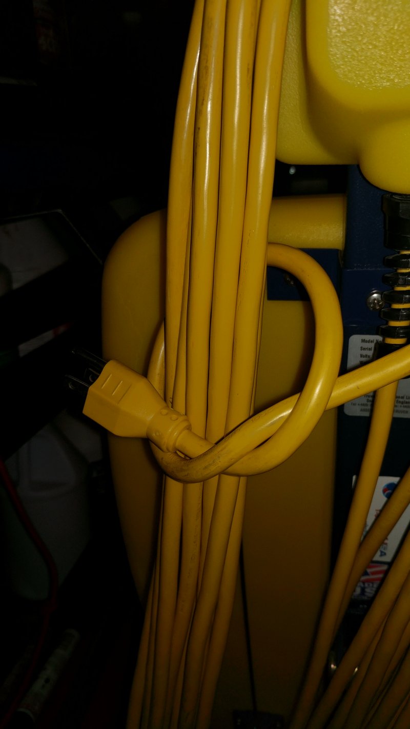

And while I'm in a bitch mood, tell Cimex to put a cord clip on the prong end for cripes sakes...

Dilution on Encap-1 is the same as Encap-Clean DS2 - 4 oz per gallon.
If the bearing sleeve is popping out of the pivot arm assembly, it's because the yellow shroud has become bent/deformed. The shroud gets bent when the head is banged/slammed upward. It's important to lift the head with care when transporting the machine. The weight of the motor can bash the yellow shroud into the blue forks of the machine with pretty strong pressure, so it's important to try to minimize the force when you pivot the head upward. Being cautious when pivoting the head of the machine upward can help prevent the shroud from becoming distorted. To fix the problem, you'll need to be bend the shroud back straight again (reshape/straighten the shroud). And the pivot arm assembly will need to be replaced.

By the way Mike, Cimex has now beefed up the shroud. The newer machines, as well as the replacement shrouds, seem to be holding up better than the old ones. The older style shroud was thinner and it was easier for it to bend/deform; which would cause the pivot bracket bearings to pop out. It may be worthwhile for you to replace the shroud and pivot brackets when you get a chance. That will sort things out for you.
116,456
Rick there is no damage to the shroud or anything else, the rubber coated bearing sleeve just wiggles itself out on occasion.
Is a glue or epoxy the answer?
