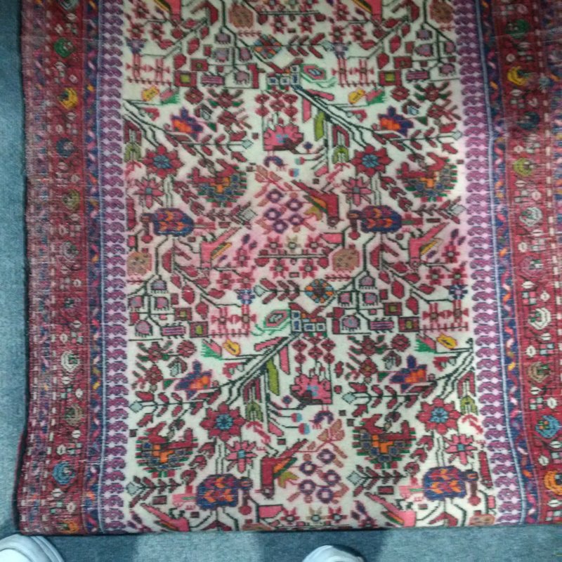

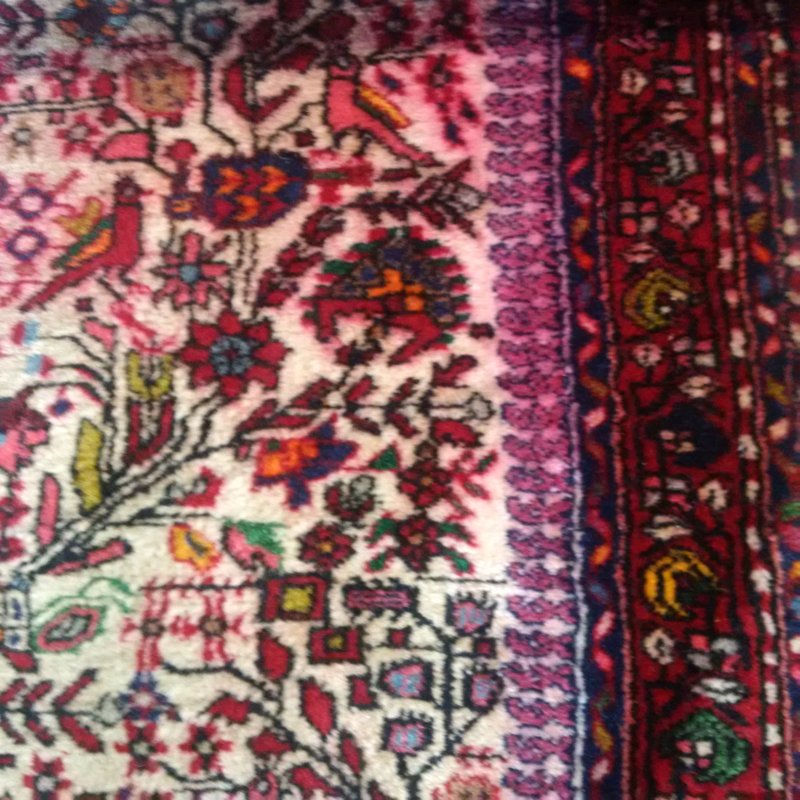

Here is an example of a runner that came into the shop recently. I don't know what happened to it, could be water damage or improper cleaning. The customer knows the rug is damaged and doesn't expect to have it corrected, just cleaned. If I could correct for a reasonable price, I am sure the customer would say go ahead. How would correct this type of dye bleed?

Your specimen is fixable.
If you could roll back the clock and had the chance to wash this rug before it looked this way, would process should be used to manage a safe and effective wash? Part of the answer to consider is what is it made of and what happened to it to get these unsatisfactory current results?

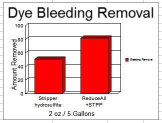

I am proposing a shift from old school Sodium Hydrosulfite to our ReduceAll powder.
Besides being more effective, it doesn't yellow the wool, which saves an extra step.

Sodium Hydrosulfite is inhibited by alkaline pH cleaning detergents.
ReduceAll works best at an alkaline pH of 9 (good for washing) .
The combo of ReduceAll and a Dye Transfer Inhibitor will make the process more trouble-free,
and BRIGHTEN all the colors in the rug.
