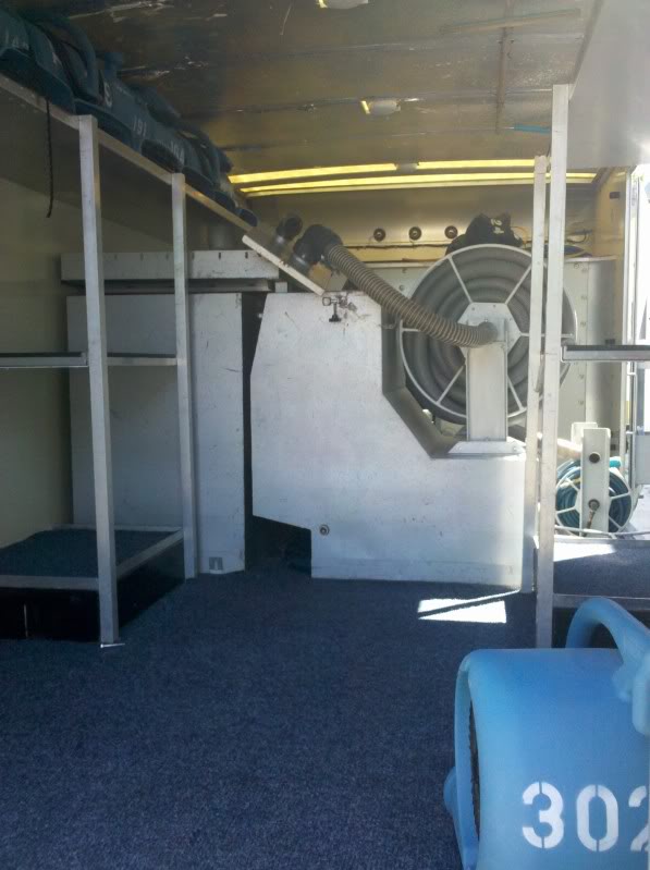

You don't have to run the reel live and I do like the set up due to ease of setting up on the job site. I have found the way mine is set up with a "Y" splitter and behind the reel and the hose split into 25 foot sections to work quite well for us. I also have the 2.5 inch hose reel set up. My family has had great luck with our Butlers and we run them a lot and also have put a lot of hours and miles on Butlers.
Take a look at this post and see some pics of my set up....just scroll down a ways to see pics.
http://mikeysboard.com/forum/showth...um-hose-swivel-for-reel&highlight=Mark+Saiger
