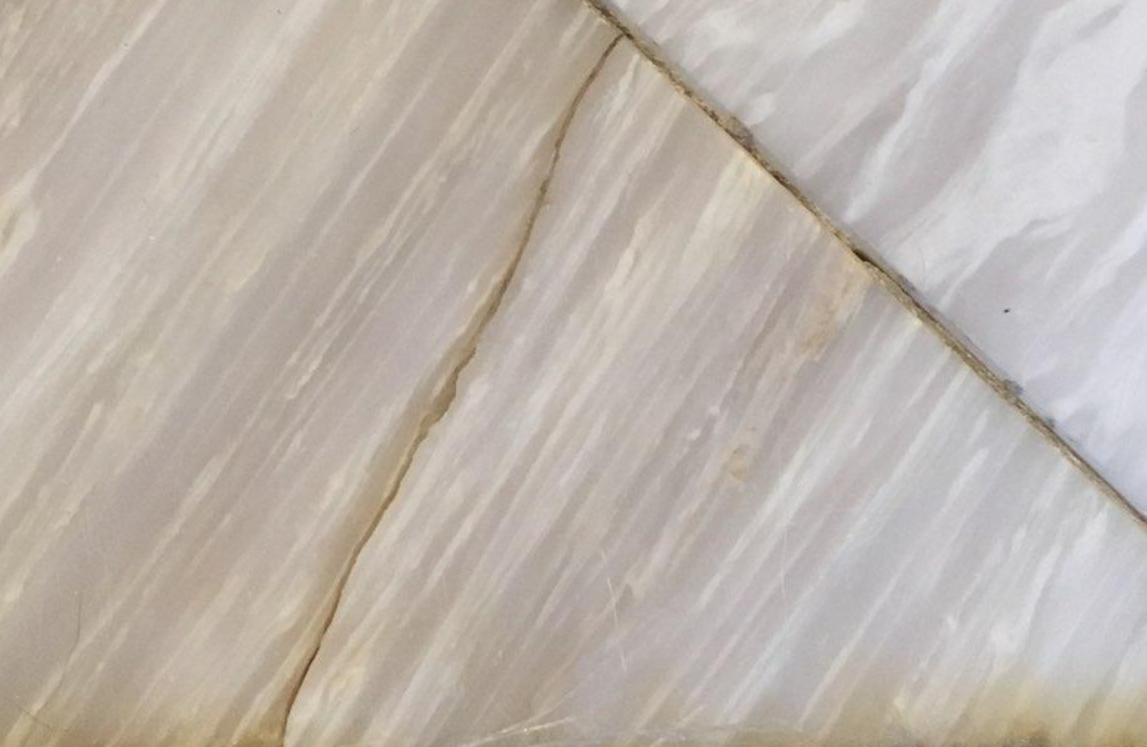

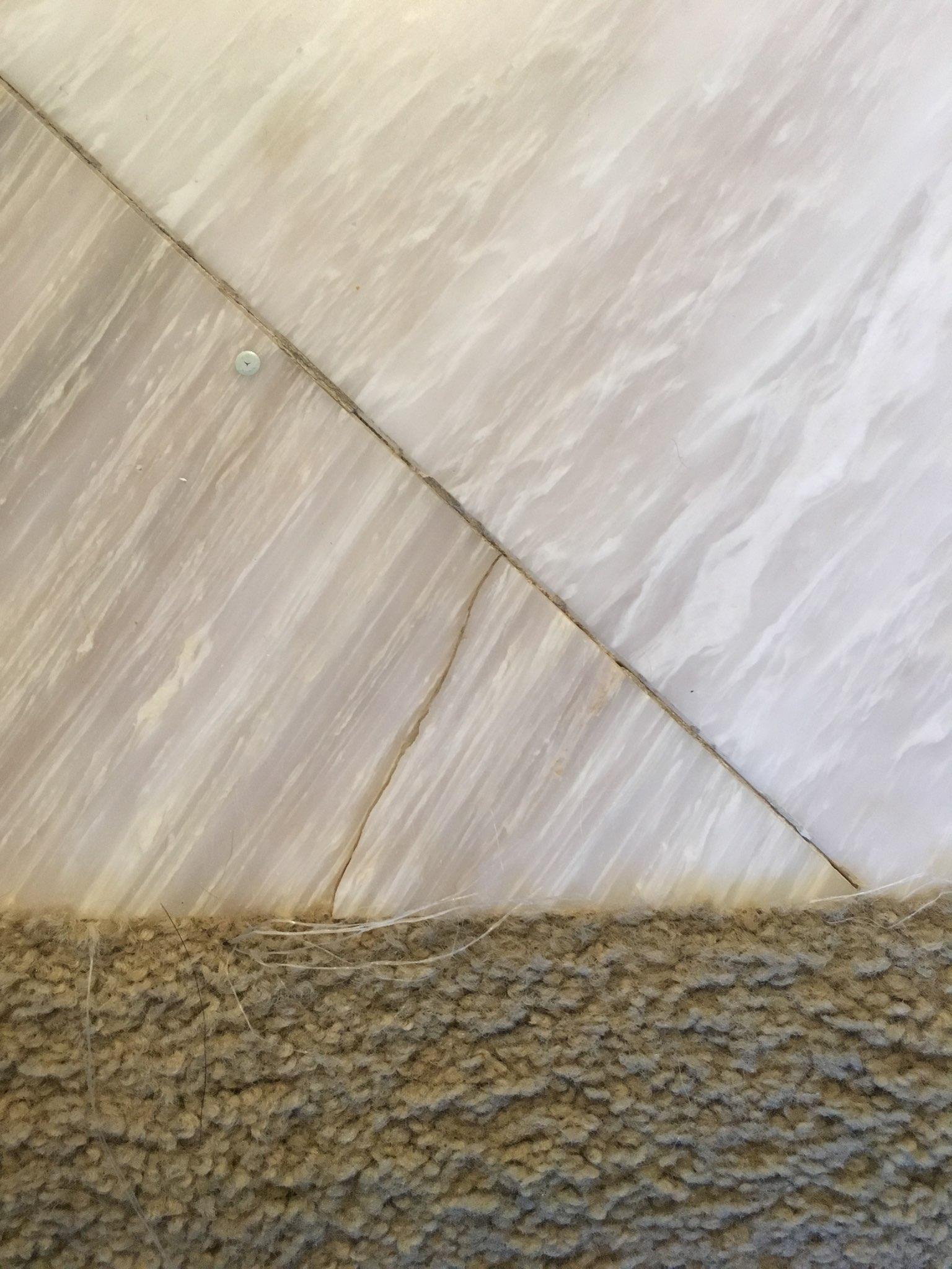

Customer says we cracked her marble while cleaning the carpet...
Does that look like a recent development?...lol
If the tech whould have trimmed the backing, she would never have noticed IMG958789.jpg IMG958788.jpg

Looks old. Explain that you cover any damage you cause and if it were something your guys did you would. However that is preexisting and you can't be responsible for something you didn't do.

What is the small little round thing on the end of the one piece?
And if it just happened the crack would have a clean whitish hue.
Those pieces have been flexing for a long time judging from all the missing filler.

“ ma’am there is filler between that crack, no idea when it was damaged but we did not do it “
She genuinely may believe you did it but after a logical explanation that it was not recent based on the visual evidence she still thinks you’re responsible then she’s a Marty

Unless you've got super heavy techs, it's the installers fault for not having proper support even if you guys did break it. But, I agree that it does not look like new damage.
