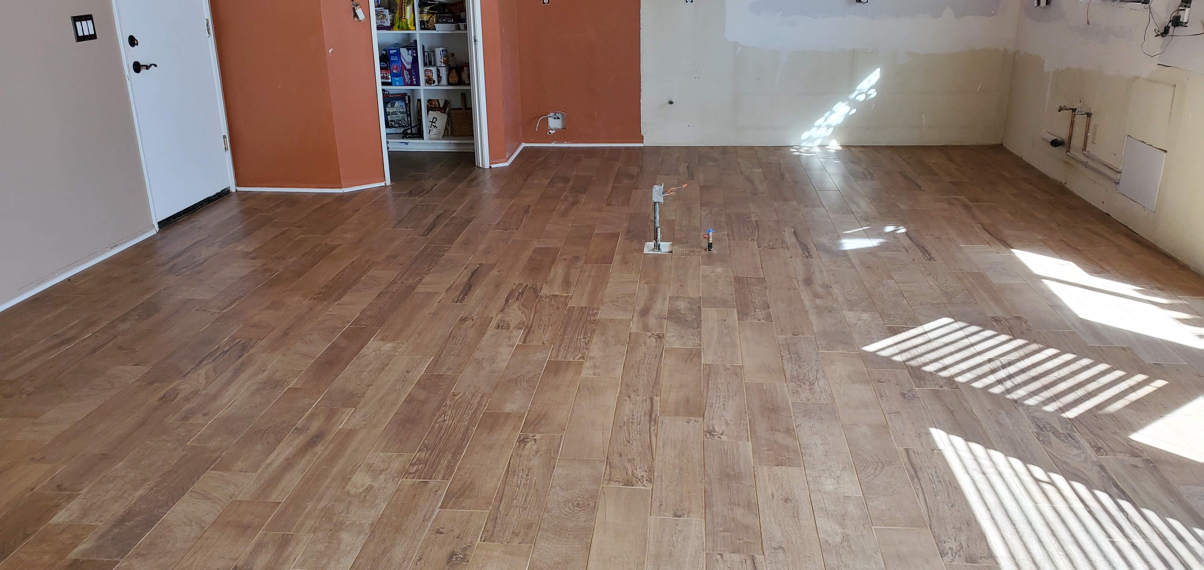

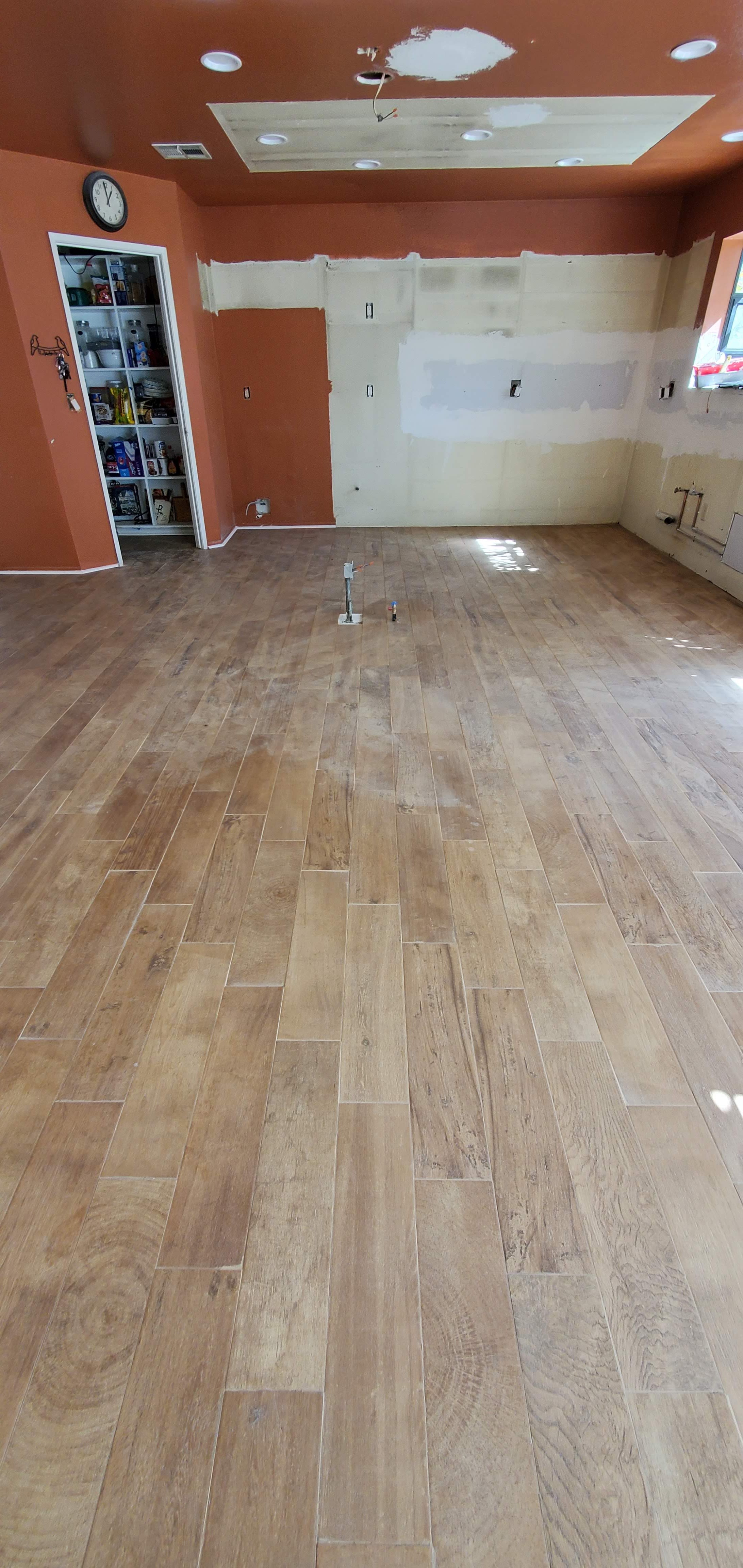

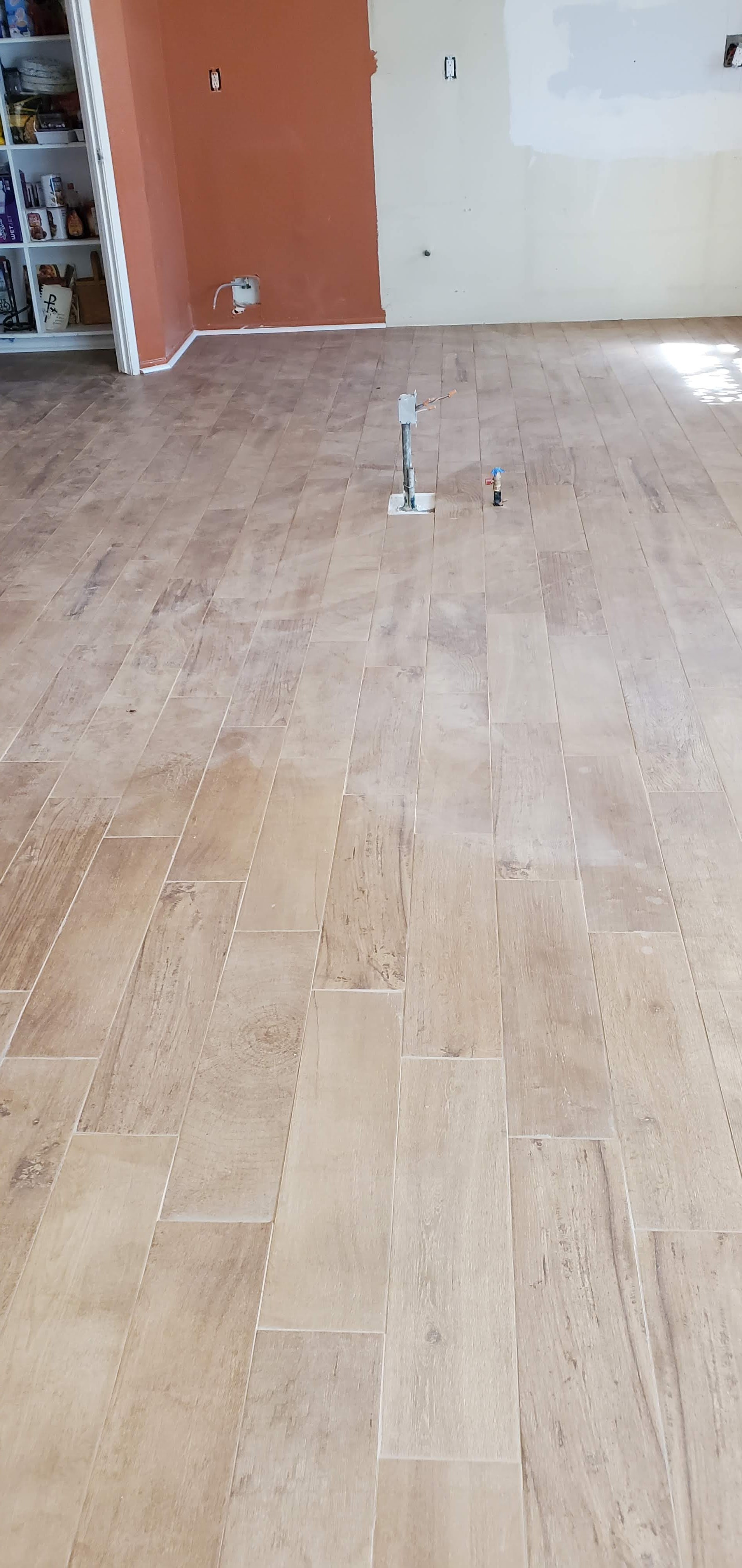

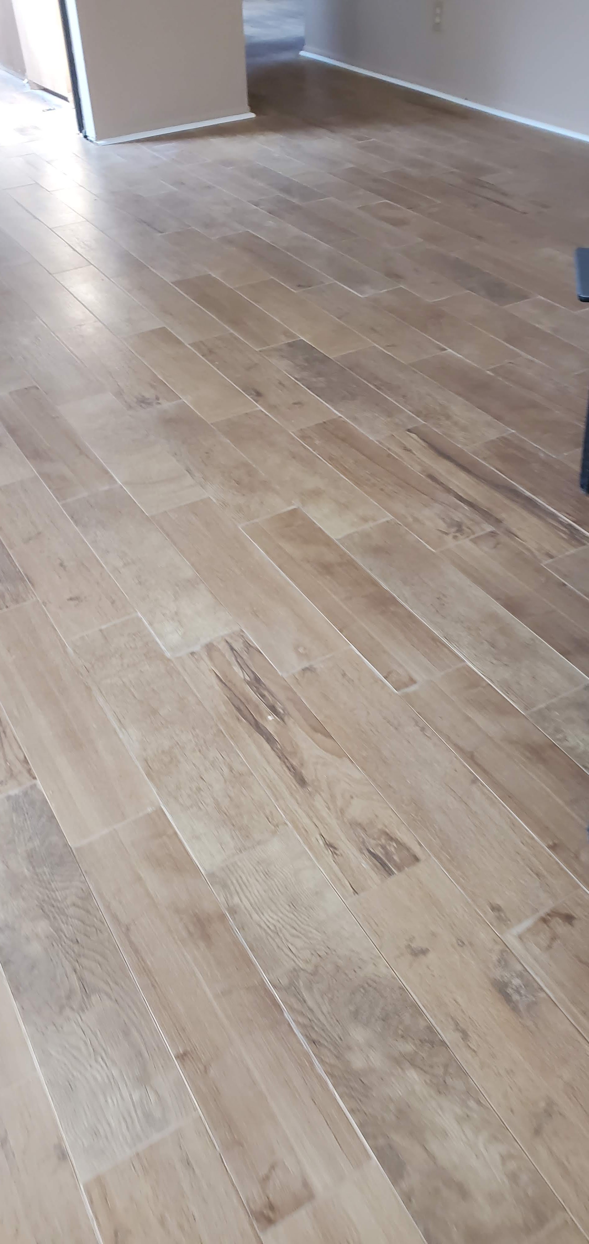

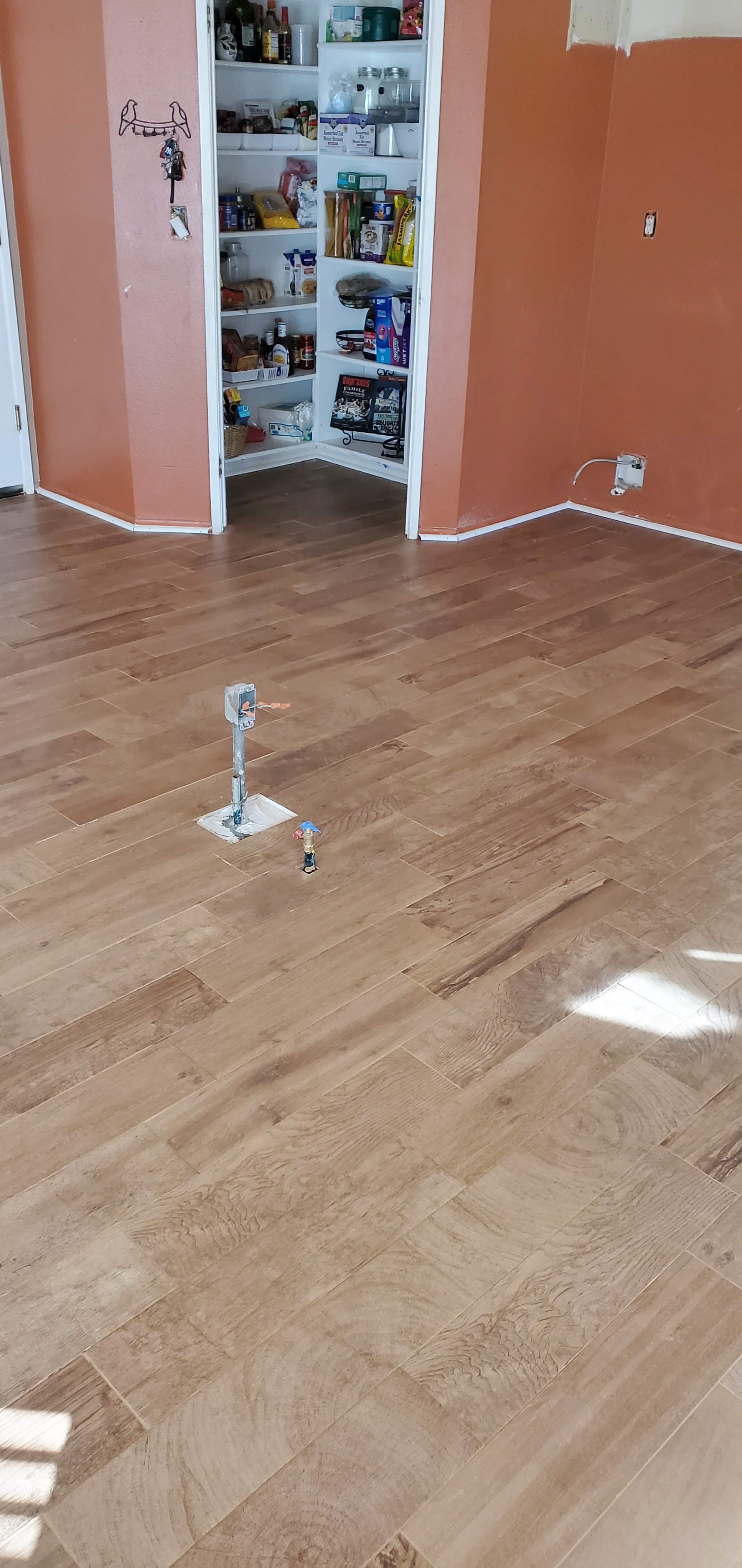

Did a job grout haze removal...
Installer left it like this.
Said he couldn't do anymore.
Well alot of the grout blew out of the grout lines.
And it was a total mess.
$12,000 installed and it probably needs to be ripped out and redone.
I was able to pull alot of it off with a acid, black pad ,and spinner at 1200psi.
But the fact you don't wipe up as you go leaves a huge mess.
