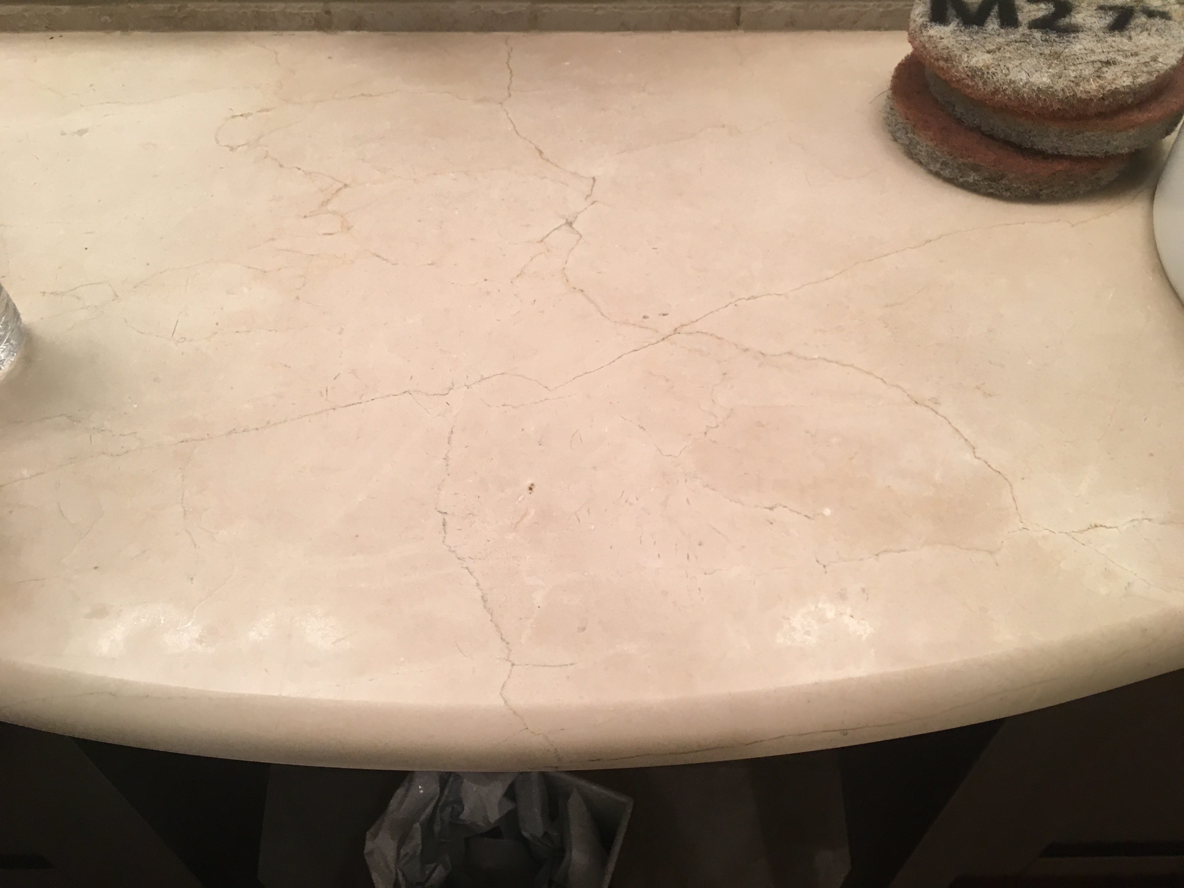

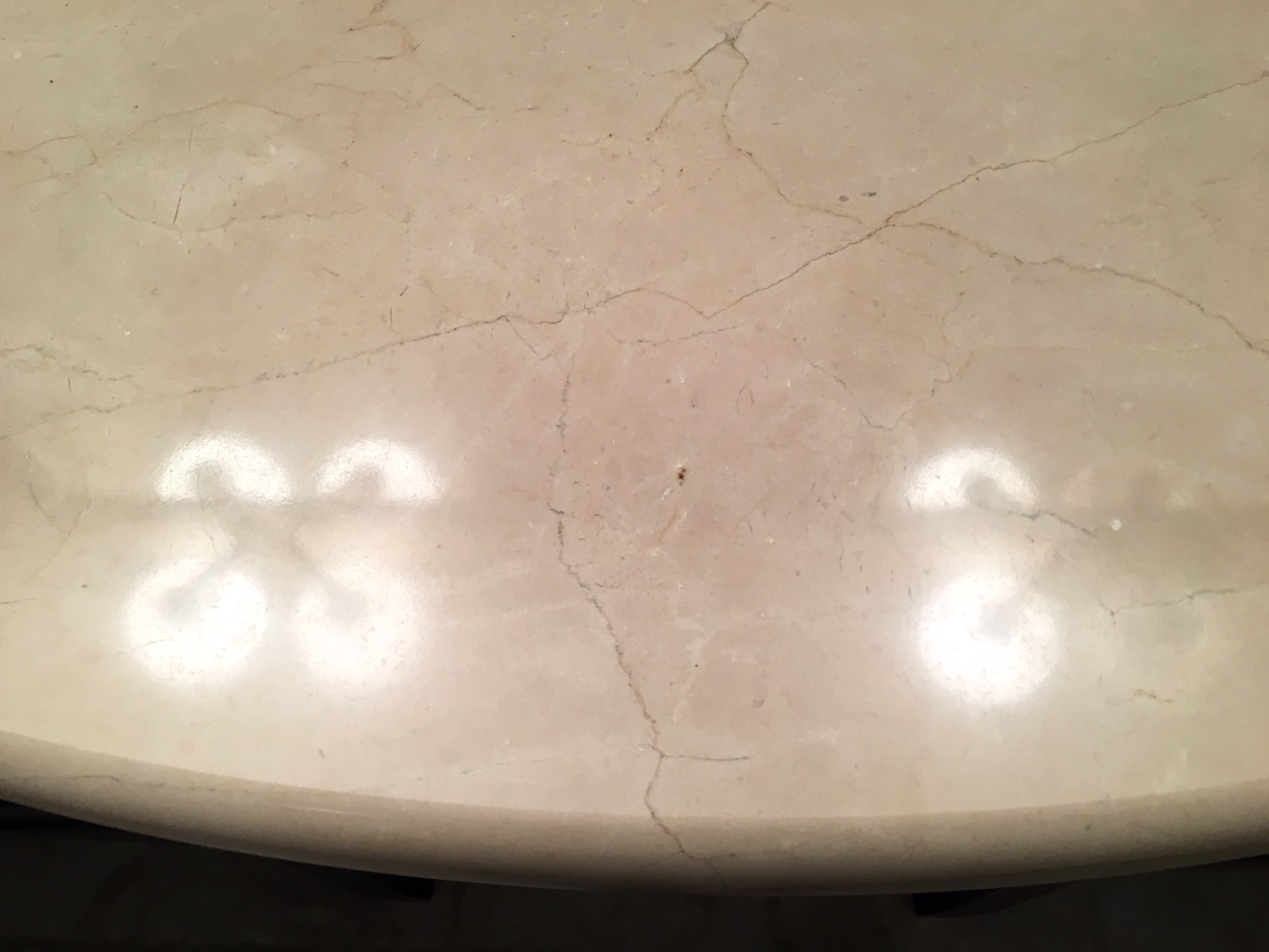

First stab at marble polishing
Donwand
Oct 17, 2009
271
Brian
Diamond impregnated pads
800
1500
3000
finished up with stone pro polish pro

Understanding it is your first stab....
Would recommend us resin diamonds and compound to polish.
You will get a much more clarity and depth of shine
Could be focus, but looks orange peeled...
and CM is about the easiest to polish marble out there

The after photo looks like you got the marble too hot by working it too long, creating an orange peel texture
