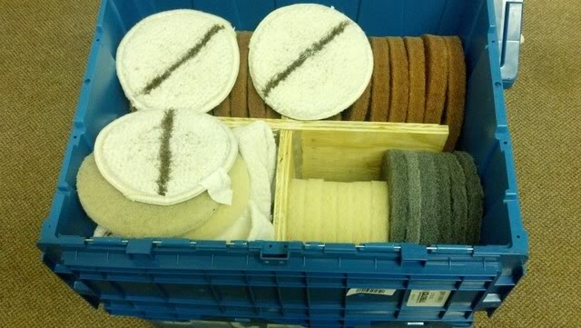

Great for commercial. The more soiled the better. I use a fiber pad to break it off and then follow with a bonnet. The accounts are always happy with the results. Many saying it's better than any HWE they had in the past.

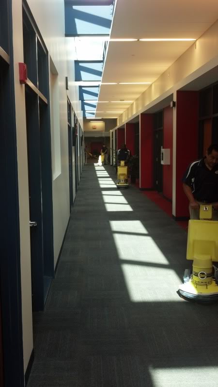

Simple answer, Greg? Encapping works as good (and many times better) than extraction on most commercial low pile glue down carpets. 2 to 3 times as fast, no running fuel cost, no security issues with open doors, low noise and fast drying. What's not to like?
The acknowledged king of wide open commercial spaces is the Cimex even though the different CRB machines are giving it a run for its money.

PS Jeff Cutshall posted a while back on how encapping has changed his life. His post contains a fairly technical explanation of how the process works. Jeff has 3 Cimexes (he used to have five but I believe he sold two of them off) and runs them 24-7 with different crews. He tells me he can go weeks without even turning his truck mount on.
I'm with Greg on this one, I know little.
What do you mean by "fiber pad"?
Do you have a link or a pic?

For general carpet cleaning of commercial properties, encap with the Cimex is KING.
Residential, go with the op, except for urine.
116,074
Take a Cimex or a bent ass Trinity with some Releasit or Snake Oil to one of your commercial jobs and you'll never want to HWE them again
Either will your clients.
