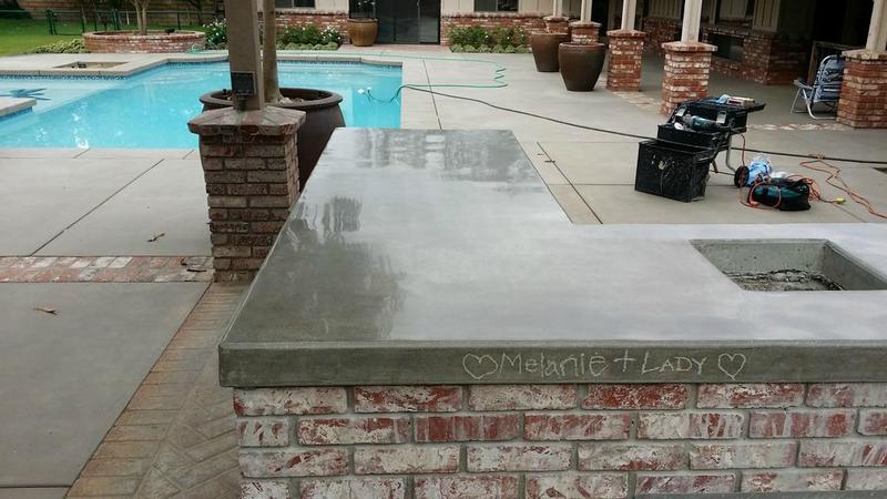

Use diamonds. We have some copper diamonds that you can follow up with resin that will make the concrete really nice.
This BBQ was over 20 years old, we did this in a day with just diamond pads.
