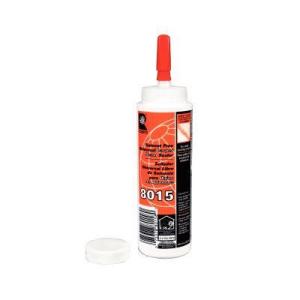

You could try this seam sealer for small areas.
ROBERTS Universal Carpet Seam Sealer, Solvent Free, Dries Clear, 8 oz. Bottle with Applicator Tip

8015 is just a latex for edge seaming before hot melt. 8415 is the seam sealing adhesvie and used for small areas as well but can still be a PIA. If you have large repairs, we used a good floor adhesvie like Welco 1070 or Roberts 3095 applied with an 1/8 grooved trowel and the 'honey(8415) on all the edges, The 8415 seals and welds the edges so don't apply any hot melt adhesive, or the seam weld adhesvie will not work properly. In most cases of fraying the mechanic did not use seam weld on his seams and just butted th edges after he spread his adhesive.
Other good tools: A row good row finder and cushion back cutter. A cookie cutter for small patches as you need, with some repairs, its handy to have some spray ahesive as well. We like Camie spray adhesive.
