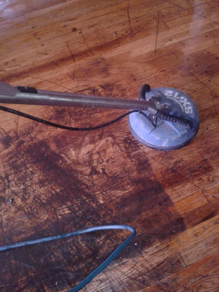

Now.........I would never clean a nice hardwood floor with the SX-12, but a landlord asked me today to try to get the "greasy path" from the kitchen throughout the living/dining area. It worked. Used "Grease Eraser". hot. sprayed and let dwell while we were cleaning the 2nd floor carpets. Set it at about 1200 psi, and it peeled that "chicken neck" grease right up!!
Anyone else try cleaning hardwood this way? I did warn him that there would be a slight possibility of some buckling, and he didn't give a crap....just try to clean it!!
By the way, no heaving or buckling occured.
And yes.....I wiped down the hoses after we got em outside.

Wow. Never would I ever think to do this. You're brave. I would have has him sign off on the warning/potential hazards first. We use dirt devil and basic coatings products up clean hardwood. But would not have attempted to use it based on the pic. Well done..I think.
