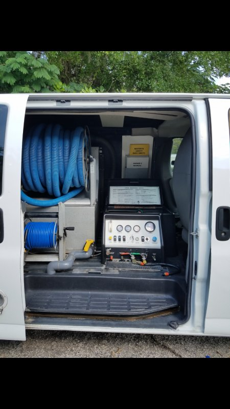

I got a Butler and the drain seems to be partly plugged. I have the 210 waste tank and it is a L shape and I can not see the drain from the top when I open it up. What is the best way to unclog it? I tried really filling the tank up a few times hoping that a few 100 gallons of water would force it out but no luck not sure how or what is plugging it up.
Any idea or advice?
Notice how the drain it curved or snaked; so stick something in the drain is not the best option either.

I would take that piping off. You really don't want it draining all over the place under the van. Replace it with a 2 inch vac hose. That way you can direct into a clean-out when dumping. Then you can run a snake or coat hanger into the plugged drain.

We've had this happen on our Butlers a few times. Easiest way to fix it for us was to turn unit on, put a towel or rag to plug up suction, immediately open the dump valve and let the suction clear out the debris that was in the way. But, now the clog is in the waste tank, yikes, so it may dump out or float around or replug the dump piping. You may have to do this again, LOL!

This is the quickest and best way to do it. It puts the suction on your waste tank in reverse when you use this process. It takes only a split second to open up the clog

I like this idea the best I will give it a try tomorrow and let you guys know.

Well I got it out it was a combo of lint, large lego and a toothpick flosser that was plugging it. I did the reverse vac with and had it suck up the water from a hose a few times then did a job and suck the fresh water tank half dry to flush it out good and it came out.
