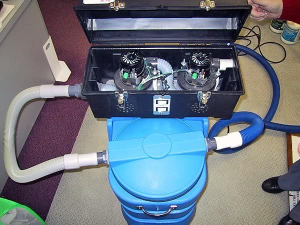

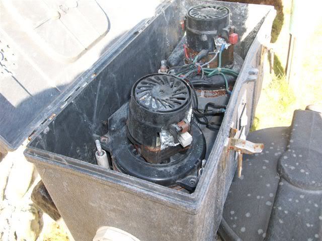

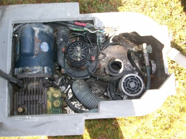

Here's where the ideas came from for the machine workings from my old fire burned Ninja. General pump, 4 two stage vacs. It rocked! And ran on 2 15 amp circuits, 3 with the booster
Motor cavity:
Twin 2 stage booster vacs
The way they hooked up:
