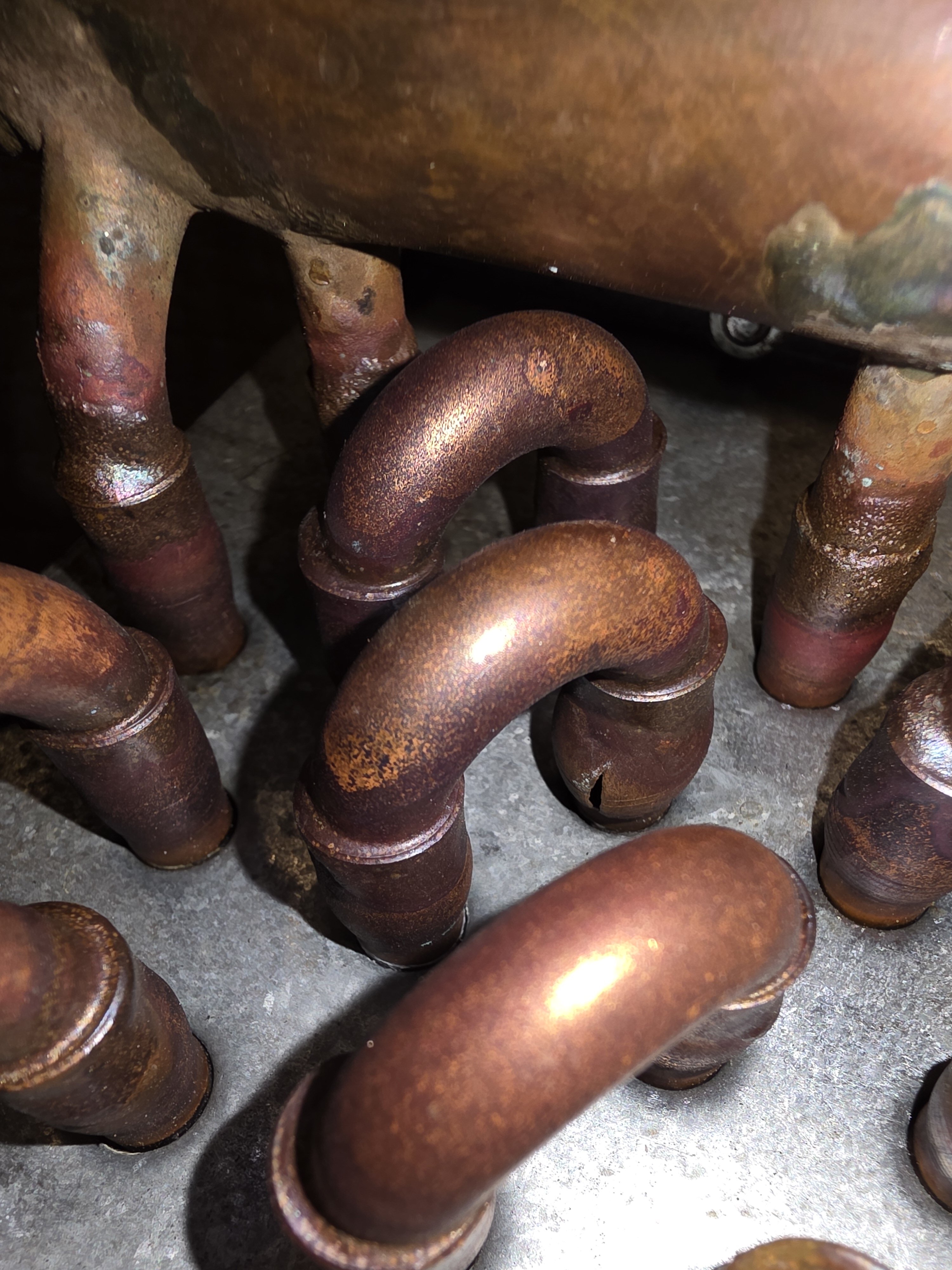

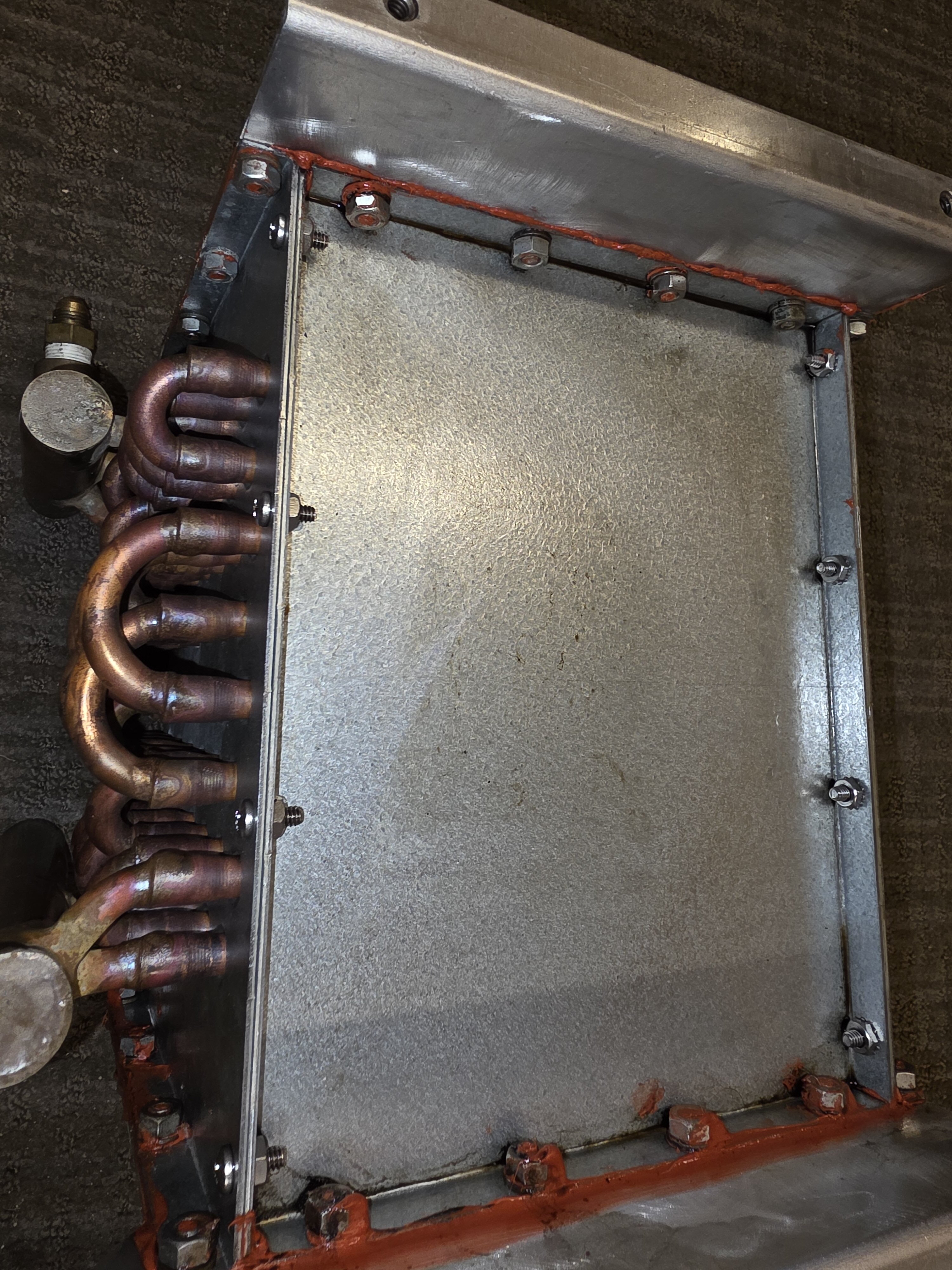

I recently purchased a used van and truckmount setup with a Boxxer 421. The previous owner apparently never winterized it, and it looks like a few elbows on the heat exchanger are burst.
I’m fairly confident I can repair the heat exchanger, but this will be my first time digging into a 421. I also own a 427, so I’m somewhat familiar with the Boxxer line, but the 421 is laid out a little differently.
From what I can see, it looks like the blower heat exchanger may need to be dropped out from the bottom. Is that the best way to remove it, or is there a better approach?
I’m also curious if there are any other known weak points on the 421 that are worth addressing while I’m in there, or any worthwhile upgrades people recommend.
If the heat exchanger ends up being a total loss, I may just convert it over to a Little Giant setup.
Any input on removal, repairs, common problem areas, or worthwhile upgrades would be greatly appreciated.
Yes indeed it comes out the bottom. It's not that complicated. You'll need new gaskets or your favorite gasket maker, maybe new bolts. Weak points on the 421? There are a few. The float in the reservoir is one. You may want to replace or rebuild the unloader while you've got the machine out. You're going to want to order new "plugs" for the blower coupler, make that two sets so you have a spare. If it still has the round wire lint basket in the recovery tank, you can cut a square hole and use the same basket as the 427 which is soooooo much better. Maybe a new voltage regulator since they're cheap.
Good luck with it, it's a great little machine. Oh, download the manual for it if you haven't already, it will make your life so much easier.
