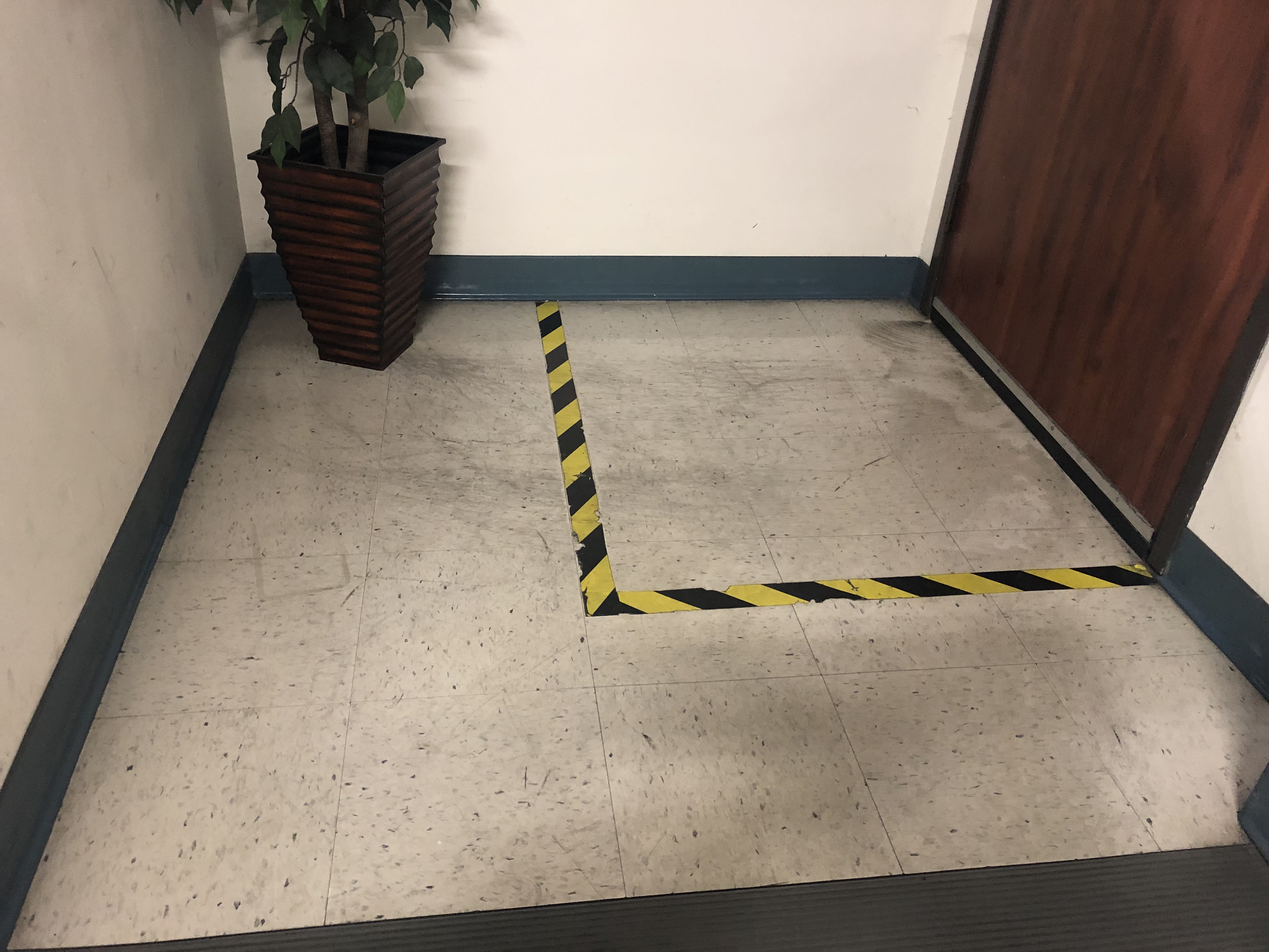

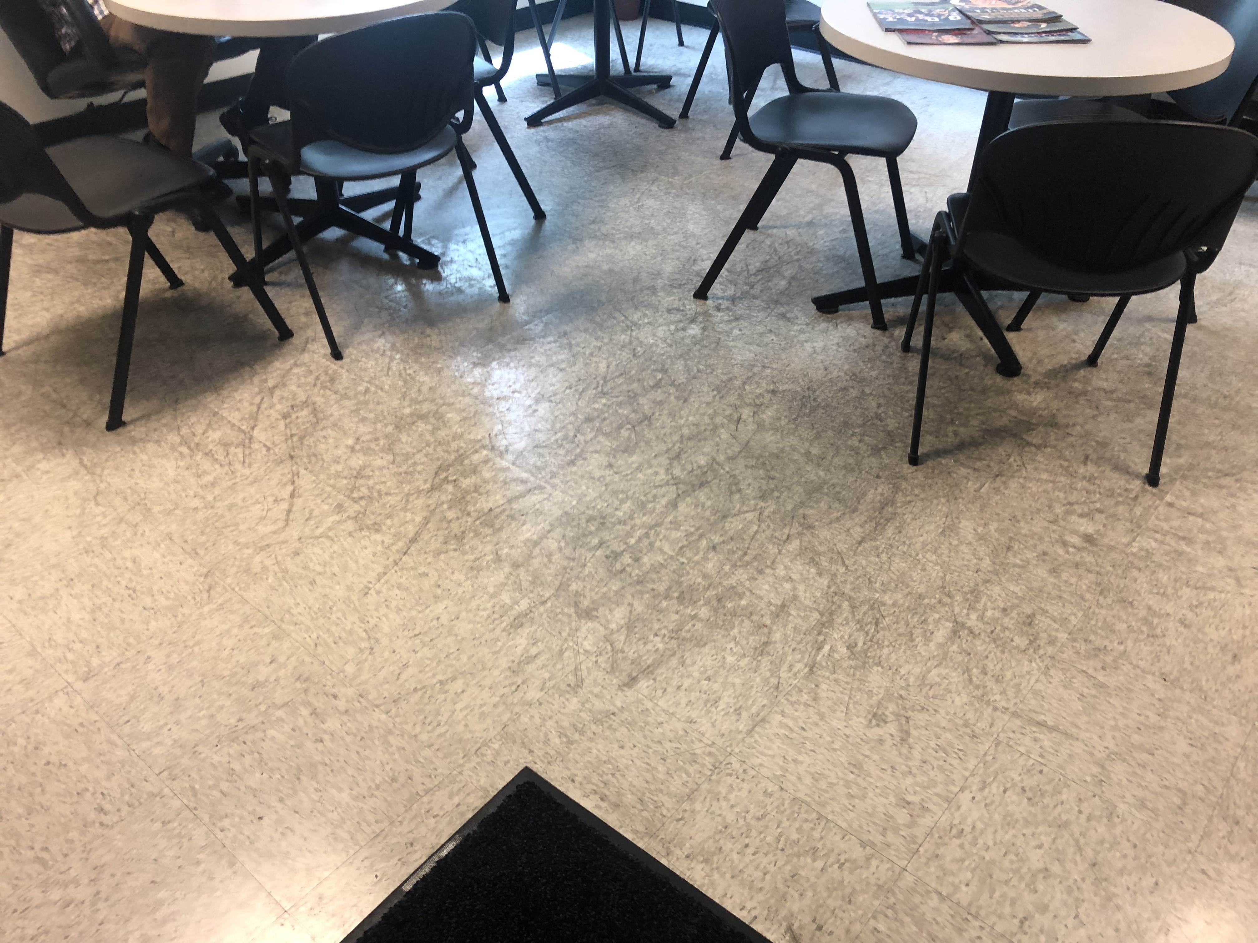

I have an account that I don’t want to loose so I said I could do the vct in the break room
I explained that it is damages and wouldn’t look great but it would look better they liked that and said we just want it to be cleaned whatever it is it’s fine
I’ve never done this before how would I do a simple and good job?

If you have 175 or OP get a 3m 5000 or equivalent pad
mop on a neutral emulsifier detergent
give it some dwell time then scrub with pad
extract and rinse slurry or mop it clean (clean water not detergent)
work in sections so it doesnt dry on ya

Use a 175 with a brown or black pad for stripping, wax stripper(follow directions), wet/dry vac, 2 mops (one for the stripper, one for rinsing). flood an area with stripper, let it dwell and keep it wet.
scrub with the 175 then suck it up with the wet dry vac. Flood with clean water and scrub it again and suck it up again. Then mop with a clean mop and clean water. Let dry then apply your finish (minimum 4 coats six if you have the time and they have the money)

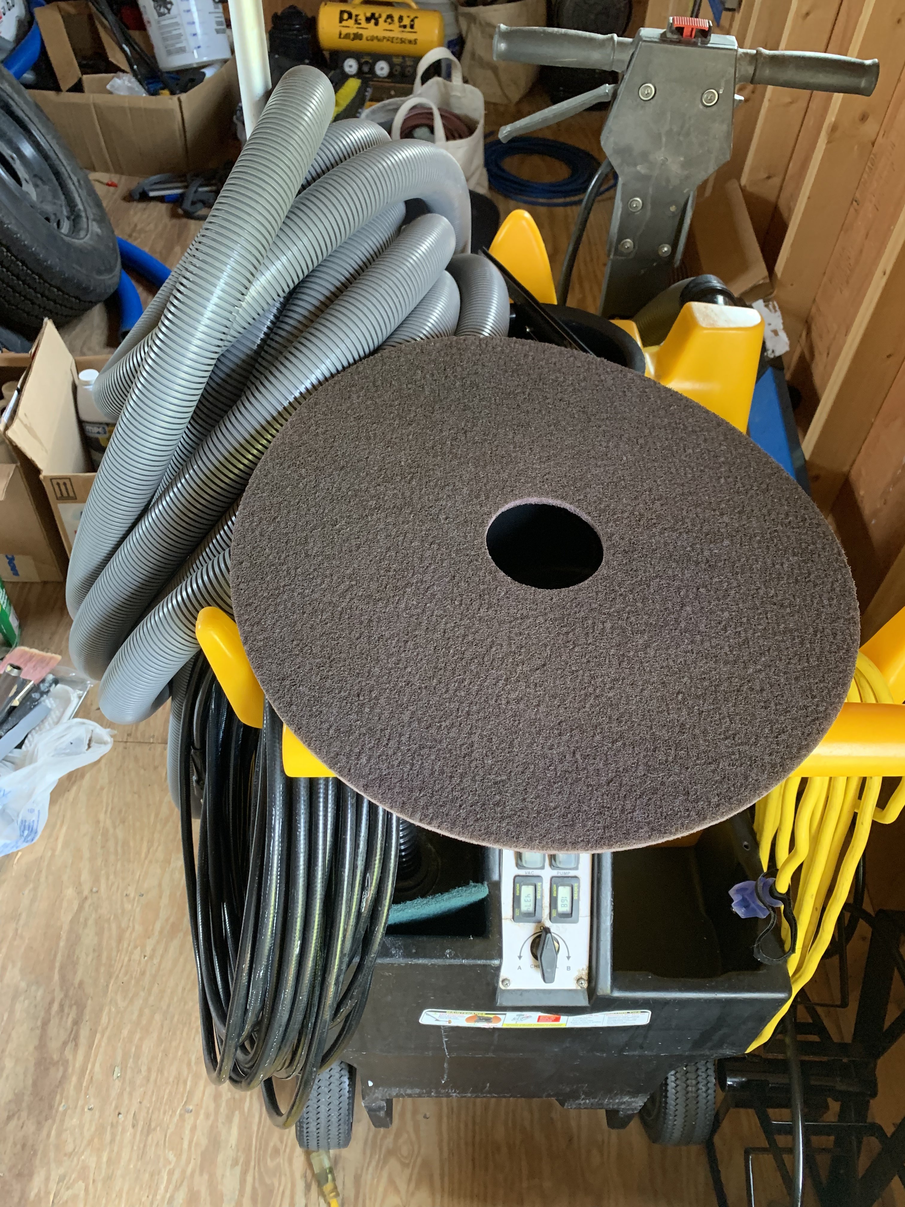

I do floors like that a lot. I only use water(no chemical), 175, and those prep pads. I use Kaivac machine to spray down the water then I scrub with the floor machine, rinse, and extract. That should leave a base coat of decent finish and then 1 or 2 coats should do it. The pads and finish I get from Jon Don.
