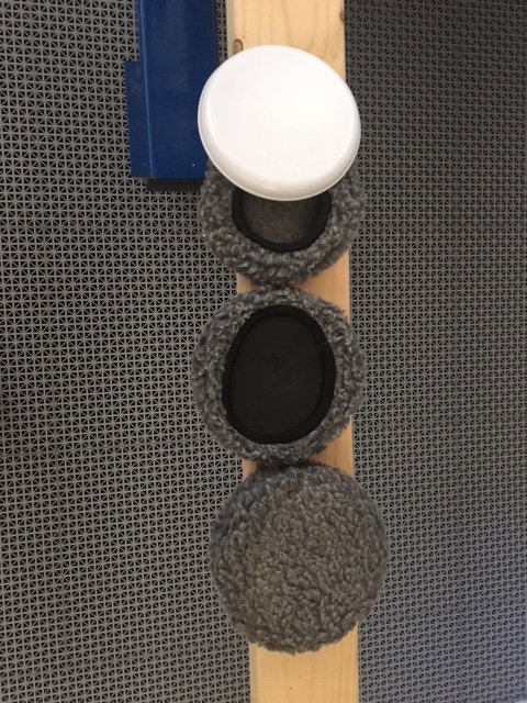

David Moynihan
With so many homes having wood flooring, every carpet cleaner should have these, or something similar, available.

David, I often leave my furniture sliders under the furniture. Oh, I charge for them, but it makes life a ton easier for elderly, women living alone and those who fret about dust bunnies.
A quick stop at Harbor Freight and the bags are full again.
