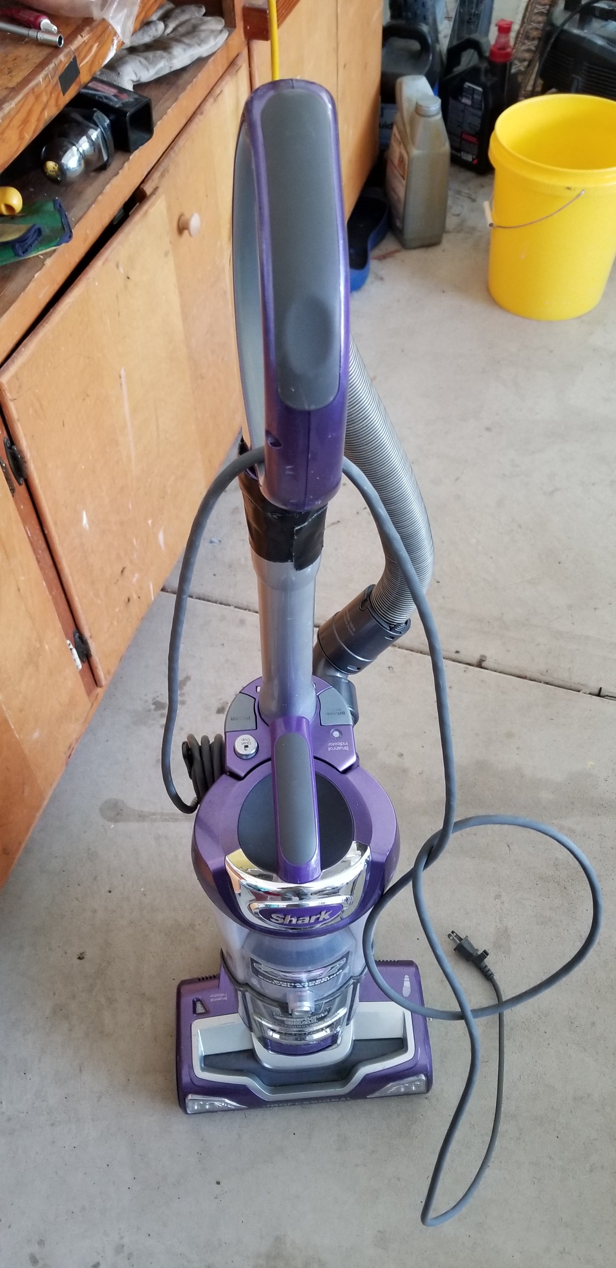

Brush roll wont spin
Totally unservicable....

Haha my shark brush roll wouldn't come on at this nasty last minute job. I had to beat on it and kept trying but eventually it worked. I think its a short in the connection when you push the handle down.
Don't throw it away yet mike. Beat on it real good for about ten minutes lol.
The light comes on but no power to the brush roll. A couple times it started and died and I could hear the motor lose power so I kept at it and eventually it worked right.
I might have to take it apart sometime and figure it out for a permanent fix.

1st make sure the problem isn't the operator. The switch is a 3 position switch. Make sure it in the correct position for vacuuming Carpet which will engage the brush. The other posiion is for suction only and keeps the Brush off. The 3rd posiion
Is off.
It might be serviceable if DIY project. It NOT worth fixing if you hire a repair shop.
The same thing happened to mine- so I fixed it.
I took it apart. Cleaned the lint wrappd around the brush INCLUDING the lint near the brush bearings. Greased the bearings. Also got to the control broad that controls the brush-- basically just unplugged and repluged the wires. Went to start the vacuum and the brush still didn't roll; so I bought another one. Next day my tech used the "broken" vacuum and, oddly, it worked.
Maybe I forgot it was a 3 position switch, or maybe the lint wrapped around the brush was causing strain on the motor and it would shut done.
