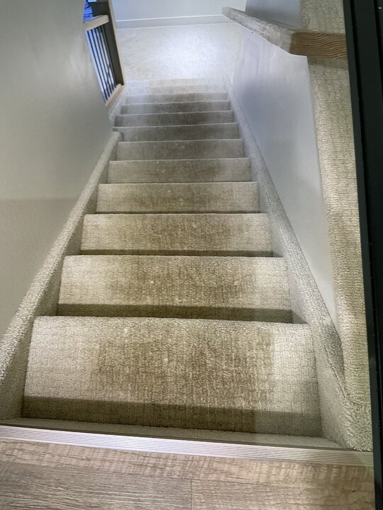

Good morning. I have a good customer who used adhesive backed plastic covering on his steps during construction. It was left on for about a year. He sent me this photo asking if I could remove the residue.
I am thinking to mist CitrusSolve, a wallpaper steamer to heat the affected areas really well and extract with my TM .
Have any of you ever ran into this type of problem? IMG_1710.jpegThanks for your input!

Your concept is good, let me add a bit from my experience:
1. Its the customer's problem, get paid no matter what happens.
2. Citrus solvents leave soil attracting residues of their own. Make sure you follow the mist (I noted you said "mist"....you don't want too much of that on there) with a heavy application of a high pH, solvent boosted prespray (the nuke of your choice). This type of product is the mostly likely emulsify the adhesive AND the citrus solvent.
3. Lots of heat in your rinse/extraction step. Heat melts glue, and also will thin out the oily solvent.
4. Help the customer to understand that you can't see or feel the adhesive, so while the dirt will come off easily, the adhesive is clear, and may reattract soil over time. This is not bad cleaning on your part. Get paid no matter what happens.
Did I mention to get paid no matter what happens?

Yes thanks Jim. I indicated upfront that I have a healthy minimum charge, and that I classify this type of work as experimental only at the customer’s choice to proceed.
I am working on another idea also, of how to approach this. I will be making an attempt this week and will update.

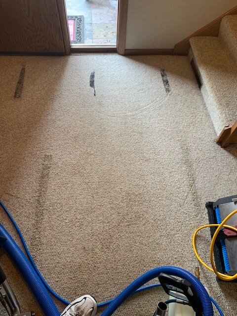

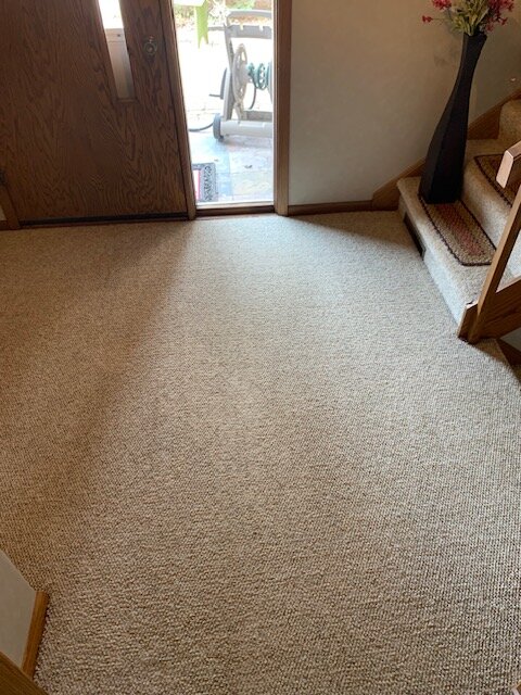

sassyotto
Jun 7, 2013
1,295
Paul
Paul,
Nice Job!!
What chemical?
What process?
this was the entry from the garage. I cleaned the rest of the carpet (including steps which were WET when I took the picture) and started to work on the two strips in front with DeSovAll and ran out. Went to Home Depot and got an adhesive remover for carpet and that worked pretty good. Between DeSovAll, Citrus Force (diluted) and Home Depot Product and a lot of time, got it all out.
Reactions: Kenny Hayes
frank fratto
Jan 27, 2018
410
frank fratto
I think it looks damn GOOD!!!
