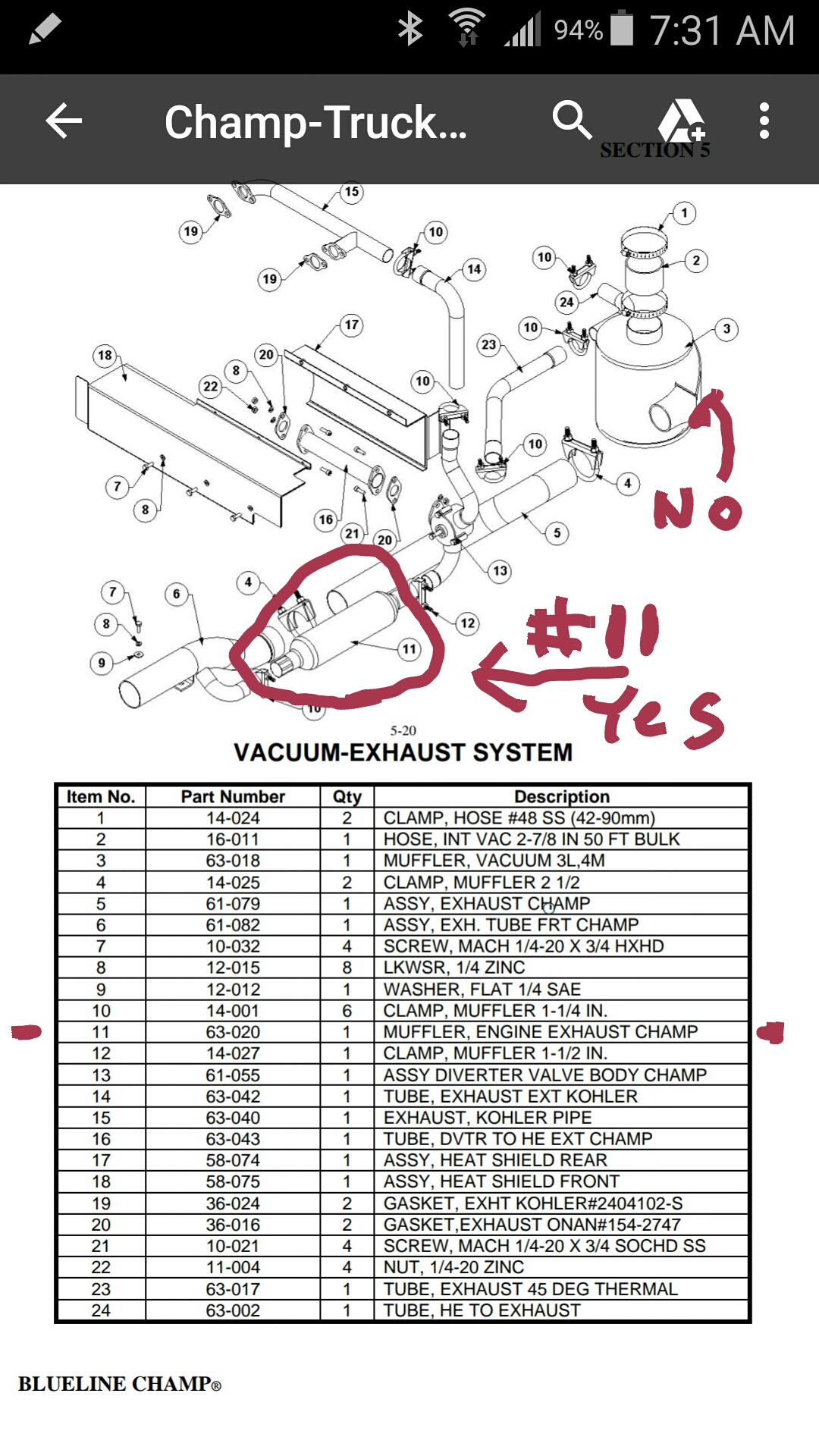

Does anyone have a new muffler. I have the schematic of the muffler I need. I do not need the blower silencer. Thank you.

I think an 1.5" automotive muffler crimped down to 1.25" at outlet would work.
Jim Martin can tell you what they did with the BlueLine parts.

You can still get a ton of parts for the blueline machines from sapphire....but something like that... I would take off and see if a auto parts place can match it...and if not..a muffler shop would be where I would go...
