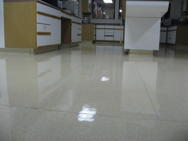

I'd sooner get kicked in the nuts than not use airmover to dry the finish. Of course, on the other hand, I've not been at this long, and our work sucks so..

Looks good, Fon.
